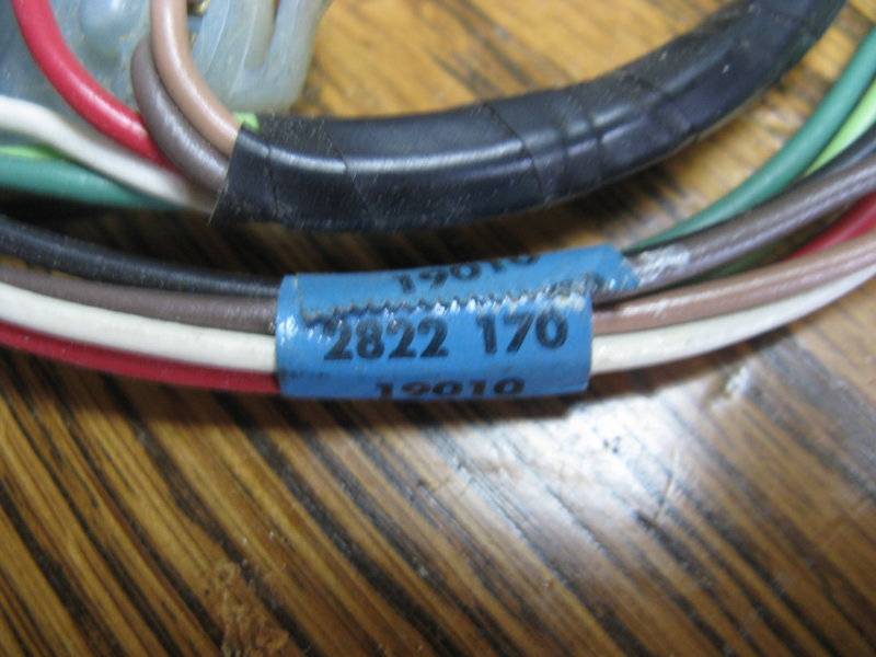

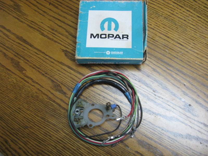

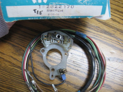

Use Nos only and never have to tear the column apart again. Used ones are brittle and after market ones are junk. I have one left that is heading to Carlisle $200 shipped and it will last your life time...
