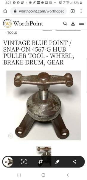

I will post a picture of what you need
This is what you need. When it lets loose it sounds like a gunshot.

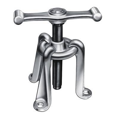

You may be able to pick up a used one cheaper from a member here.
Or:
https://www.summitracing.com/parts/...Hxx8MCdwXY_UNdfy6oG-1EukXnLlH-u4aAjIxEALw_wcB
Personally I would opt for one of the more heavy duty pullers instead of the one in the photo above. That is a newer version of the tool I have... and I may be incorrect but I think the original has a larger diameter threaded rod and is just more durable in general
The old blue point and snap on ones are really big tools in person... the threaded rod is about 1 inch thick or more... they are very high quality and make the job easy. You beat on the ends with a hammer until you hear the loud "pop" that is described above and then the hub will come right off.
They may look similar but note the giant mass in the center where the arms attach to body of the tool

@Evan Frucht the heavy puller that you posted is good if you can find one anymore. When you do find one they are way over priced mainly because of being a collector item. In my opinion they are cumbersome to handle. If the fine threads under the bell get messed up they are pretty much useless. The one I'm useing in my video and what @64BEL posted are just as strong and are easier to use. I've removed many a drum in my days :D

Good to know. I got lucky and found an old blue point with all the different arms and attachments in the original carrying case for relatively cheap at pawn shop. I never have seen one of the other ones in person but good to know they work just as good. I have only seen and tried to use another style of hub puller that I rented from autozone which was not heavy duty enough.
