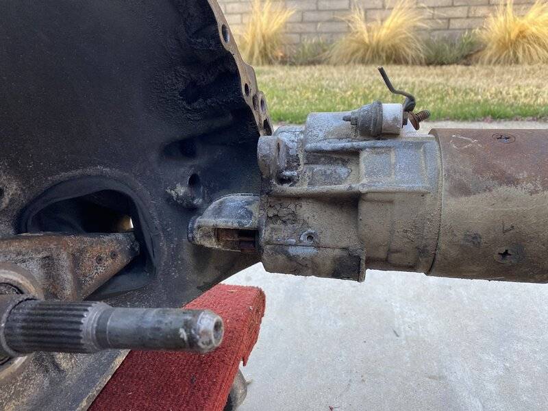

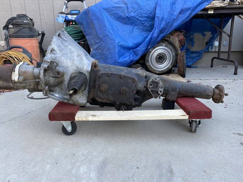

While the engine was being sourced, I continued to press on with the transmission.

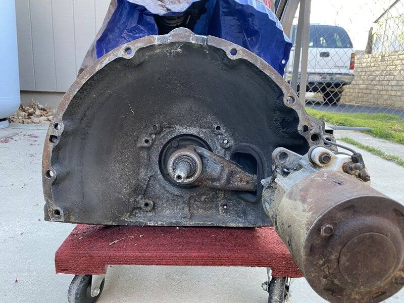

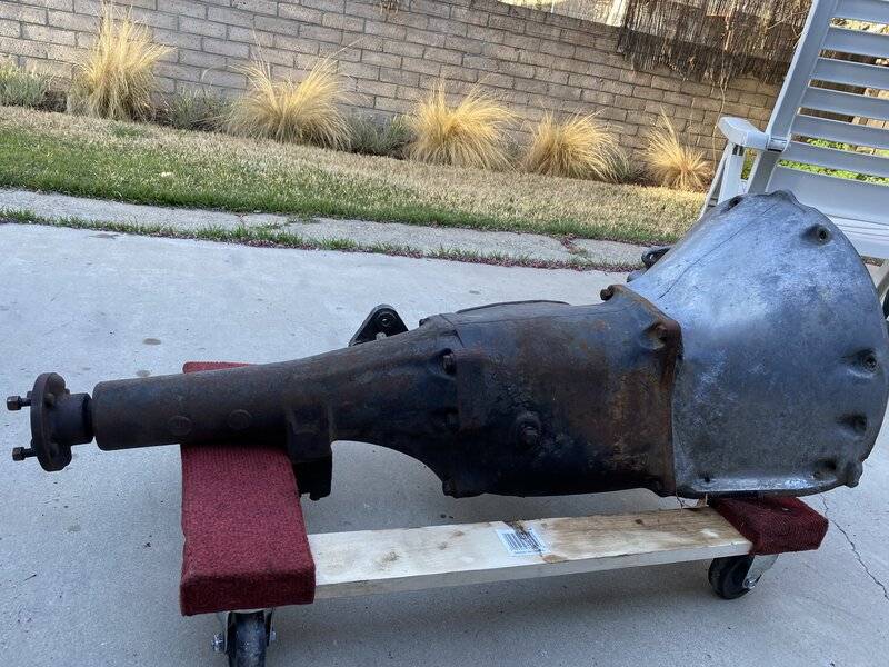

I knew I had an early A833 with an aluminum bell housing but that's about it. I read an article on hotrod.com that featured Passon Performance and made a phone call. I told the guy what I had and after sending a few pictures, it turned out I needed a lot.

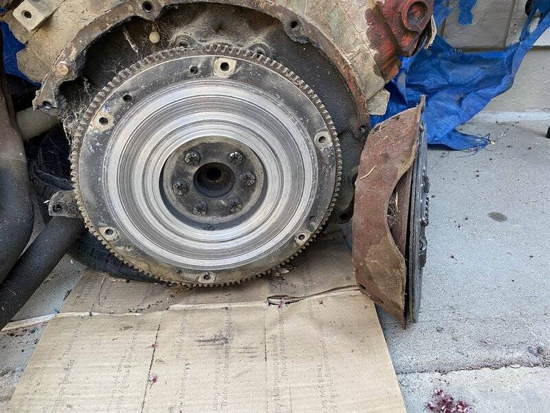

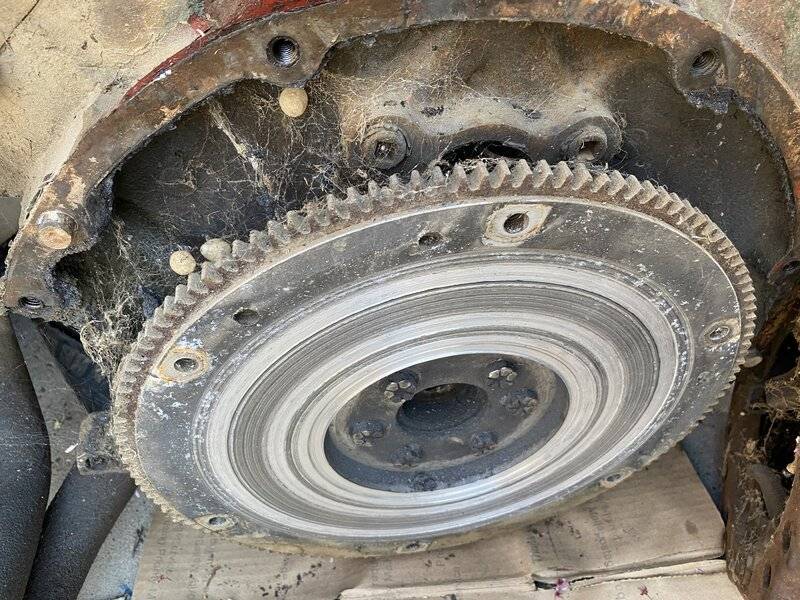

The clutch was shot, flywheel was mangled, and I didn't even have a shifter.
I ordered a whole bunch of parts including a rebuild kit.
Oct 2021
Took the transmission over to Anaheim Gear, no transmission guys in Bishop, and I got a call on Wednesday that the rebuild was complete! I can't wait to see it! They also put synchro gears in it.
Here are some pics of the original hardware.
IMG_9256.JPG IMG_9257.JPG IMG_9258.JPG IMG_9259.JPG IMG_9261.JPG IMG_9262.JPG View attachment 1180859

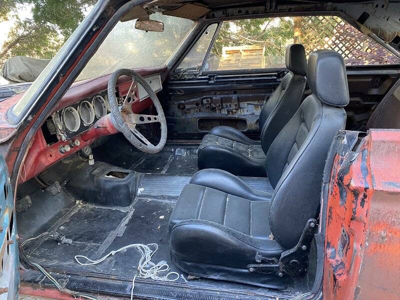

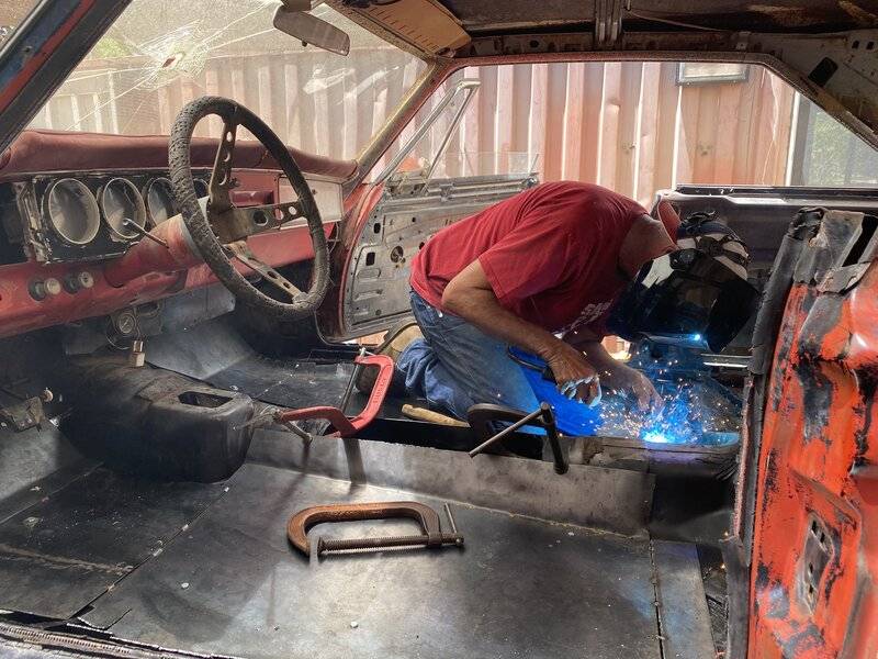

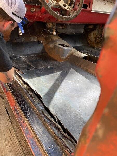

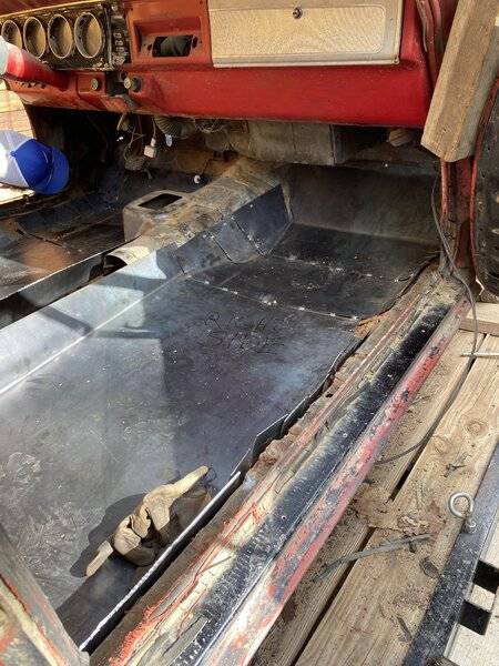

While the engine and trans are important to getting the Fury started, getting a floor in the car was paramount. I figured that once I got a floor in the car my friends and family would take the project seriously. It sure beats the heck out of Fred Flintstoning around town.
At the time I was unaware of any floor patch panels or full floors available so my welder and I decided to use 18 gauge steel to make out floor. We elected to do it in 3 sections: driver's side, passenger' side, and transmission hump. This part was tough!!
Getting familiar with the welder, plasma cutter, machine screws, beers, and angle irons we got the job done! Major success!

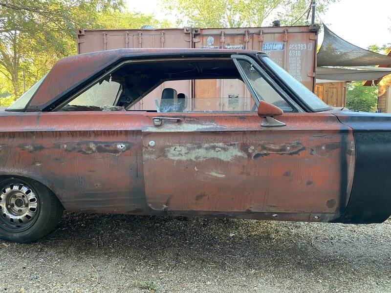

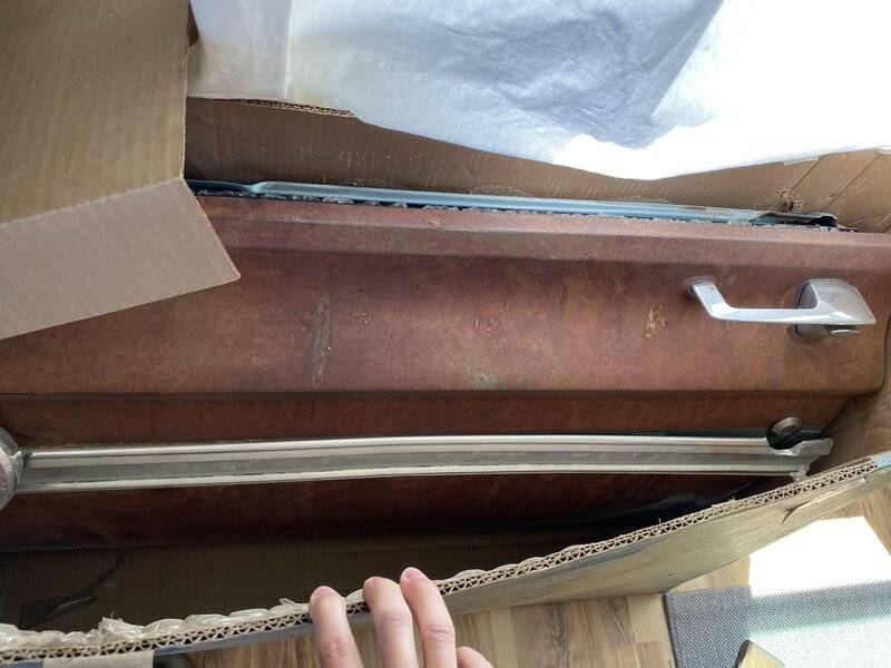

Finding a driver's door was one of the bigger challenges for this project (so far). I scoured eBay, Google, and junkyards throughout California and Arizona but to no avail. I was referred by Turner's in Fresno, CA to L&L Classics, ID.
They did have a door available! The door was pricier than I anticipated but I looked for a door since I first bought the Fury so I bit the bullet.

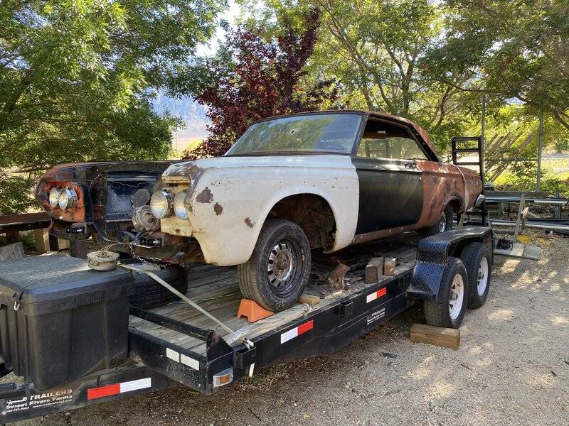

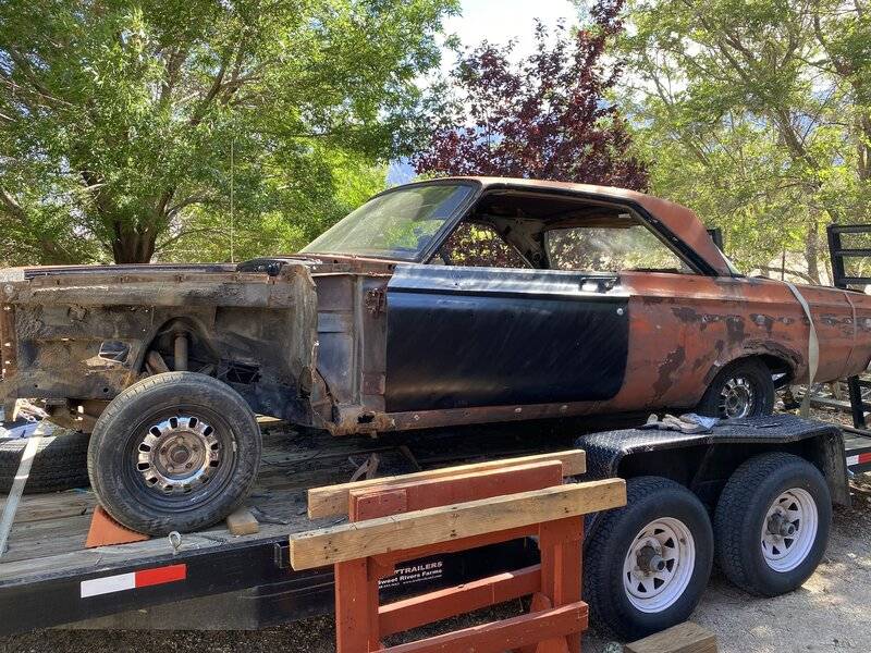

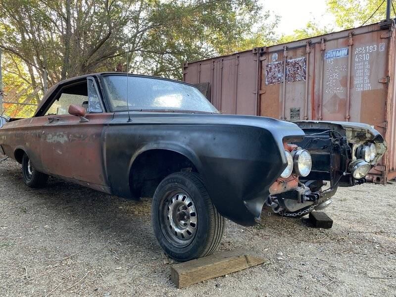

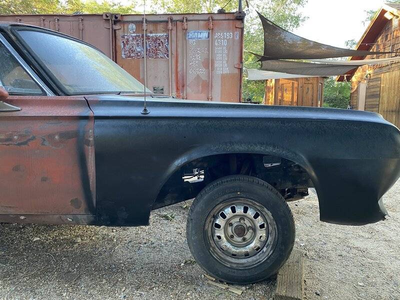

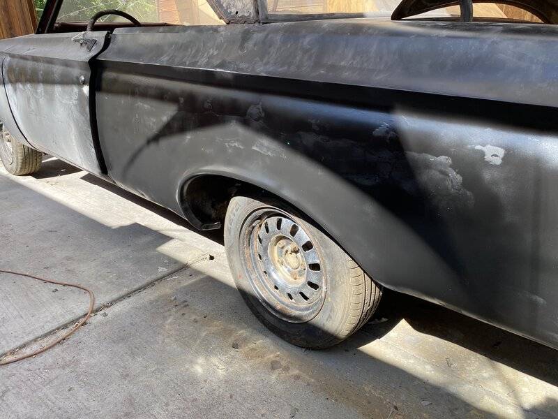

Now that the floor was in it was time to work on the rest of the body. I purchased the Eastwood Contour SCT to help strip the body and paint. I wanted to take the car down to bare metal so I could see all the blemishes from bondo to body rot.
I used the SCT Contour on my new door and it worked great. Once I got it sanded, I sprayed some semi gloss black rustoleum to seal the bare metal. Once the paint dried, I threw the door on the car.

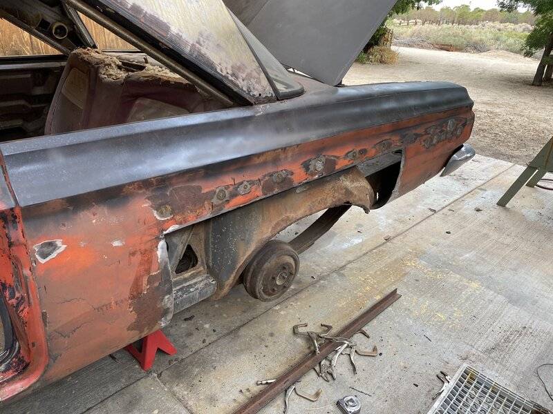

Two of the biggest problem areas was the driver's side fender and driver's side quarter panel. Both had extensive rust damage. I decided to purchase a new fender and buy a quarter panel patch.

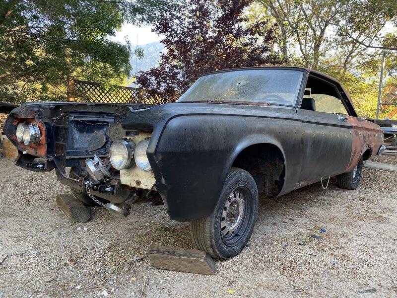

Finding the fender was easy, I found a guy selling a '64 Belvedere fender in Fresno, CA. It was a helluva drive but driving to and from was a lot cheaper than shipping costs.

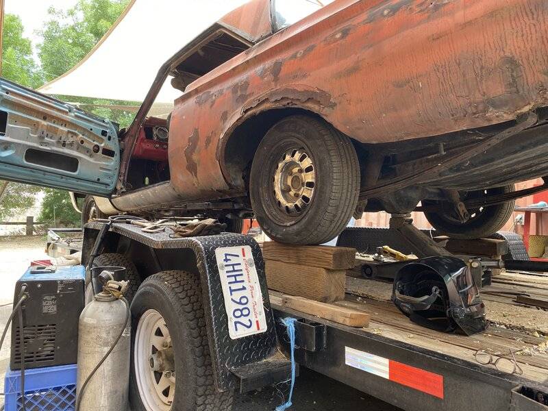

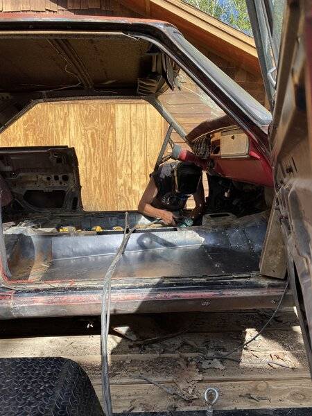

May 2021

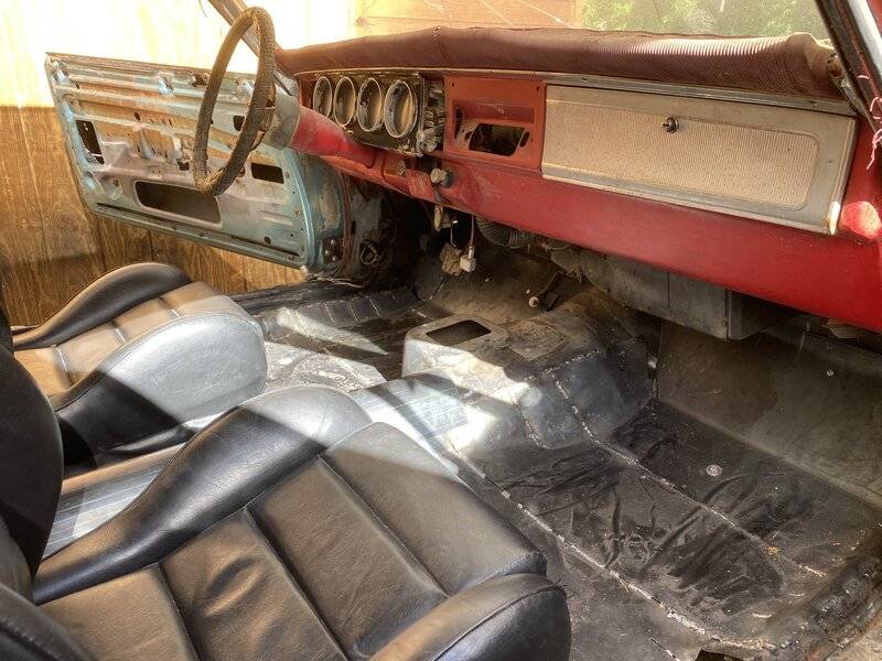

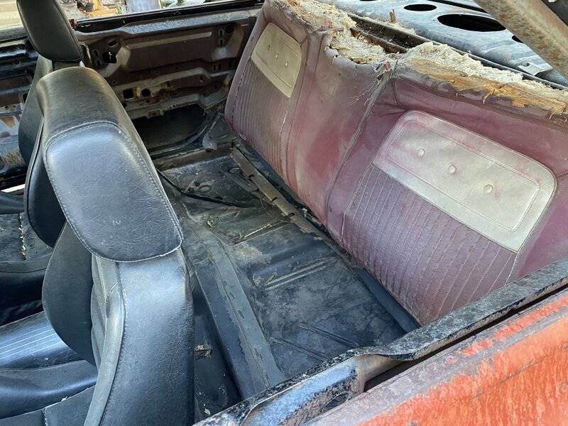

Time to weld the floors in place!

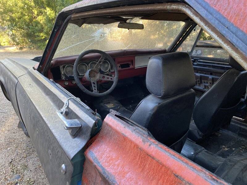

I also had some black seats in my inventory and I threw in them in the car just to see how they would look. They look great but they are small! The only person who fits in them was my 8 yr old. Anybody have a good suggestion on seats? I'm not going for originality so the sky's limit.

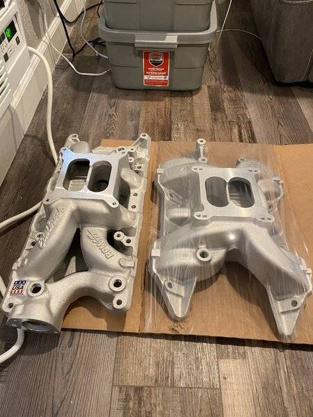

It was time to figure to out the engine build. I was told by a Mopar expert that the 383 loves a 10:! compression ratio. I based the performance solution of his recommendations.
One alteration I made to the original plan was an EFI system. I make drives from Bishop (4000ft) to Orange County (Sea level) to Mammoth Lakes (8000ft) often and I decided that I wanted the Fury to run strong no matter what. Shout to @threewood and @Dennis H for sharing their EFI stories and insights.
Here's what I got so far:
Holley Sniper EFI
Edelbrock Performer RPM intake
516 heads with hardened valve seats and enlarged 2.08 inch intake/2.08in exhaust
Mopar Performance Purple Camshaft Kit: Cam and Lifters, Hydraulic Flat Tappet, Advertised Duration 292/292, Lift .509/.509,
Keith Black 0.030 over pistons
ARP bolts for connecting rods
ARP bolts for cylinder heads
New timing chain
New dampener
At this moment, I still need to figure out: rocker arm assembly, push rods, water pump, oiling system, exhaust. I'm sure there's more I'm forgetting.
How does that look so far? Any suggestions?
Edit: I took that photo to show my friends the difference between RPM air gap small block Ford vs Performer RPM Chrysler "B" big block

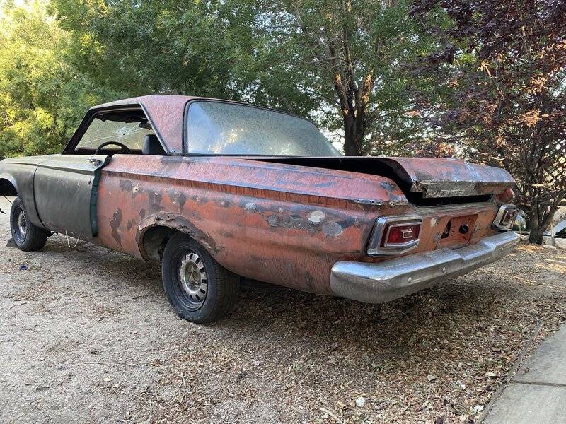

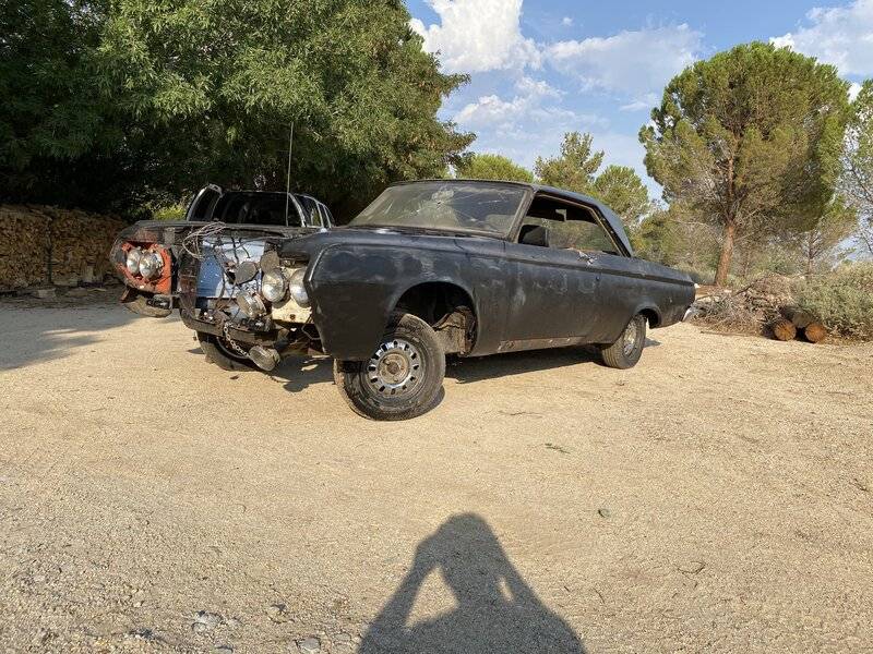

Photos of the Fury as of jul 2021
IMG_9545.JPG IMG_9546.JPG IMG_9547.JPG IMG_9548.JPG IMG_9549.JPG IMG_9550.JPG IMG_9551.JPG IMG_9552.JPG IMG_9553.JPG IMG_9555.JPG
Can anyone identify the type of mirror on the passenger's side door? My guess is Challenger but I could be wrong

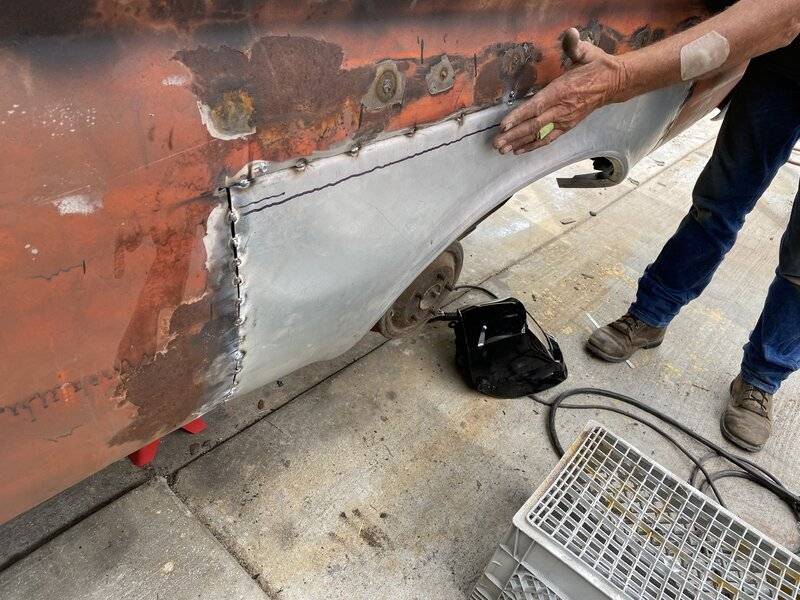

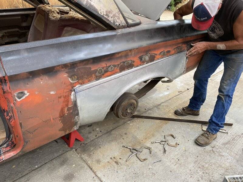

I mentioned previously that I was on the hunt for a driver's side fender and quarter panel patch. I was able to find a fender no problem but the quarter panel patch was another story.
I looked through internet and all I could find was 64-65 Dodge patch panels. I though they looked the same but other Mopar folk told me that there is a subtle difference between the two. After extensive looking, I got in contact with Kramer Auto and they had one.
Getting it in the mail was one thing but installing it was something else.
We got really lucky cutting out the old sheet and mocking up the new patch panel. I think it turned out great!

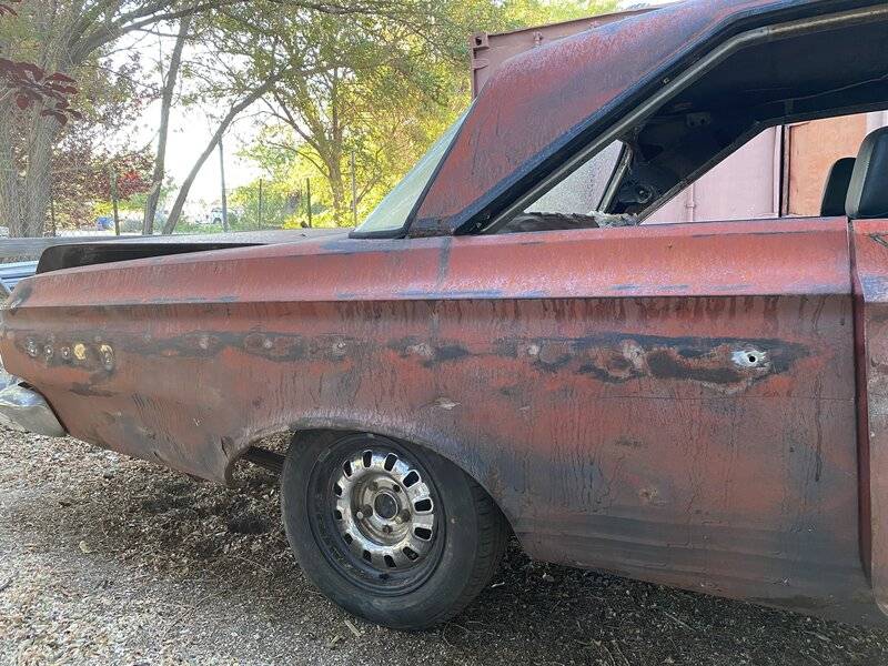

Aug 2021
No one told me that body work would take so much time and energy! I do firmly believe that the professional body shops earn every penny.

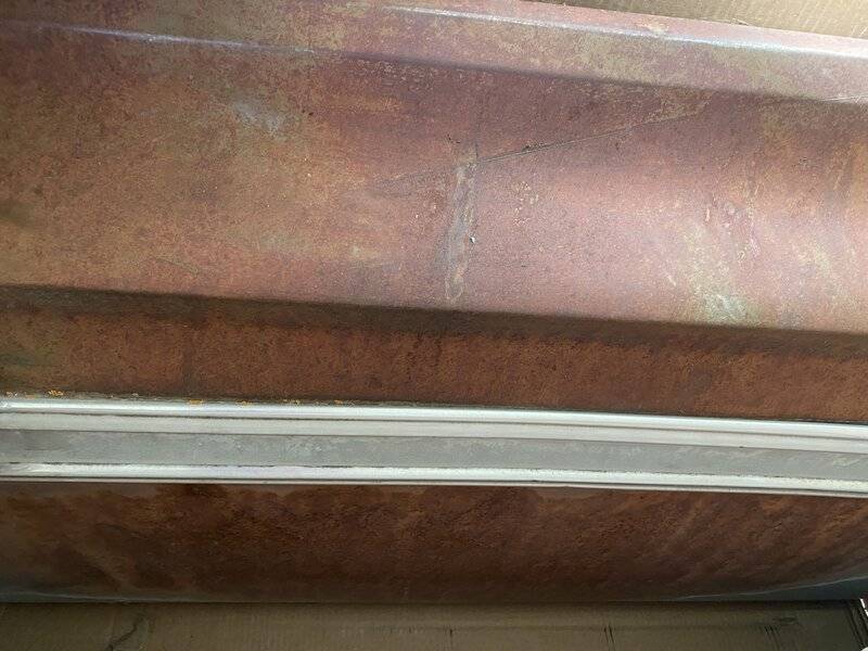

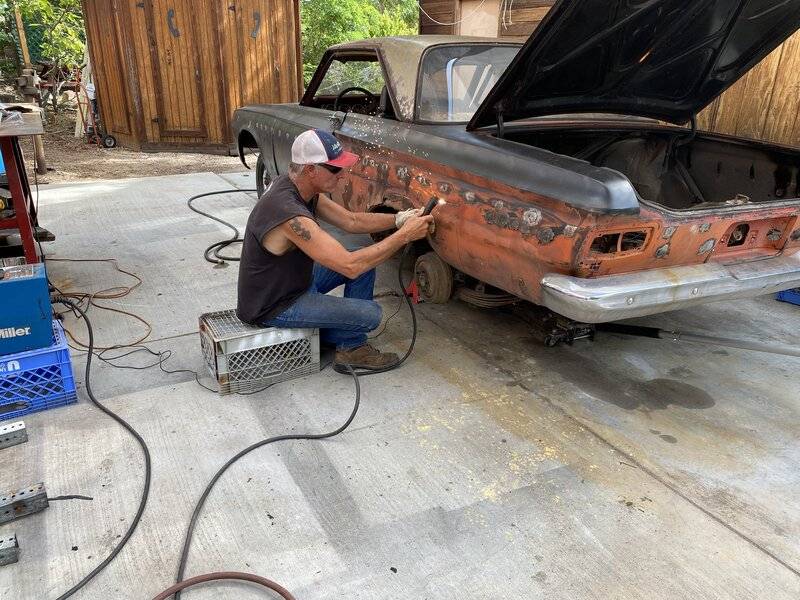

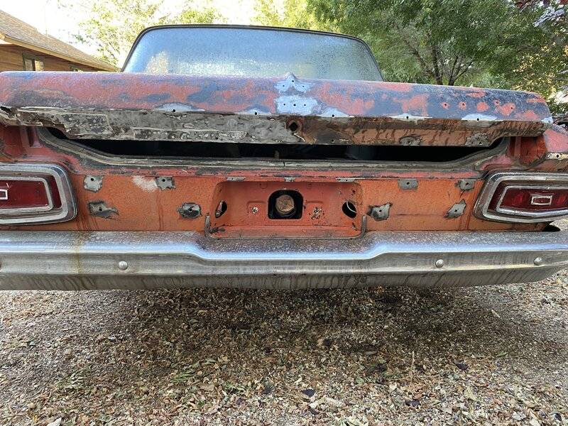

I really wanted the Fury to have a clean look so I elected to remove all trim from the trunk, quarter panels, doors, and fenders. In some previous photos, some of the trim holes have been sanded and/or filled in.
I got to practice some welding by filling in some of the holes. The problem with plugging all the holes is the grinding, sanding, and body filler. Repeat process x3 (at least).
It's a pain but I'm really happy with the look.

One more thing my welder friend and I experimented with is a two tone idea. We both noticed that the roof area was remarkably clean from any damage or rust. We sanded down the roof and sprayed it with clear coat. The silver roof and black body looked cool but i am going to go with one tone.

While you’ve got your welder out, one thing I’d suggest is adding subframe connectors. Your new floor has none of the original stiffening ribs, and running a four speed I think it would be a good idea. On a unibody, the floor is a major part of the structure.
What he said on the above. Also once you get your seat location nailed down, you'll need some reinforcement plates under the floor for backup on the seat mounting. Since the panels are flat, you might consider a tubing frame under the floor that attaches to the frame connectors for the seats to mount to. Thats what I'm going to do on mine.
Hopefully you aren't planning on doing bodywork and painting this. Rustoleum is not a substrate you can paint over with conventional epoxy. It is a bad idea to use on any external surface unless it is the final topcoat.
Also what he said. The Rustoleum may be ok for temporary but remove it when you get to actual paint time. It may give you issues with whatever brand you use for the real deal. Get some good stuff from PPG, Glasurit, Martin Señor etc for all. Primer is porous and not to be used to protect, it must be topcoat. Gun paints are also much higher quality products than spray cans. The primers adhere much better over prepped, clean metal than zip cans. Save the zip cans for smaller stuff that are out of the elements but Rustoleum is great for that stuff. Way better than Krylon and others.
I forgot to mention this in my earlier posts. We did subframe connectors. I knew I was changing the structural integrity and I saw from other posts that it was a good idea.
That's something I had not considered. That's a great idea!
I used the Rustoleum as a paint to cover the bare metal. My plan was to sand it down a bit before applying a primer and real paint. Is that still a good plan?
