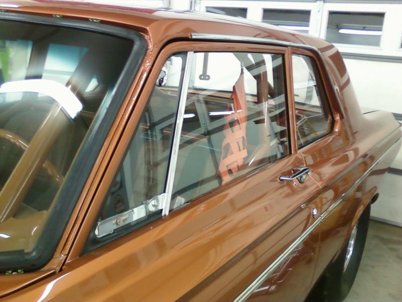

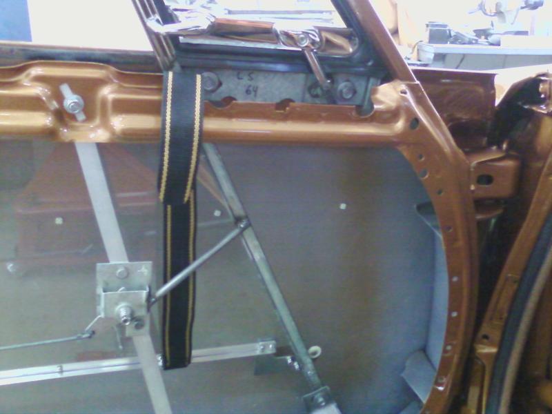

Also take all the window regulators out and replace the glass with lexan! that'll drop about 140#s! You can leave the drs. regulator if you want the window to work. I've got my 65 Belvd. drown to 2980#s

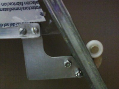

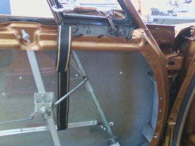

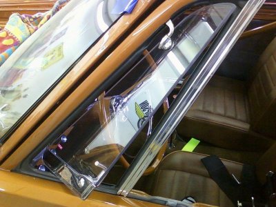

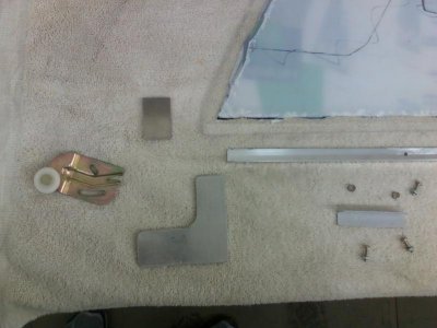

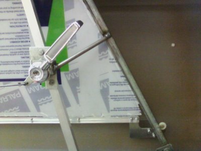

Mine still has the stock windshield,(31lbs). I replaced all the rest with 1/8" lexan. Battery straps move the windows, no regulators. Even the vents are 1/4" lexan. I weighed all the old and new components. 84 lbs saved. Stock rear deck lid weighs 58 lbs.

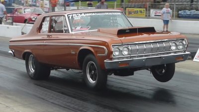

Thanks, 3120 w/o me. With me and fuel of fuel 3340. I could get it lighter. It has 2 battery's,fire system, dual production fans, all steel including bumpers except hood, old school wheels. Ran 9.27@146.6 last weekend.
