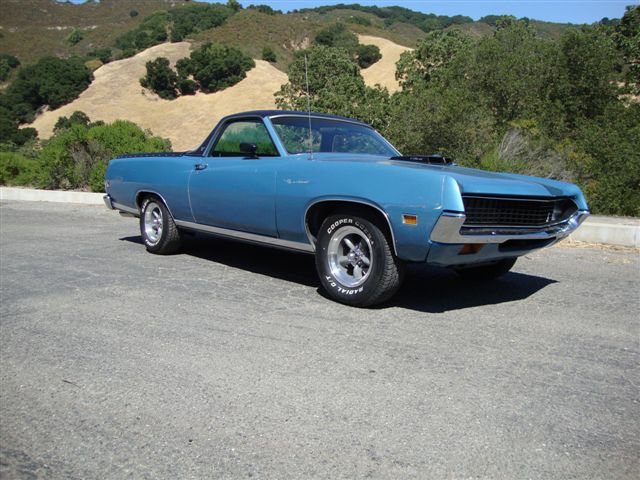

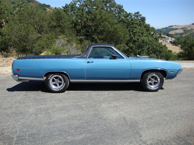

Just to mix it up a bit here's a pic of the MoPar parts and dirt bike hauler. 71 351C 4V car with A/C.
Nice Non-Mopar 71 Ranchero there Meep-Meep!! Got to love that A/C here in Cali. :cold:
