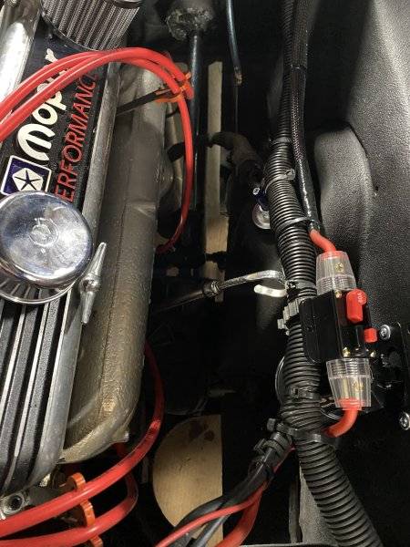

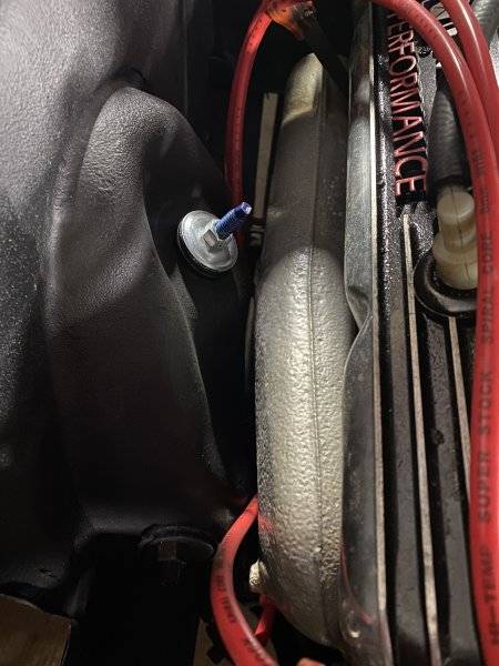

Secondly he wants headers. A 440 resides under the hood ( originally a 383) This engine sits noticeably over to the passenger side ,the exhaust manifold almost touches the shock tower. Drivers side has much more room. Is something wrong here with engine mount brackets or is this normal for a 65?

As far as headers go, if the engine is already out of the car, you drop the headers down into the engine bay, and then drop the engine in between them.
The heavier than normal offset to the P.S. may be more so on a 65' than other years. I noticed on my neighbors 65' Coronett that you could barely get a credit card between the TTI header and the shock tower on the P.S
