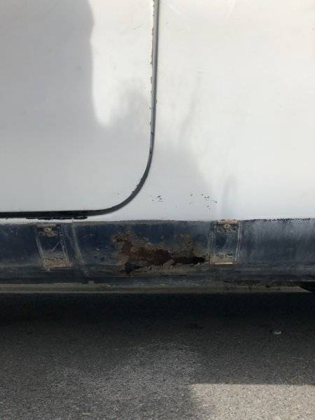

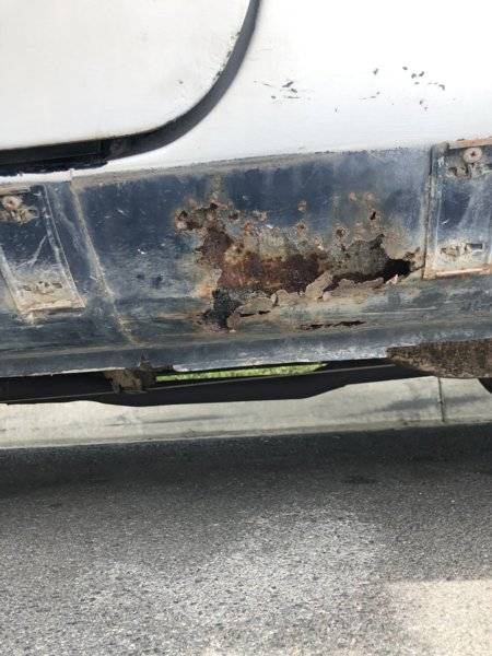

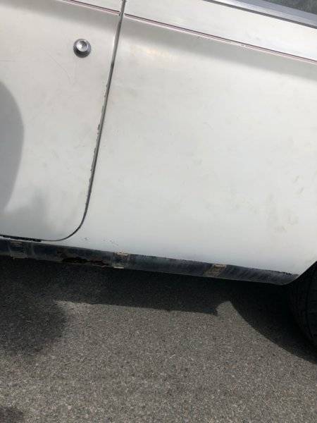

Hello All.
Gonna start the task of fixing all the rust on my '65 Satellite. Got rust in Firewall, Cowl, under the Rear Quarters, and the rocker panels. Those are all the spots that I know of so far. Going to start in on the Driver side rocker first. Just wanted to see if y'all got any tips or tricks for me here. Going to be MIG welding with a Lincoln 210 MP. I actually work at Airgas, so I know my way around welding (as much as I need to for this project anyway). Again, just wanted some tips and tricks from anyone who's done this before. Anything I should look out for? Is it as simple as cutting out the rot and welding in my new sheet metal? Anything I should do while I'm in there?
Thanks again guys.

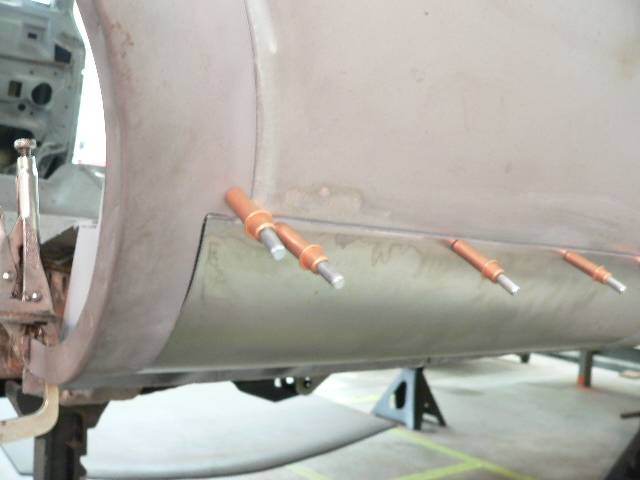

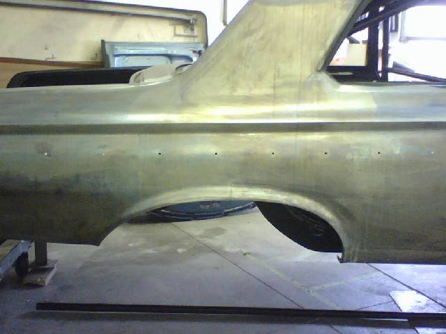

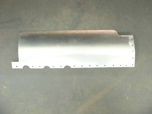

That is actually part of the 1/4 panel. I made my own sections. Rolled the sheet metal around a 10" piece of PVC pipe. Copy the outline on the bottom where it spot welds to the inner rocker. Then weld it in.
Doug
Looks gorgeous Doug! Thanks for the tips and pics!!! It's all 18 gauge, right? How's your cowl and firewall?

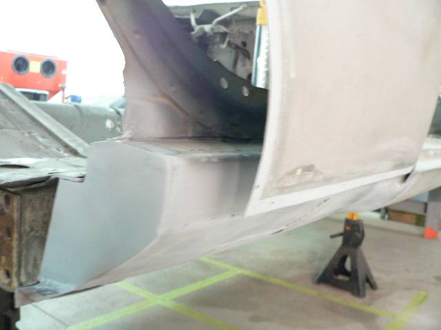

Cut the left upper cowl off. Fabbed a new lower. Reinstalled the old upper.
We swapped an entire cowl with a rust free part on my buddys 64. With the windshield, fenders, hood, and motor out it was pretty easy.
