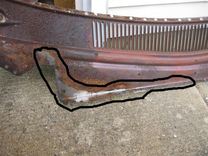

Thanks for the input so far. I'm not sure I described this correctly because I don't think this is an area for a normal seam sealer material. I've attached a picture of the underside of the upper cowl that I removed. I have circled the area where there is clean metal, where I removed the sealant material that I'm talking about. This material was between the spot welds where the upper cowl rests on the lower cowl/firewall area, so it must have been applied before the spot welding process at the factory. I assume this was used to seal out water - to prevent it from working it's way into the space between the upper and lower cowls.
Any suggestions on what material this is? In order to withstand the high temps of welding, it would have to be a high temp material that does not burn.
It would also need to flow freely so it would compress and allow the two surfaces to come together for welding.
That's what I thought you were referring to and how I said I did it is what I did. When I tore mine off it looked like a foam sealer between the seam, the best I could come up with was just seam sealing the inside and outside and use weld threw primer on the mating surfaces. If you figure out a better way I'm all ears, good luck.
