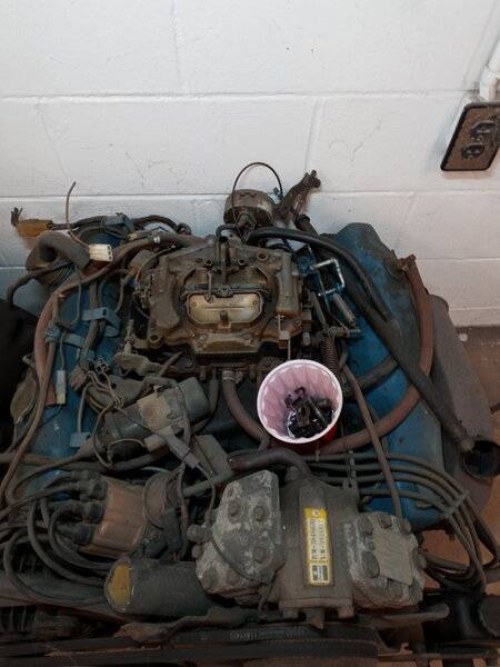

I have a bone stock low mile 77 400 TQ4bbl motor from a New Yorker I plan on putting in for just a cruiser. Simple Eddy intake, hedders and carb. I was looking at the Eddy AVS carbs but not sure which would be right between the 650 or the 800. Still looking up the thermoquad as of now so cfm is unknown at this point.

Based on your description, I'd say 650 for sure. When you get up around 400 horse, I'd change my answer....
I don't know for sure, and 650 cfm is plenty, but I bet you've got the bigger thermoquad on that motor

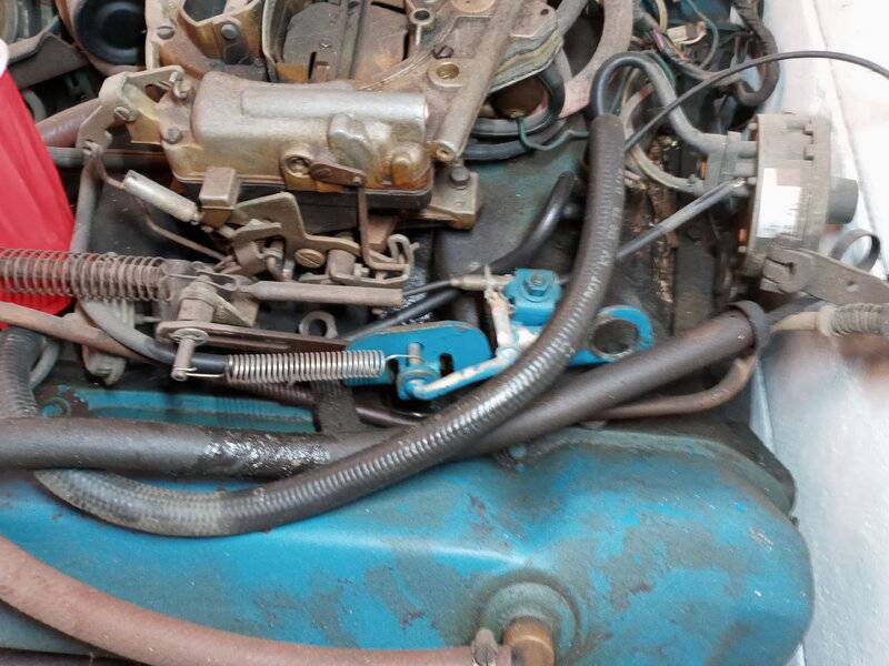

Don't use that later lean burn thermoquad. Stick with the 650 avs.
Stick with Thermoquad, Just find an earlier pre lean burn one. It will outperform any Edelbrock!

You DEFINITELY don't want to have the TQ setup for lean burn. I didn't think of that. Maybe rejetting would resolve that?
