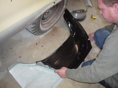

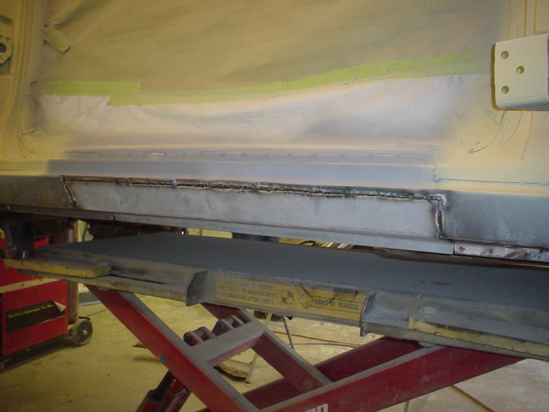

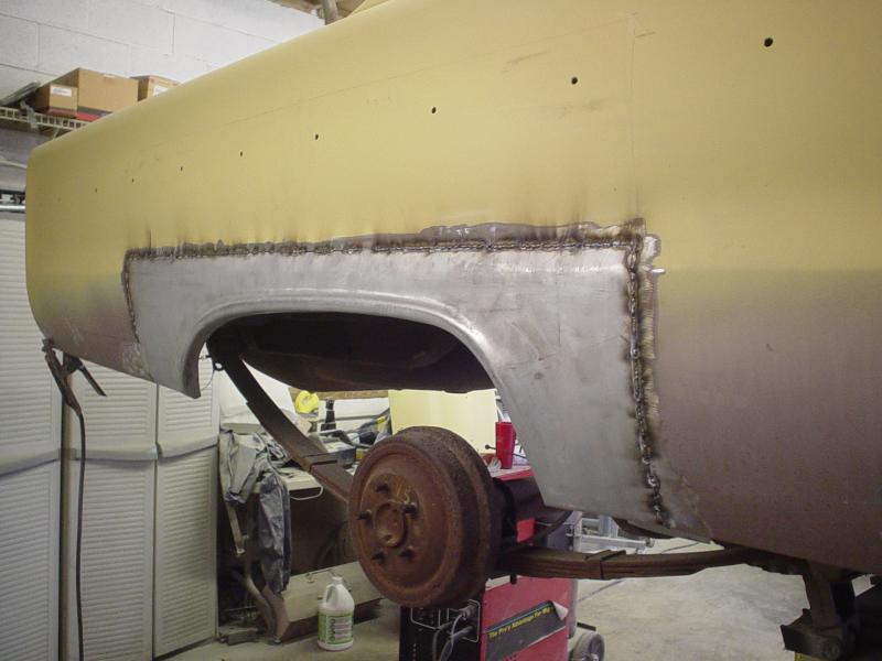

Used Sherman brand panels for my `66 Blevedere II (base model to your GTX). Same thickness as original metal. Attached are a couple photos of panels as they went in. Wheel opening fit perfect. Nobody made an outer wheel house at the time I was having body work done. We cut a patch from a `67 Dart outer wheel house since it was 'closest' in shape. With some metal massaging, it worked fine. Same thing with the rocker panel on the passenger side...it was for a `66 Coronet/ Charger. We just needed the outside skin, which matched up fine. The lower qrtr matched right up. The Sherman trunk extentions are a one size fits multiple cars...your GTX, a Coronet, Charger, etc. It needs to be trimmed accordingly. I ordered one trunk extension and the body guy was able to get patch panels out of it for both sides. I wil look some more for photos of the lower rear qrtr and trunk extensions.

No, I did not. My ride doesn't have them. I'm sure it would fit though. The outer skin panel was a good fit.
I bought a lower quarter for my 66 belvedere from goodmark and it wasn't close. I found a four door and cut out the lower quarter. I used the trunk ext from Sherman which was for a 66 coronet it was a little different but my bodyman made it work. AMD told me a few months ago they was working on this piece.
