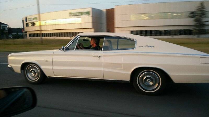

Not the best picture, but I think this seems like what you are talking about. 17 inch rims with the tires pretty much evenly tucked into the wheel wells.

Hard to tell from pic but seems close. Do you have the specs for your setup like:
- Wheel offset
- front/rear tire size
- leaf spring configuration
- front suspension configuration
- etc.

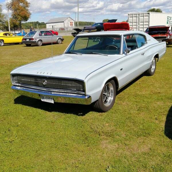

Here is another picture, still not the best angle though. The tires are 235/55-17. The rims are 17x7. They are zero offset so the backspacing is around 4 inches. The rear springs are stock, and I adjusted the torsion bars to get the front even.

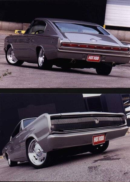

This was done in the late 90's Rear springs with a 2'' drop from stock.17'' wheels and 40 profile tires.
Front torsion bars lowered to shaved lower control arm bumpers. Ride was ok but more for looks.
Only photos I have. You can look in Hot Rod Archives around 1997-98 for more photos.
