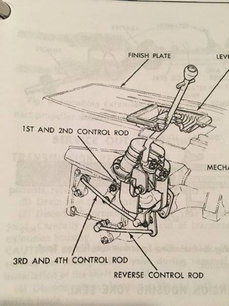

looking for parts break down on 66 charger four speed shiftier with reverse lock out can someone help?

i am assuming its an inland that why i am trying to get info tried looking in manuals did not see the shifter the revearse lockout is not working and trying to get a break down so i can see whats broke/missing

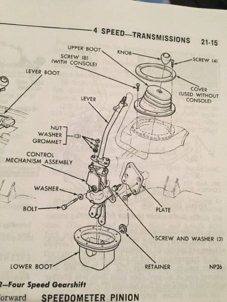

I don’t have my inland shifter handy, but I would guess it’s the wire in the lever that attaches to the trigger. These pictures aren’t great, but that’s the section. Section 21, page 15: in that area.
thanks i do have this one and its good to a point was hoping to find the complete break down for it this car was my dads first new car and i found it and bought it back and trying to get it back in almost perfect running shape for my dad for his old glory days its funny how the charger for 66 67 can be so hard to find info on putting a clutch in it this coming weekend and would love to fix the shiftier while im at it

so i put the clutch in and yes foung the cable broken problem is the locking pin i think and a spring i would think is in there is gone were do i go from here?
