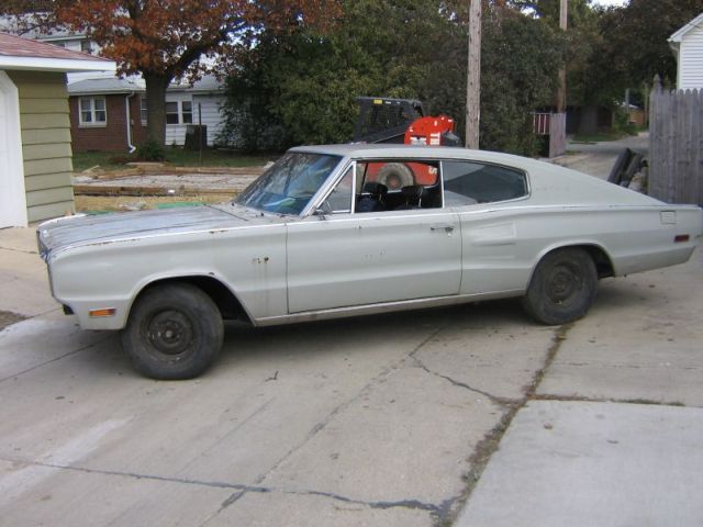

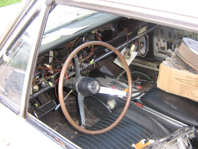

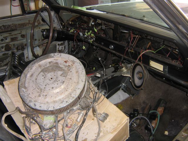

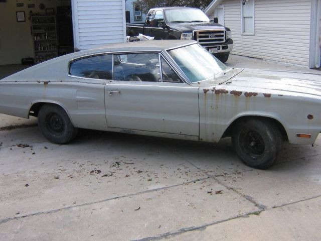

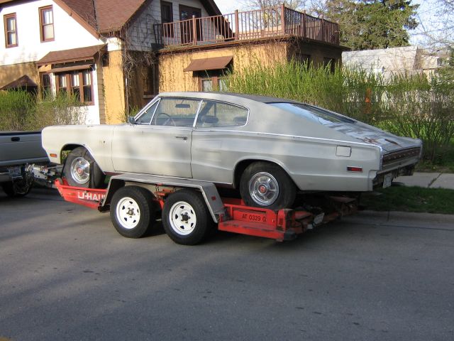

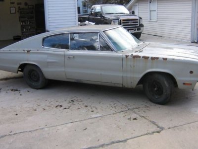

I haven't posted on here in awhile but I've been around. In between work and some major home renovations I have made some progress on my 66.

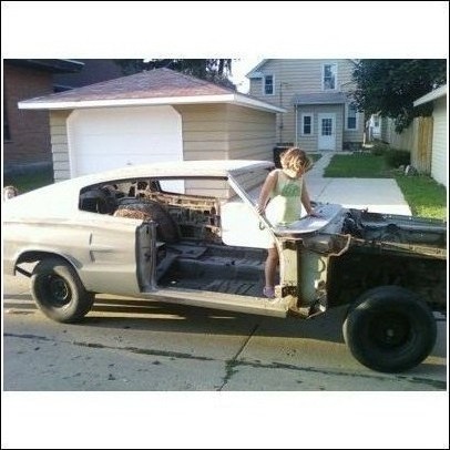

Car was purchased from Kentucky and hauled back here to Wisconsin a few years ago. First year it pretty much sat in my garage untouched. Second year I started gathering parts which was not an easy (or cheap) task. Then the car was totally disassembled, and started with repairing the floor pans and welding in the sub frame connectors. Now I am at the point where the body has been stripped and the bodywork on the shell has been finished. I'm about to start the bodywork on the bolt on panels next.
I will keep posting as I go along. I am going to do everything myself with the exception of the machine work on the block and the transmission.

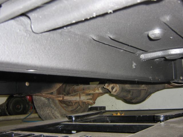

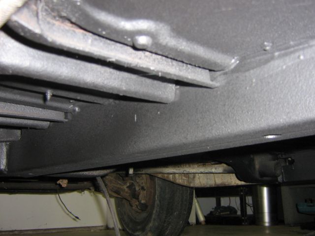

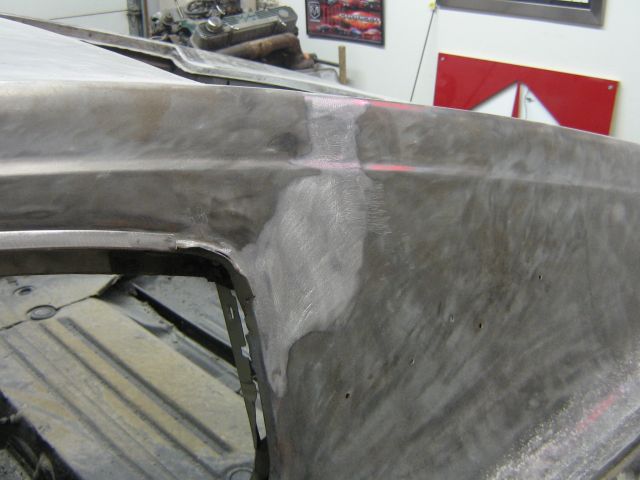

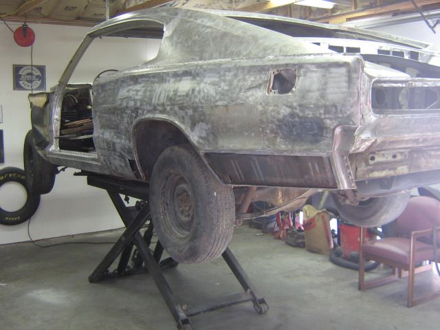

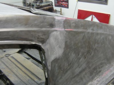

body stripped, rust cut out

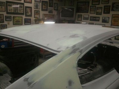

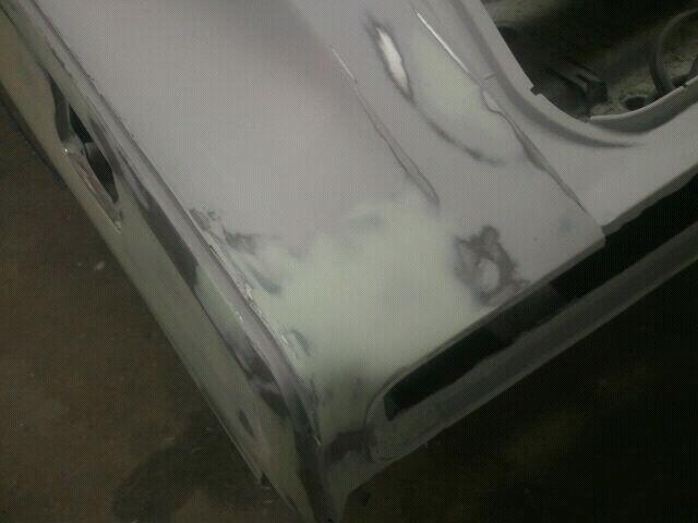

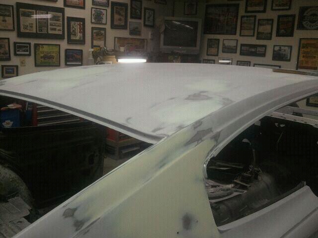

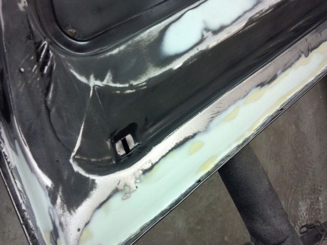

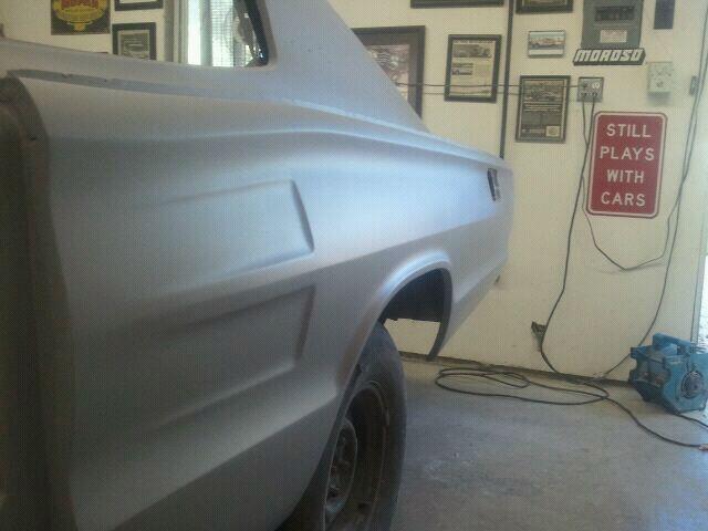

bodywork... (helps that I have been a collision technician for about 25 years.)

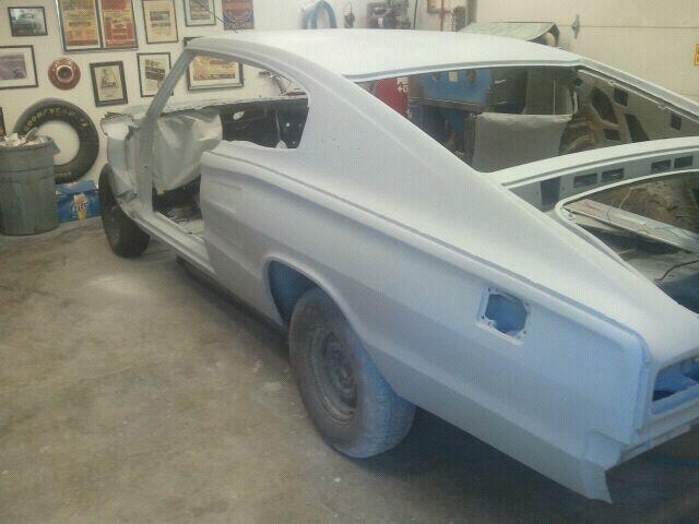

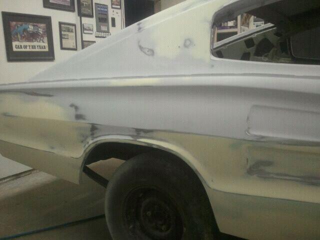

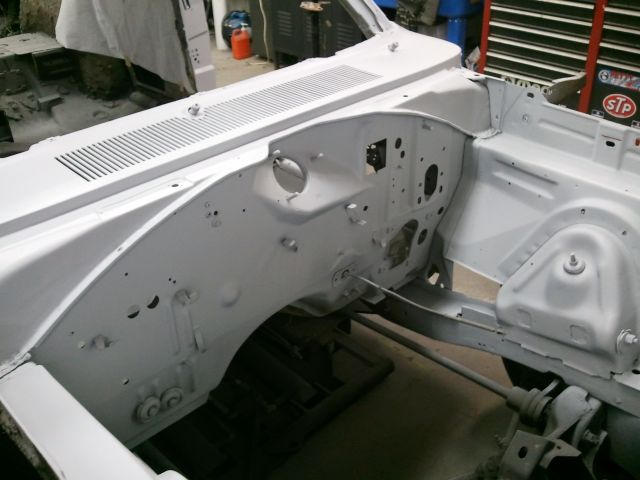

primer
Please keep in mind, this isn't a rotisserie restoration... this car is being built to be a driver and a whole lot of track time!

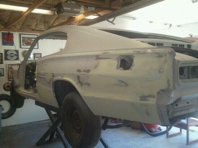

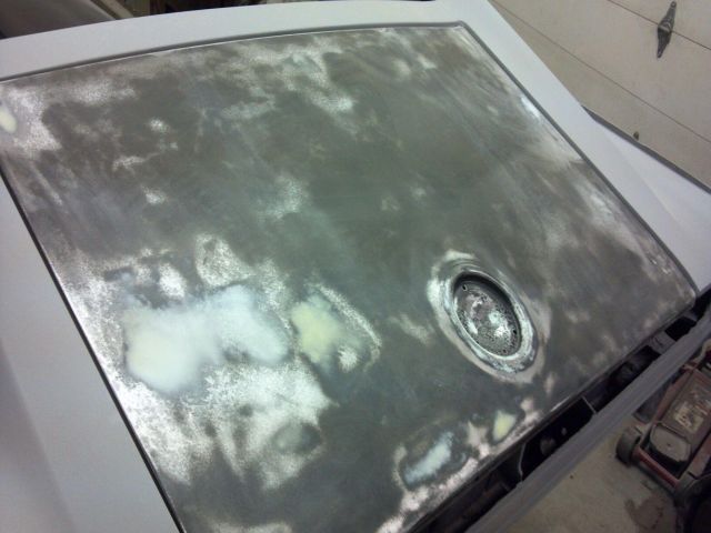

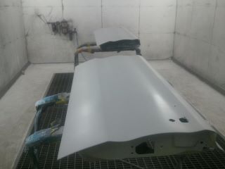

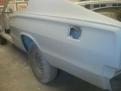

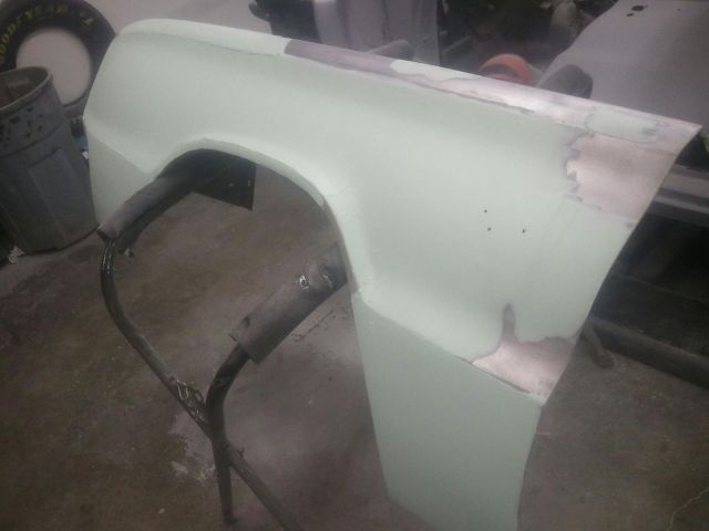

Well, not as much progress as I had hoped... but have made some. Both fenders and doors are now done, as well as the trunk lid. The left fender was in really poor condition, besides the little rust repair that I knew it was going to need I also found that it had areas with an inch or more of Bondo. Somebody in the past had some real issues with not wanting to do metal work and decided to just mud everything up! I literally spent around 12 hours on the pair of fenders just doing the metal work. It looks like there is a lot of Bondo now, but it is just a cosmetic coat of finishing type filler.

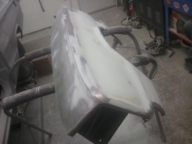

Also, sometime in the last 40+ years, it appers that the gasket around the deck lid medallion had failed, letting water gather inside the rear lip of the trunk lid. The whole inner lip had to be cut out and patched.
Starting the last panel now ! (hood) After that, final blocking of the primer then off to my shop so I can finally get some color on it!

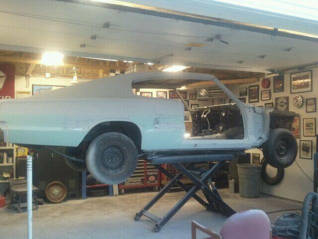

The block is almost done and should be here next week sometime, the trans has been dropped off at local tranny-rear end guy here in town that I have known for years and should be done in 2 weeks. The trans is the only thing that I'm not doing myself. Never did one and I'm thinking that I'm too old to start now!
like your portable lift, who makes that? and about how much was it? i have a 66 charger that is a daily driver
66 charger
Herkules makes them google there site for info ,there is also one on ebay for around $1500.00 I believe the new ones sell for above six thousand there nice.
This one was $1200, bought it from a local company called Smash Equipment. Area supplier for collision shops. These can be purchased from Snap-On, Matco, etc... just check around for prices, some are really marked up.
