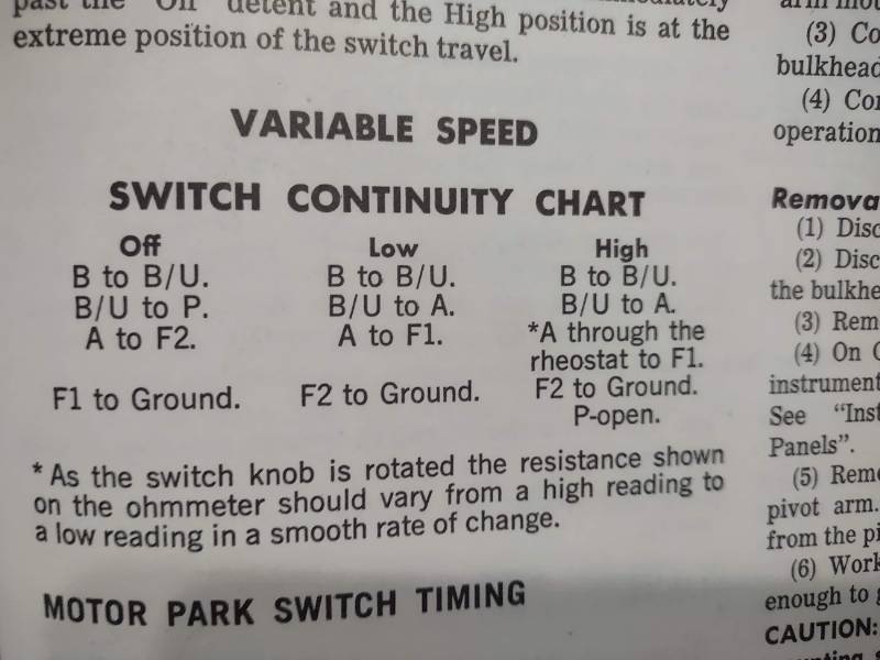

Hopefully I can be of help.
I have a 67 Service Manual here:
The B terminal on the switch (Pink) wire would have 12V power with the ignition in ACC or RUN.
So if the key was off then why you were leaking power through the switch is a mystery?
Here is chart for switch functions:
Unplug the switch. Still have a power drain?
Verify the colors
B=Pink
P=Dark Blue
A=Brown
F1=Red
F2=Green
W=? (sometimes white, sometimes brown with a tracer)
Thanks Don... I will run this test. I also converted to LED lights and am struggling to get the LED flasher to work as well. Not sure it is drawing enough power.
