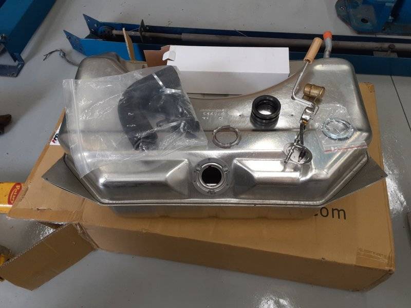

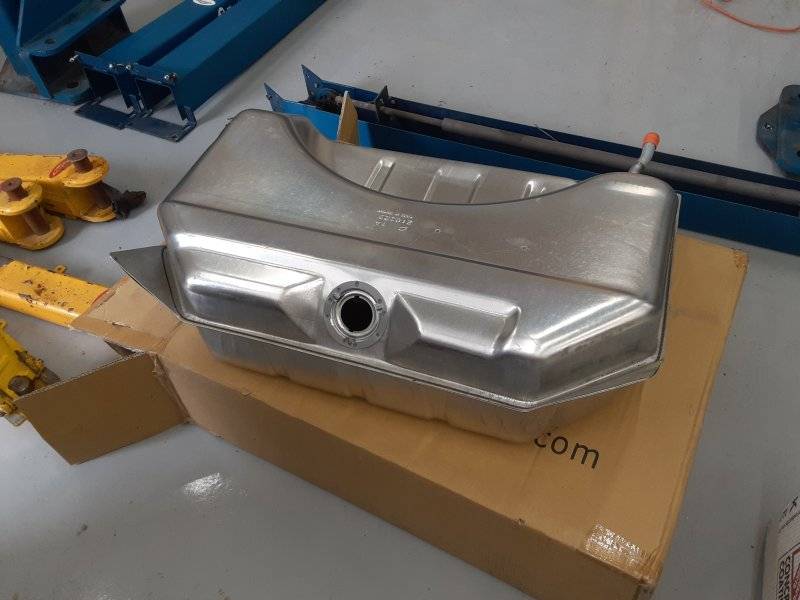

So while I was at Carlisle, I picked up a fuel tank, pick up with sending unit, filler neck hose kit and filler neck grommet for the tank. As soon as the racks are installed in my shop, I'll be swapping in the new tank.

I want to drive this thing up the 2 hour drive to National Trails and the Mopar Nats. First thing on the list is to replace the fuel tank with the one I bought at Carlisle. I have a new tank, pick up, filler neck grommet, and filler neck hoses. Since I can't get my lifts installed and working in time, I'm going to be fixing this and the exhaust on my back on stands. Yay. And there was much rejoicing, yay.
I got everything out of the box to inspect it. Everything looked good. I had an old lock ring out of the belvedere tank that I thought was just another repop, but it turned out it was a heavy gauge like the originals. I cleaned it up and I'm using it.

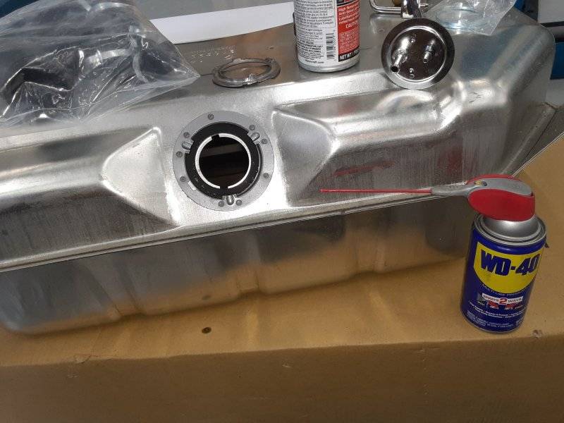

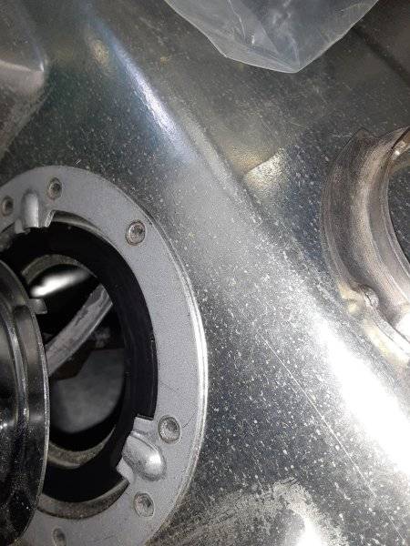

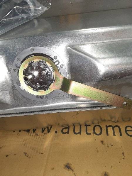

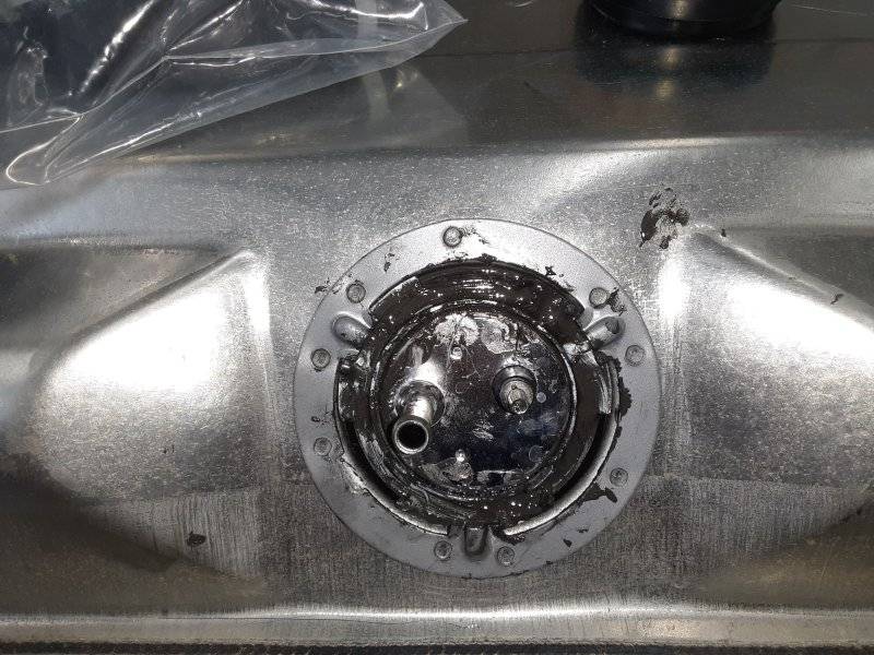

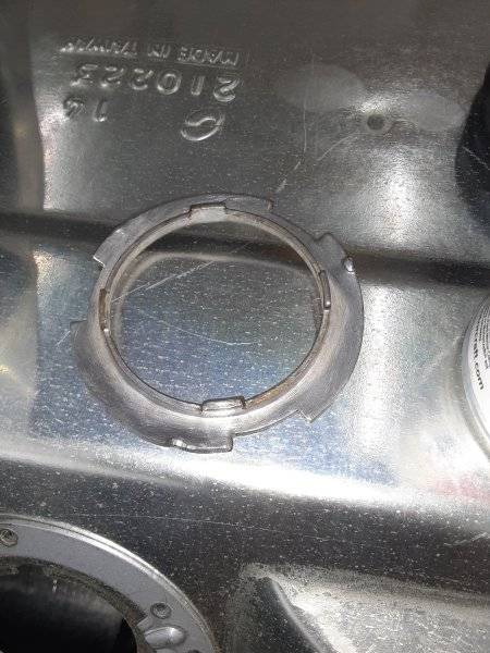

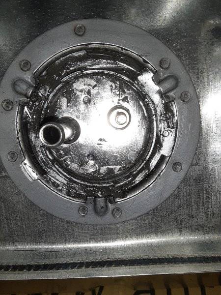

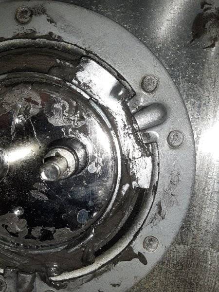

I went out and got started. It's in the mid 80s but 100% humidity or thereabouts, so it sucks being outside. I lubed up the gasket supplied with the tank with WD40 and then I installed the sending unit. Made sure to line the 2 teeth with their grooves in the
tank I brushed anti seize on the sending unit top surface and on both sides of the old ring. After a while of screwing with trying to get it started, I finally gave up. The ears on the tank aren't angled up enough on their edges to allow the thicker ring to get started, so I had to use the supplied one. I lubed it up and got it started and then it wouldn't let the bump on this ring that locks the ring into position, under the ear. So now I am going to order the special wrench to see if I can make this work. The Holley tank I used last year gave me zero issues. I thought I'd try this one, and am regretting that now.
I ordered the sending unit lock ring tool, fuel hose kit, stainless ground strap for the sending unit, and a new negative battery cable for the Coronet all from Classic on Monday. On Wednesday, I still hadn't received a tracking number, so I called. I really wanted this tool by the weekend. They answered pretty quickly and the guy was polite, but told me it can take up to a week to process the order and I asked their location and he said California. I thought, ****, now I'm going to have to wait til next week or the week after. I hung up and thought about it for a while as I did other things. I decided to call Megaparts. Guy answered the phone, and said they carried those tools but he wanted to make sure they had them. He came back to the phone and said they did have some. I said can you ship it today? He answered sure thing. I got it today, went out to the garage and after trying it a few different ways, I tapped it and it snapped the lock under the ears on the tank. It was really that easy. I finally found a lift guy who will anchor, level and adjust my racks for a reasonable price,so that is a load off my mind.

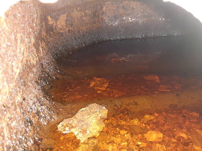

The fuel tank swap has begun, and boy did it need it! Just look at the inside of the tank, no wonder the pick up kept getting plugged up! Check it out.

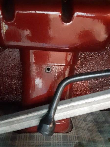

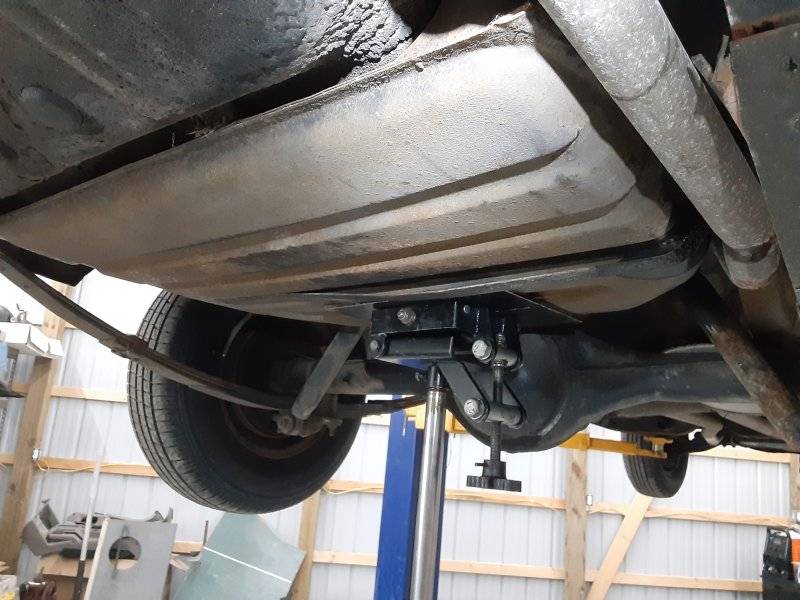

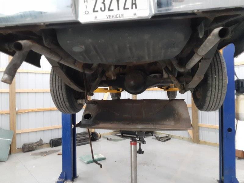

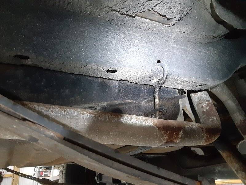

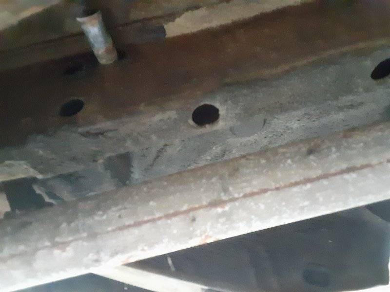

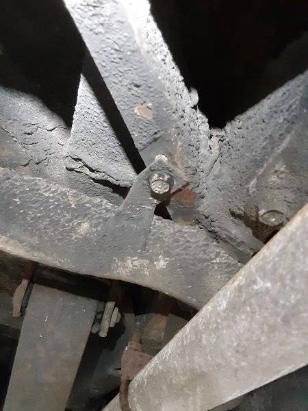

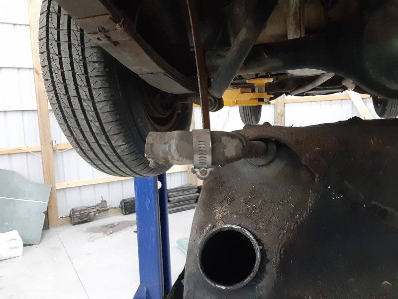

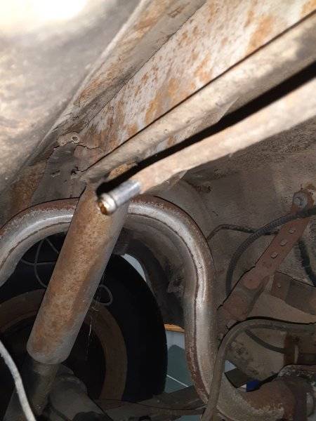

So to start at the beginning, I got the car up in the air, God how I love saying that!, and sprayed penetrating oil on the J bolt. BTW, is it installed correctly? I thought it went up through the frame and hooked to that hole from the inside out. I read the service info, ignored it and pushed ahead. Lol. I supported the tank, removed the nut holding the tank strap and lowered it down. That's when I realized the damn thing was nearly full.

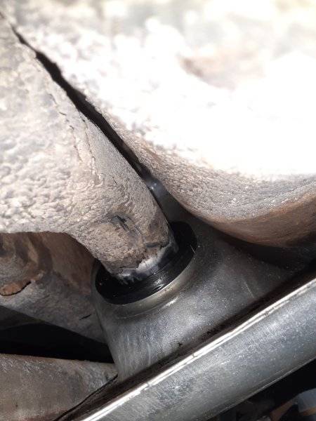

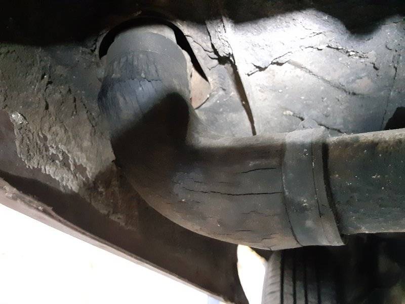

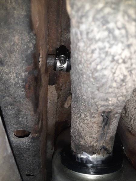

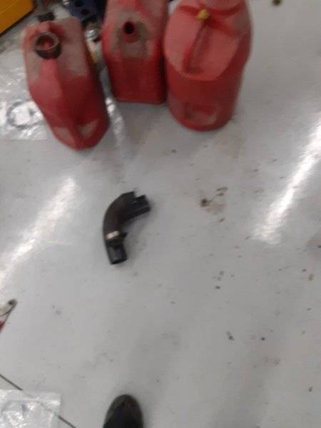

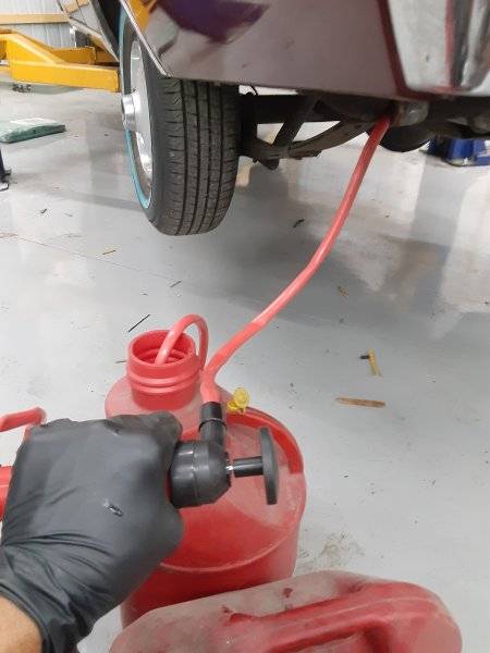

I bought a siphon pump from the parts store, then saw it today for 10 bucks less at HF, and used it to siphon the fuel out if the tank. I got most of it, there may be a gallon left in the tank, but I got 2 full gas cans out of it, so about 10 gallons. I had to wrestle all the hoses off from filler neck and vent tube. All the hoses were in awful shape, lots of dry rot and cracks. I was able to remove the filler neck elbow and then access the clamps on the tank's vent tube. Once I got those loose, the tank lowered down a bit. I then removed the fuel hose and unplugged the gauge wire, which the entire insulator and stud broke off, rather, fell off. I guess that explains why the gauge never read anything. I then removed a single screw from inside the trunk that releases the filler neck out of the chimney like tube it's in. This part was all very different from my Belvedere. There was no rubber seal on the filler neck anywhere. I'm not sure if there is one on this model. Tank came out and I removed all the tubes and cleaned up the rust on the sealing surfaces.

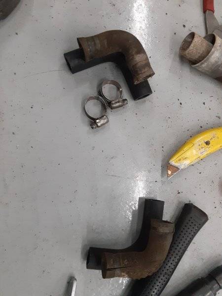

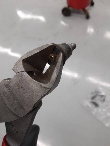

More pics. I was able to pull the rusted off piece of the sending unit out of the harness plug with my side cutters. I laid the old hoses on the new ones so I could cut them to length before install. I used a roloc disk to clean the rust off and this is where the heat finally got to me and I had to call it quits. More later.

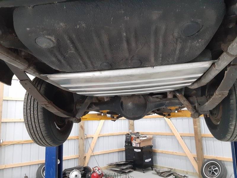

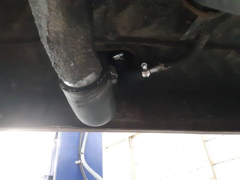

I got the hoses trimmed, cut some too short and some too long but it works and looks decent. I put the vent elbow on the tank and then lifted the tank up into place. Then, I couldn't get that stupid hose to go on the steel vent line. I used WD and did every trick I knew. Finally, I dropped the tank and pulled the hose off and slid the steel line in and worked it around until it just slid in without much force. I put it back up and realized I cut it a bit too long so I trimmed it back some, maybe too much, but it worked and went in. Then I put the vent elbow on the filler neck and left the clamp loose. I slid the neck up into position and then positioned the elbow where it lined up with the tube. I pulled it back out and tightened the clamp on the vent. While I had it out, I ran it onto the steel tube and relaxed it a bit. I got it all together and everything tight, but it beat me to death. Hooked up fuel line, tried both steel and stainless ground straps and both are garbage. Ended up using pliers to really grip the teeth onto the tube. I poured gas in it and it fired up. I had to put the last sheetmetal screw back into the filler neck thru the trunk. I think it looks great.

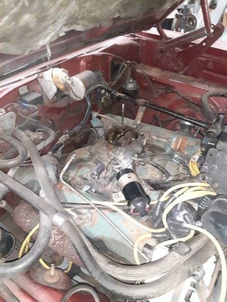

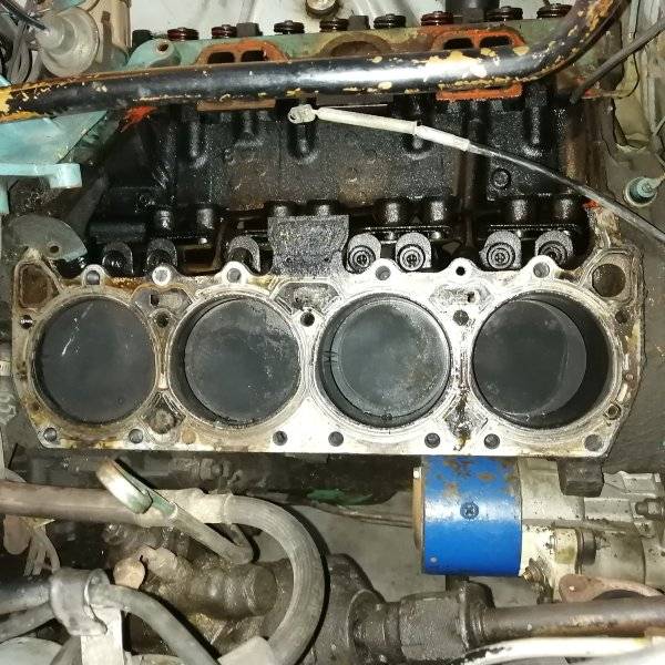

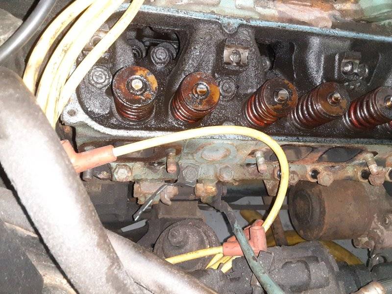

Then..... this happened.

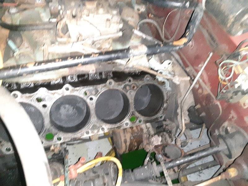

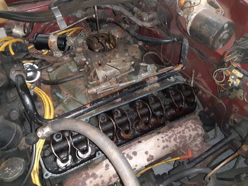

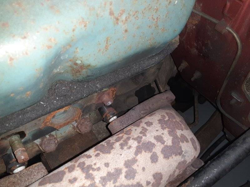

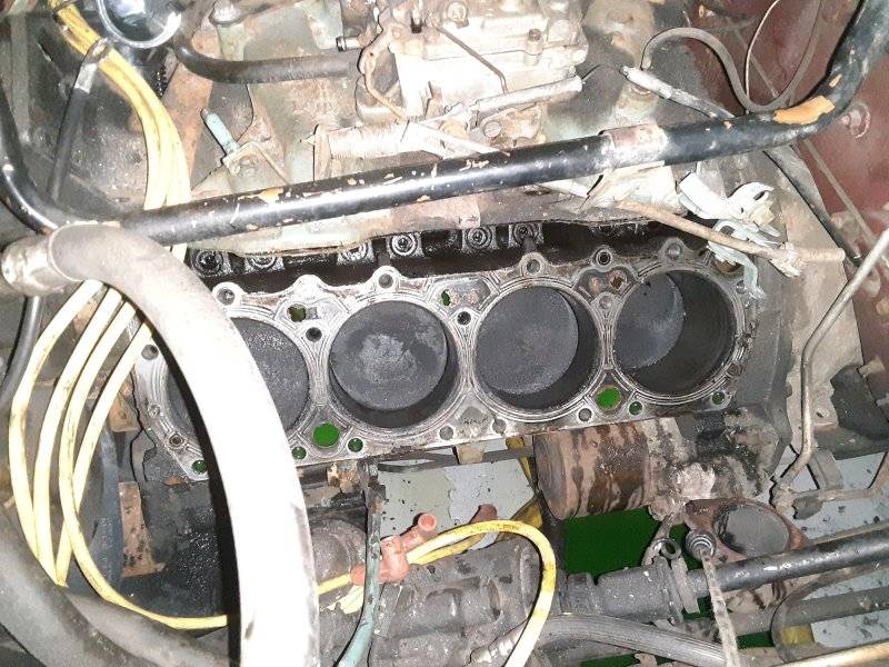

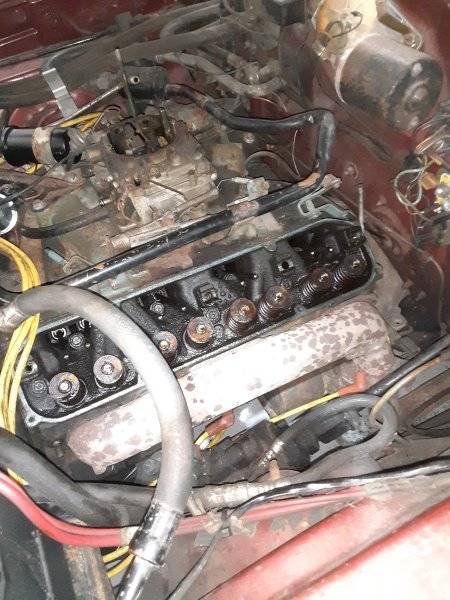

Tried getting the manifold off and of course the long nut was welded onto the stud and broke right off. And, of course, the broken stud I was trying to fix is broke off down inside the threads. This is going to be a bitch and pretty much not going to happen in the car, so I moved forward. I was a flat rate dealer tech for a while, so that is apparent in how it came apart.

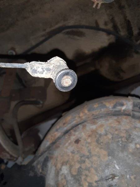

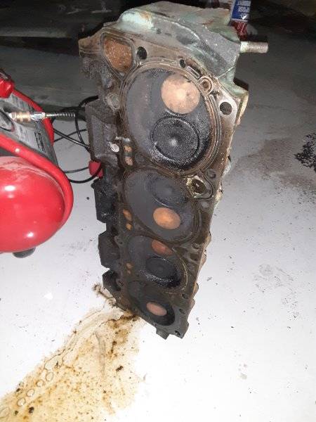

Have no clue why the pics are out of order, but oh well. Engine looks pretty gummy but not the worst I've seen. The worst was tipping the head up on it's side and a bunch of old nasty gas poured out of the intake ports. I guess that afb is dumping fuel somehow, never really looked into it. I ordered new gaskets and wheel bearings and seals as I'm going to machine the drums and rough up the pads. I won't be able to do much as I won't be able to walk across the concrete to get in the door until next week sometime. I may be able to sneak out there tomorrow and get some of the stuff cleaned up. I'll update as I make progress.
