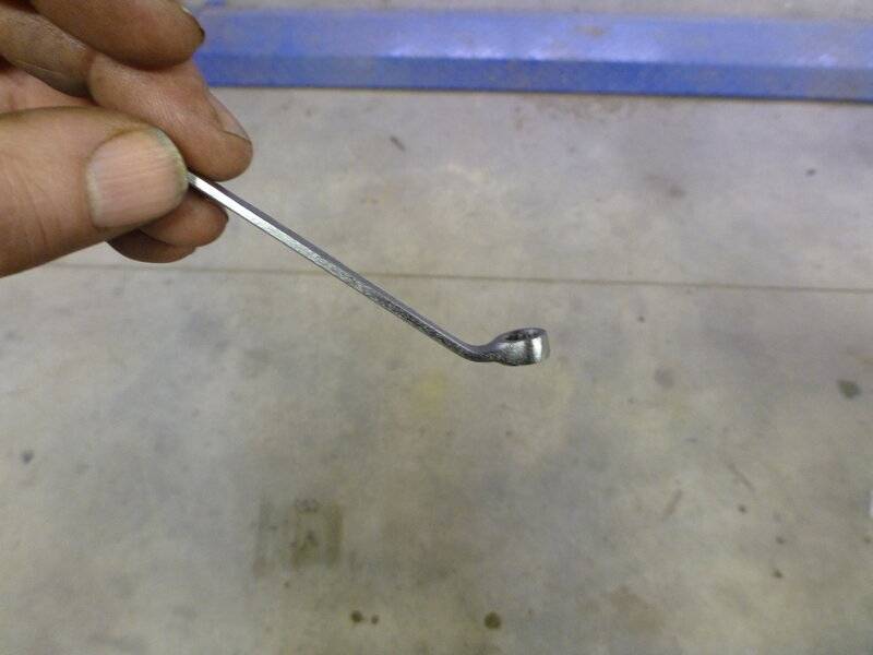

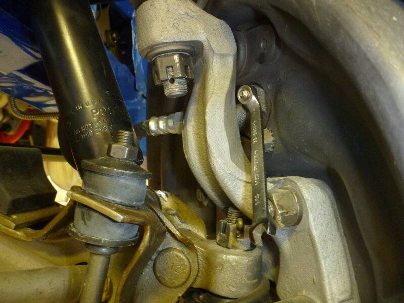

I had a similar problem on my '69 Road Runner. I heated and bent a wrench to fit.

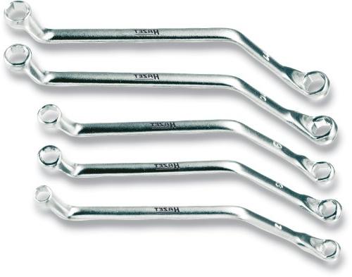

That's why they make numerous brake bleeder wrenches, out there in the mechanical repair world.
After you build or buy a wrench,If its stuck tight, careful dont twist it off.
You can apply some heat to the bleeder with a propane torch turned down LOW. dont fry the brake hose or the cly.
Sometimes they will have some rust/crud in the hole and will need a piece of wire ect to get it open to bleed
