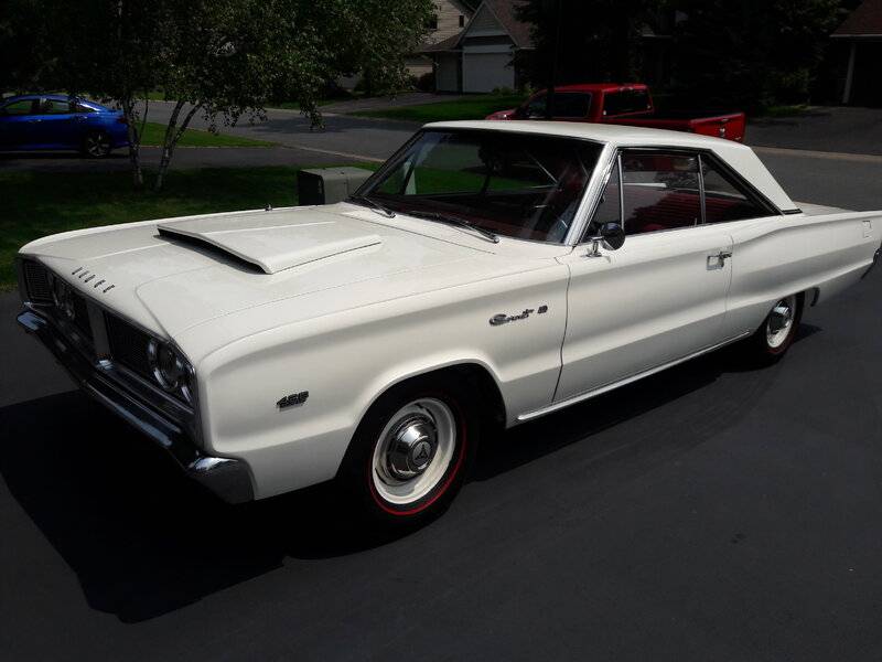

I have a 66 Coronet Hemi tribute. Currently stock 14x7 on redline bias plys all around. I want to do a steelie "day 2" weekend drag car look on the back. I have spent the last hour on this site reviewing tire/wheel combo threads, with lots of similar, but slightly different recommendations. I think I "want" to do this: 15x8, 5x4 1/2 bolt, 275/60/15, 4 1/2 backspacing. I have found threads where this tire and wheel fit a pure stock 66 Coronet. Others say some rubbing in some conditions. The other wheel choices are 15x7 with a 255, but that seems too small width, and that has a 4" backspacing only available. So....
15x8 with 4 1/2" backspace on 275s
or
15x7 with 4" backspace on 255s
or
15x8 with 4" backspace on 255s
I want NO problems I have to further mod around. What's the concensus?

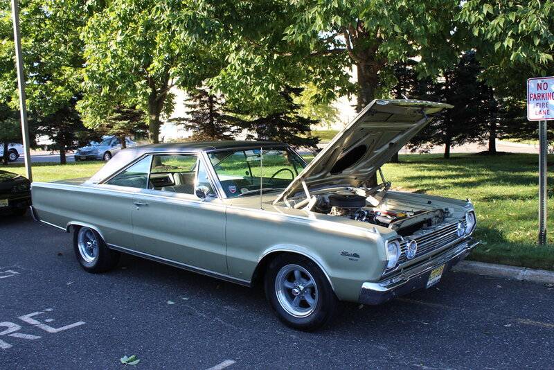

On my 66 Satellite I put Torque Thrust 15x8 with 4.5 B.S. and
Mickey Thompson Sportsman S/R Tires 6640 which are 28x10 with zero problems.
