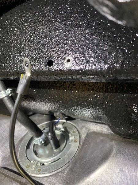

Great Question. Here are the pics of the Sending Unit. I will explain the deal afterwards.
OK, so if you look at Pic 1, you see the sending unit and just above that you see a Stainless Steel Screw that goes into the Shock Mount Brace. In Pic 2, that black ground line goes to the corner of the Fuel tank and you can see another Screw that I drilled into the tank. Pic 3 is a diff view of the sending unit.
I wonder if perhaps I did not get a "good" ground to the Shock Towers, or do I need to Ground directly to the Sending unit? Thanks again, B.
Here is what it looks like under the Ground Wire that I put on. Also drilled Fresh Hole for the screw to go in. Seems like it should ground?

Thank you, I think the Tank is pretty well "grounded" by the pics above? But B-Rad, if you have a suggestion on another way to test, I am all eyes/ears. Thanks in advance. B.

I would think the ground you have should work, I think Beekeeper has a good point.
