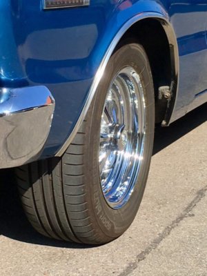

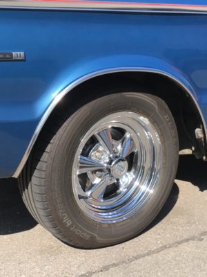

I agree, 15“ rims will give you the widest variety of tyres. 15x7 are right, and depending on how stock you‘d like your Satelite to look, there‘s a choice of 205/70R, 215/65 or 225/60, all of them with a similar overall diameter. I went with V-rated 215 Dunlop Blue Response which offer amazing grip and look good too, without loosing too much of a stock stance.
342E0139-B2F0-4C74-B74C-EC2088074598.jpeg B59A6D1C-A1C0-4BE4-A5EB-6490E806BE91.jpeg

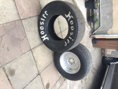

running 275/60/15 MT's but i also run these, 30-9-15 slicks. no inbound leaf mods, or arch trimming, the 275 are tight but work

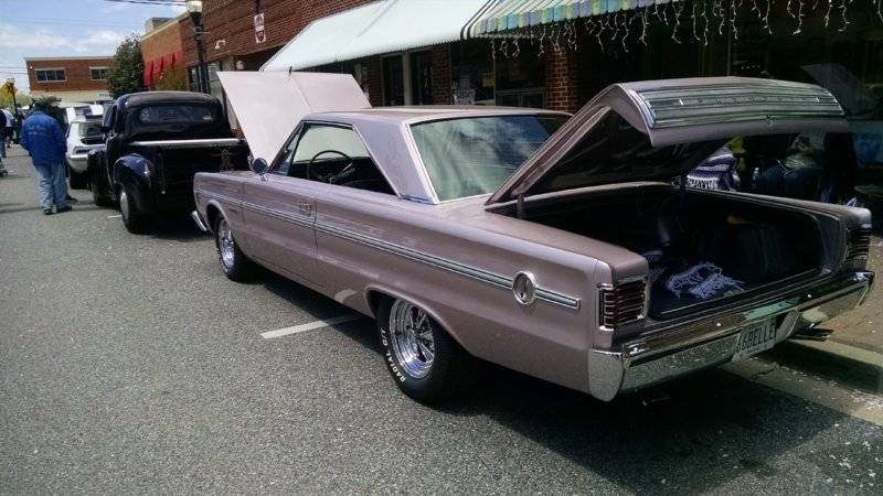

Had L60 x 15 4" BS on my 66 Satellite rubbed on hard corning. Getting them in/out of rear wheels involved jacking spring down with a bottle jack. My car post #4.
