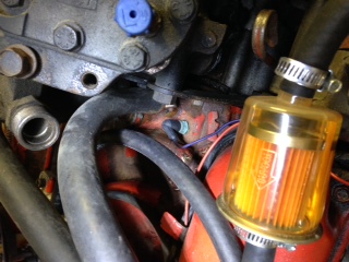

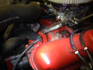

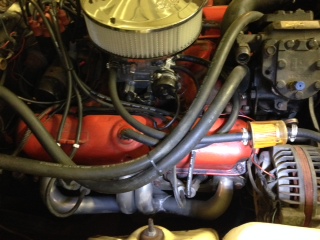

I have a factory 273 v8 in my coronet, with cast 4 bbl intake, shortie headers. I can not find a good location for the aftermarket procomp temp gauge I want to install.... there is only one spot in the intake and it has a small hole for just the idiot light. anyone have any good ideas? locations? my shortie headers on side make it difficult for any side of block locations....help anyone? pics? etc...

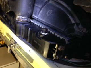

here is a pic of my radiator...I have two places on it that are plugged...would this work? how accurate would it be compared to the block water temp? etc... what you think?
If the threads on the radiator plug the same as the sensor you're golden.... or you need an adapter but this is where a temp sender goes...
More accurate because it will allow the engine to warm up before the thermostat opens and warms the radiator then it controls the temp switches... on the block it warms up before the radiator does and the fan will come on and make the engine slower to come to temp and delay the thermostat... you won't notice it either way but that's the reasoning
sender bulb needs to go into the coolant before the thermostat..not after
