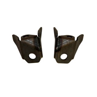

If your front end hasn't been rebuilt....I'd buy a pair of factory LCA's with the brackets, and rebuild the whole front end. Otherwise, I don't know of any place to buy just those factory brackets. I think you'd have to buy complete lowers.
My anti sway bar is mounted to each LCA using an end link and an L bracket attached to the lower shock bolt. PST or similar has these heavy duty brackets. I used a stock sway bar. Many miles and no problems.
Also check out Hellwig on the Summit website. Part 55903. There is a picture of what is needed.
