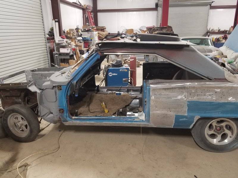

Started razor blading it, then DA, finally decide to use the strip disc that worked really well. I've gone through about 6 so far, still have the trunk to do...
Me to i love the strip discs until they catch a edge and explode lol by the way your car is looking really good nice work
My father in law and a friend are helping me get ready for a big weekend by removing the doors, plan is to have the whole thing stripped and in epoxy so the body work can begin!

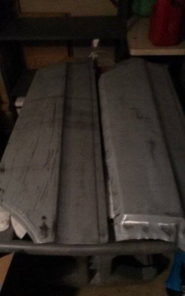

Went ahead and ordered the Sherman trunk extensions and the lower rear quarters...

Got some more parts in. @YY1 was right about the trunk extensions they showed up and said they were for a Charger/Belve, my order said 67 Coronet and the fill neck hole was missing. Called them up and said that due to the variances in locations they quit punching holes in their products...oh well I just need the lower half anyways...
Almost ready to cut them in!

They look pretty good pretty much all the aftermarket stuff has to be fabricated to work had to do they same with my cowl all part of the journey my friend
