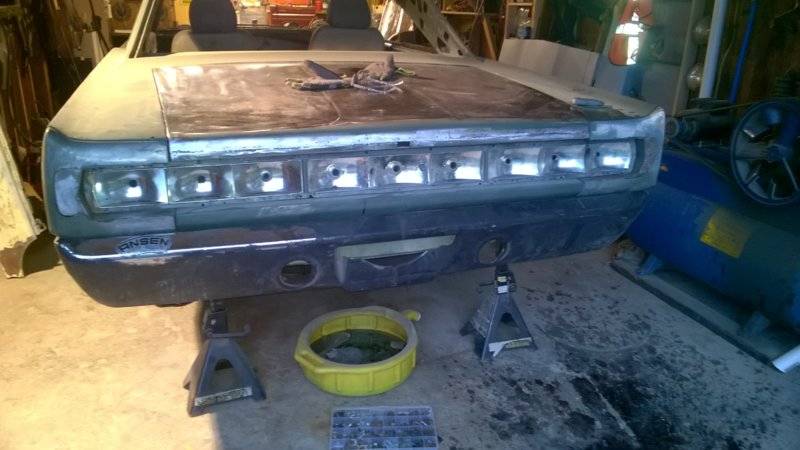

67 grill on a 66

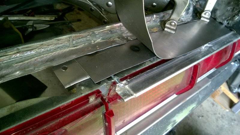

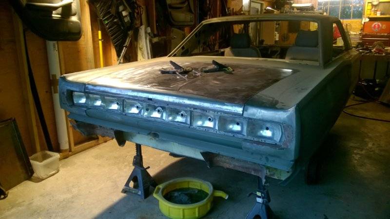

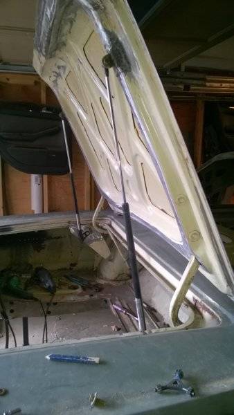

Nope, guess again lol. That's the OEM deck lid, just cut down and a new trunk seal flange fabricated to the underside.it needs some more work still....
Very nice love the fab work on your car there wont be another one like it that what makes it even cooler :thumbsup:

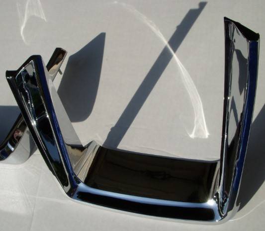

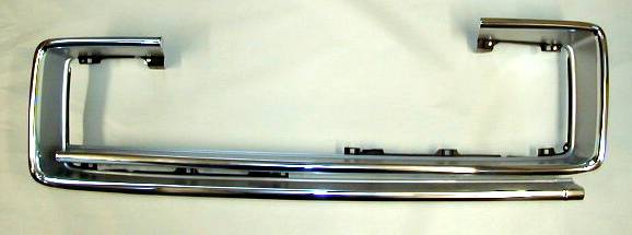

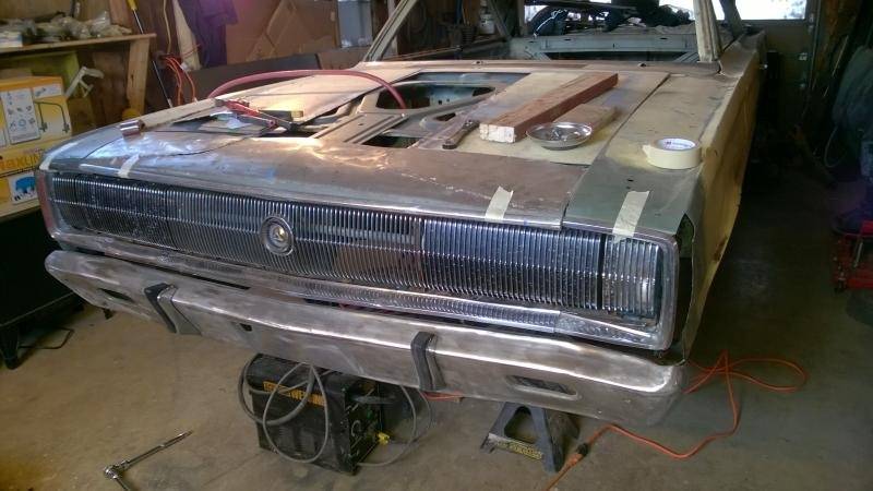

Way different looking. The Coronet ones are Argent with polished aluminum and the Charger ones are chrome.
top two are coronet and the last are the "C" chrome ends and you will need a charger center panel top and bottom.
I am working on fabing the surrounds out of Carbon fiber. Using the good drivers side ones I have a plug. If I can get it to work then Ill either get my passenger side fixed or try finding a better one that I can fix with body filler to use as a plug for the passenger side mock up. If I would have known it was going to be such a PITA finding decent surrounds I would have fabbed in a 68 style grill and lower support before I sent it to paint. Live and Learn.

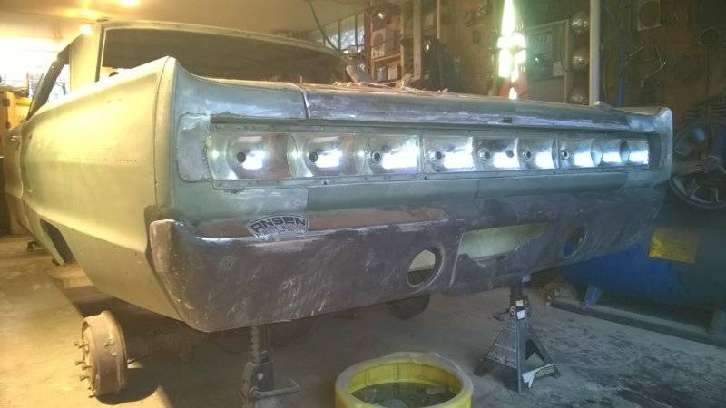

Well back to the car today need to finish the cowl and shaving the drip rail on the drivers side would of left the drip rails but the were rusted pretty good and i do like the look of them gone lol
