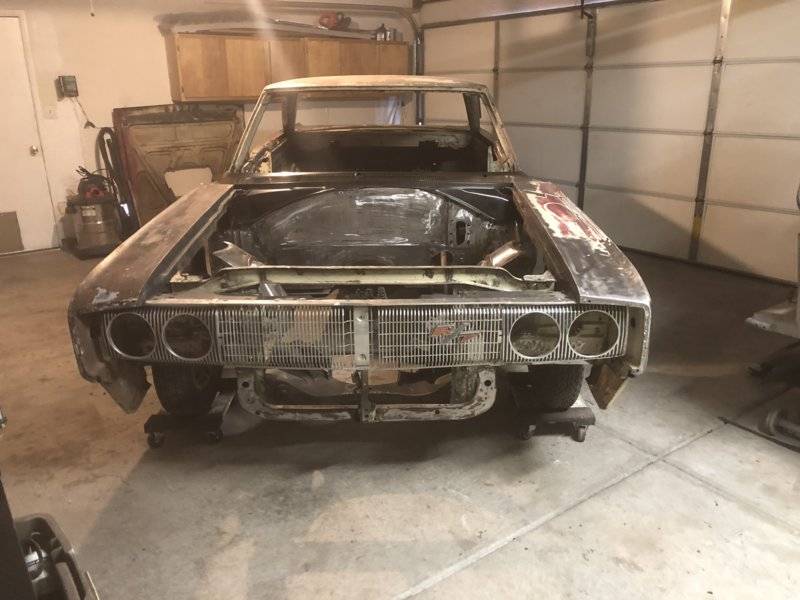

so i got bored yesterday and decided to clean the garage well one thing led to another so on went the fenders and wanted to see if this grill i bought for 45 bucks on eBay would actually fit most the mounting holes match right up i know the headlight buckets set further back and in on a 66 does any one have pics of the mounting on there 67,s
headlights are also farther inboard on 66.
Mine is a 67 and if i cant find a decent pass. side surround I am going to install the 66 set up I have on a shelf until I find one. The 67 as mentioned has headlights that set further out and use a separate headlight bucket setup. The 66 bucket are tack welded to the core support the 67 come in a separate bracket that screws into the lower support behind the top of the bumper. The 67 also uses a different cross bar and hood trim than a 66. You will also need to have a 67 bumper or other custom provisions for blinkers.

Was going to do custom blinkers on it like the smooth bumper do you have any pics of the headlight buckets my car is way far from stock

Also if you dont have the parts to convert to a 66 grill ill hang on to the stuff i have

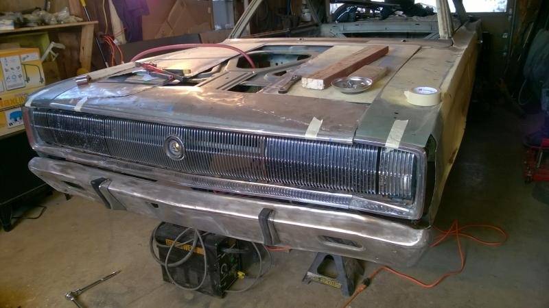

Here is a pic. There is a cross bar that goes along the bottom of the grill and behind the bumper. these screw into that and the upper support .
That looks awesome im not afraid to customize im seeing your not either lol
No.....not at all. lol. What I did was I swept the fender noses back to 90 degree angles and replaced the Coronet lower grill mounting bar with a 67 Charger one so the bolt holes would be there for the flip headlight frames. That picture is the final mock up to make sure I had it where I wanted it.
Yeah i seen your fenders cut in the pics nice job its very clean
