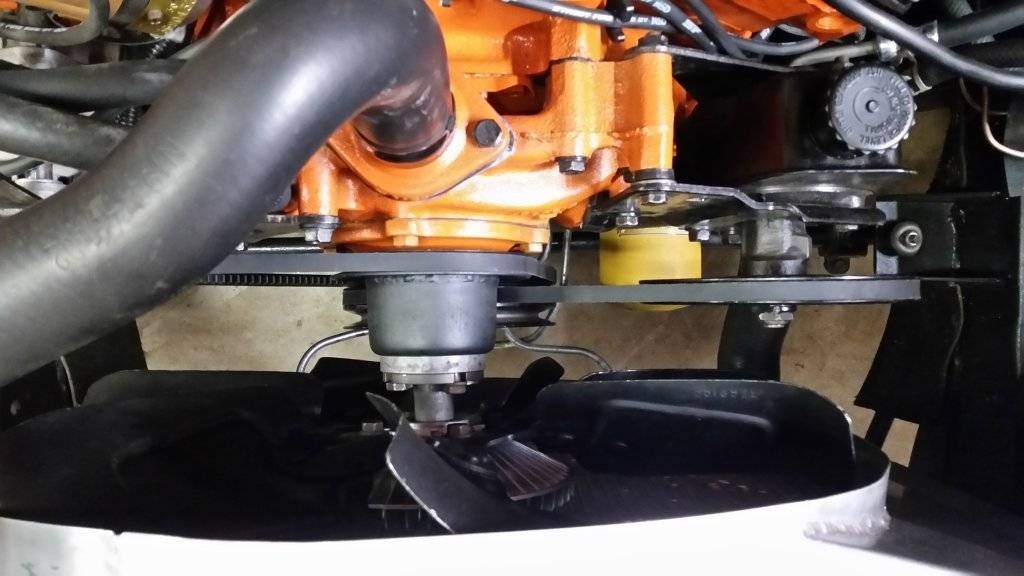

Is this picture funny, or do your A/C compressor belts run at a pretty weird angle as compared to the water pump belt?
Wow that does look weird! The belts are all lined up I guess its my bent camera.

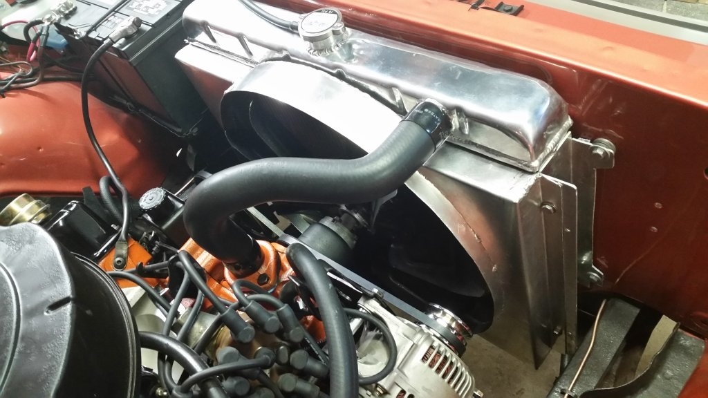

I had some overheating issues with my 440 (no AC). Well, not overheating but running hotter than I would like. On a 95 degree day it would run 195 in traffic and 205 on the highway. Here`s what I did:
- idle timing 22*, 36* at 2800 RPM and 54* full vacuum
- replaced water pump impeller (took from old pump) - it has huge blades, big diameter (earlier in this thread there was a water pump flow test mentioned - mine is RV style that produced the most flow at idle)
- Put a new HD fan clutch and a spacer to move the fan/clutch closer to radiator (about 1/2" away from rad.)
- installed Milodon high flow t-stat 180*
- made a new fan shroud (now the distance between the fan blade tip to shroud is no more than 1/2")
- installed a smaller water pump pulley (crank pulley is the biggest I could find, a bit more than 7"). I could not find a small pump pulley that would be deep enough so I made one. Now it is 5" diameter and lines up with alternator and crank pulleys.
All of that brought the temps down to 180 at idle and 185 on the highway. When I fired it up after all those things done I wanted to bleed the air from cooling system but could not get the t-stat open because the cooling system is efficient now - it barely opens and immediately closes. I can hear the fan pulling lots of air though the radiator now and the air flow is huge with 20" fan - Mopar action magazine would stick to the front of the radiator at idle easily.
The clutch and fan has no affect at 65 mph. If wind resistance at that speed is not putting enough air threw the radiator find out what is deflecting it and correct the problem.
In my case it was the shroud. It was restrictive in the corners - see second picture. I came up with another shroud that apparently flows better (first picture).
