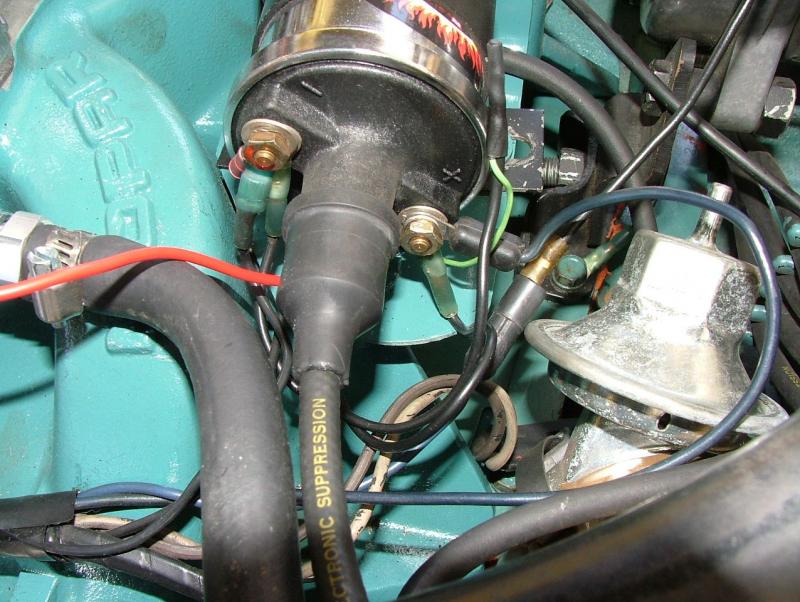

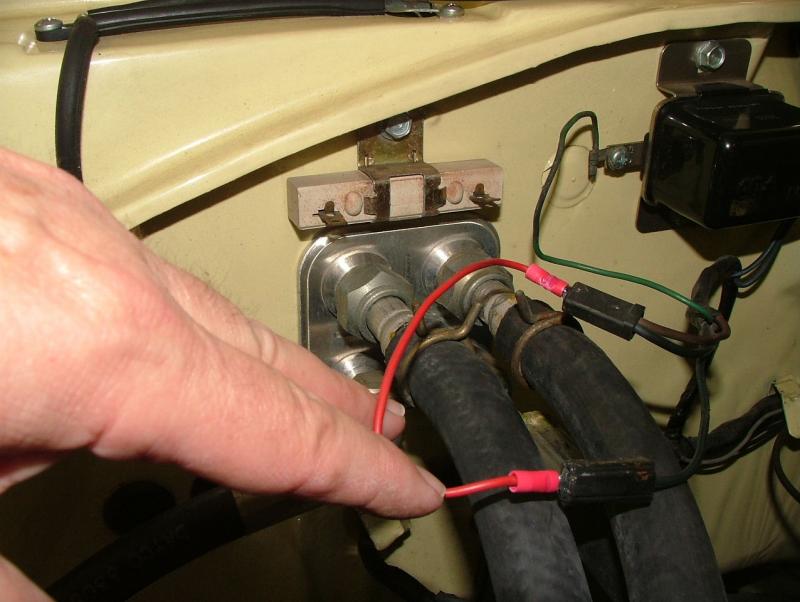

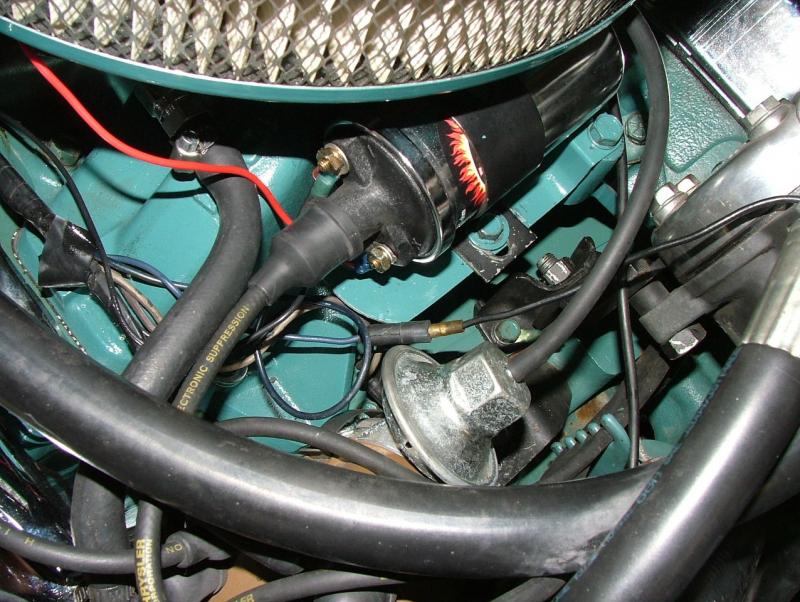

I had an interesting new development this week. I have been thinking about taking the car to a local shop that works on all types of muscle cars to see if they could help narrow down the problem. I had not personally used them so I went there to meet the owner and check it out. We talked at length and he mentioned a number of possibilities so I added my name to his list. One of the things he talked about was the ballast resistor creating too much resistance when combined with an internally resisted coil. I checked and the coil on my car is a Pertronix Flamethrower with a 1.50 ohm internal resistor. I searched this forum plus read the Pertronix instruction sheets and it looked like the coil resistance is all I need, so I made a jumper wire and bypassed the OEM ballast. I took it for a ride today and noticed improvement! It starts better and runs a little smoother at slow speeds but there was a big difference at higher speed, where it used to hesitate and fall on its face now it takes off and feels more like it should. Apparently the over-resistance was killing the spark as the rpm increased. I've still got issues and will have this shop take a look but I am now much more encouraged than I was before.
Check it out with a voltmeter. Typically look for 9-10v at the coil positive with ballast. Would be interesting to see how many volts you had without the jumper wire in place.
This morning I took my car in to the shop I mentioned before. The owner pulled out the coil and eliminated most of the way too many wires that were attached to it, some were from a shift light that I don't need and he deleted. He checked the timing, turned out it was too far advanced. He set it at 36-37 total with 13 initial, we were then able to reconnect the vacuum advance. Combined with the previous ballast bypass the car now runs quite a bit better, no pinging, smooth secondary tip-in and easier starting. I still have the hot soak starting issue and gas smell, he blames it on the Edelbrock carb and says they are crap. I'll need to drive a few more times for final judgement but so far so good.

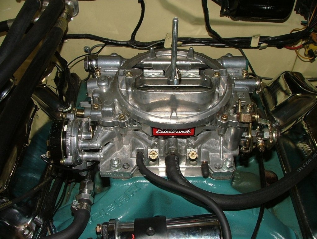

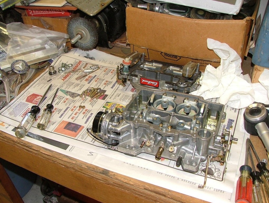

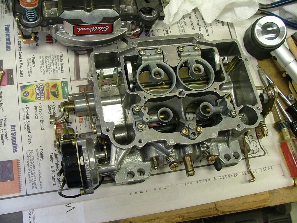

(Warning - long post.) I've made some more progress. I pulled the Edelbrock off and opened it up, it was very clean inside with no debris or signs of wear so it appears to be as new as it looks on the outside. I checked the float level and float drop, one float was a bit off so I adjusted. It had 410 primary jets and 7047 metering rods which were correct for the 1411 carb.
In researching Edelbrock issues on this forum and other sources I saw that a common issue with the carbs tuned for "economy" like the 1411 was that they were way too lean for cars with non-stock cams and lower vacuum. (I think it's pretty funny that they make a 750 cfm "economy" carb at all!) So using the Edelbrock owners manual and the Calibration Kit I converted the carb to the specs of the 1407 model which is the "Performance" version. I bumped the primary jets up to 413's and went to 7042 rods which are actually 1 step richer than the 1407 carb. I left the orange popup springs and the stock secondary jets alone.

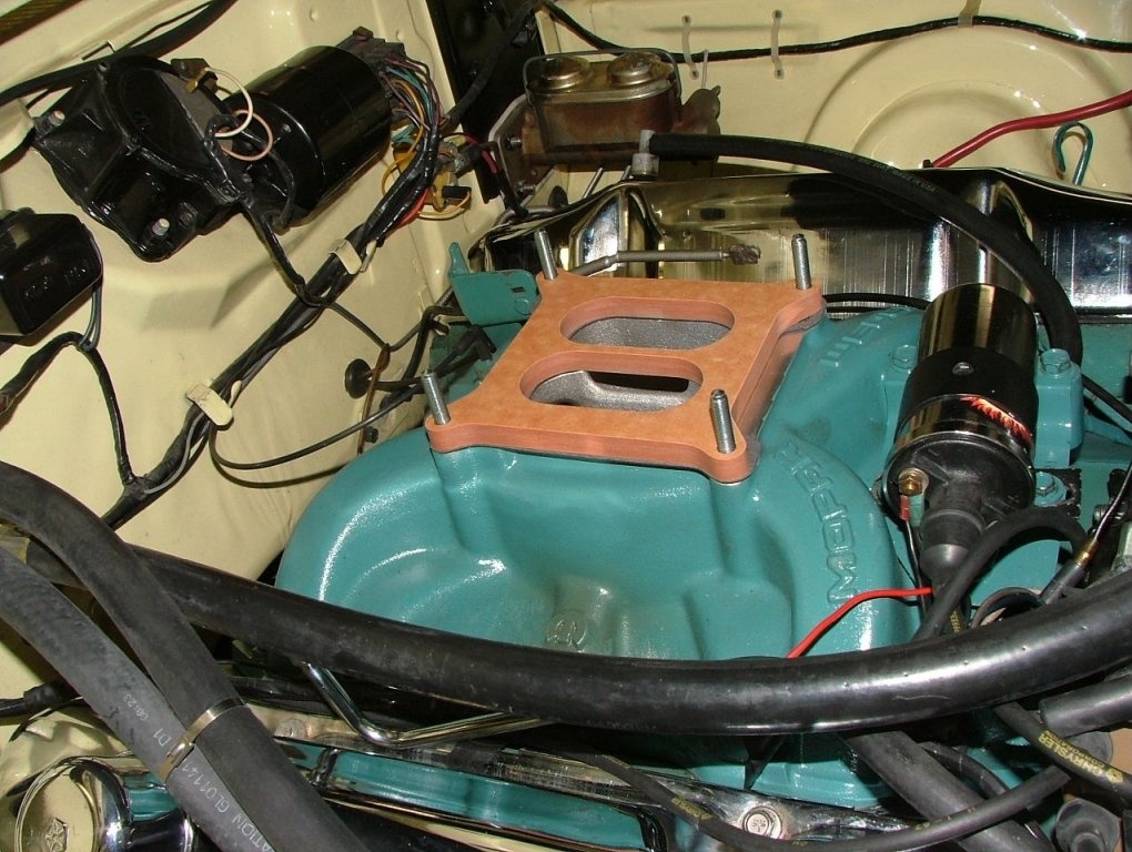

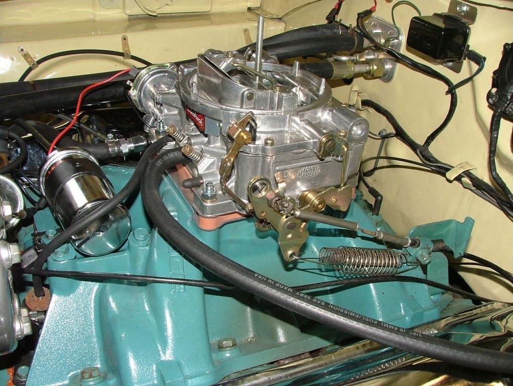

I also added an Edelbrock 1/2" wood composite heat spacer under the carb. When everything was back together yesterday I started it and let it warm up. After the idle mixture was adjusted and the idle speed set at 850 rpm it was definitely running better without the pig rich smell it had before. I took it for a fairly long ride and it ran MUCH better at both low and higher speeds, pulled harder on acceleration without pinging. After it was totally heated up I put the A/C on (low 80's outside temps) and drove a while longer. Where before the A/C made it heat up and run worse now it had almost no effect and continued to run smooth.
I'm going to take it out again today and make some stops to see if it restarts better, before the fuel percolation made that real interesting. But so far I'm very encouraged and surprised that richening the carb tuning actually seems to have fixed what I thought was an over-rich problem!

Looks like you've got an iron intake. Guess on one of those, might take one of the spacers on it.
Trying two of the Edelbrock insulated gaskets on mine, though on an aluminum intake.
Still have to open both of my Eddys, to swap sides on fuel intake ports. Gonna be sure to check floats.
