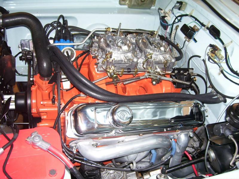

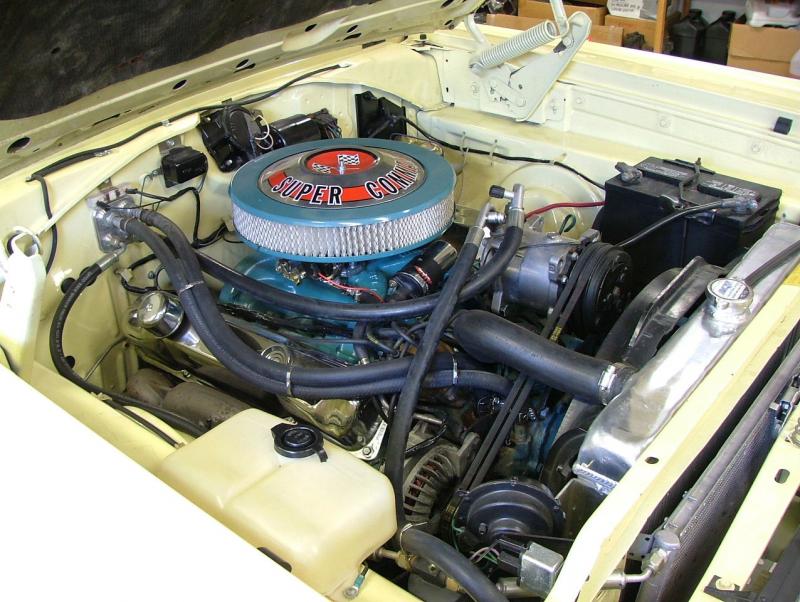

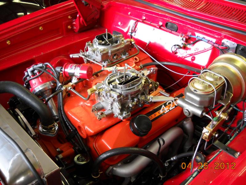

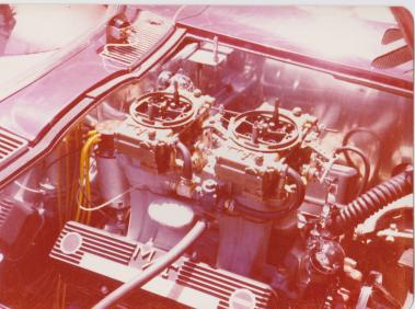

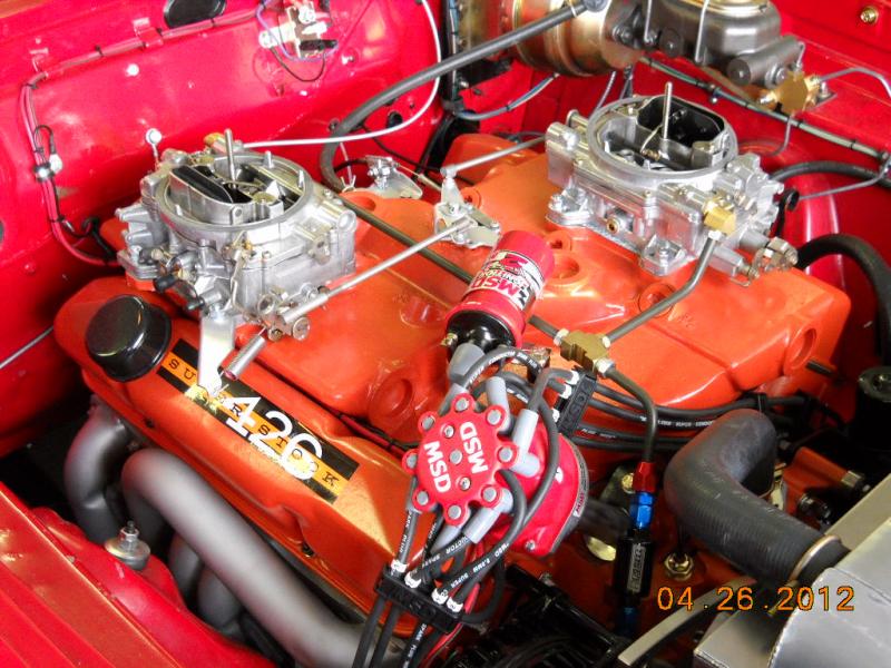

Here we go, Lew. A love fest for the Carter/Edelbrock carbs: BTW, 747mopar, I respect your opinions. I ran Holleys on all my drag cars and love them as well:
