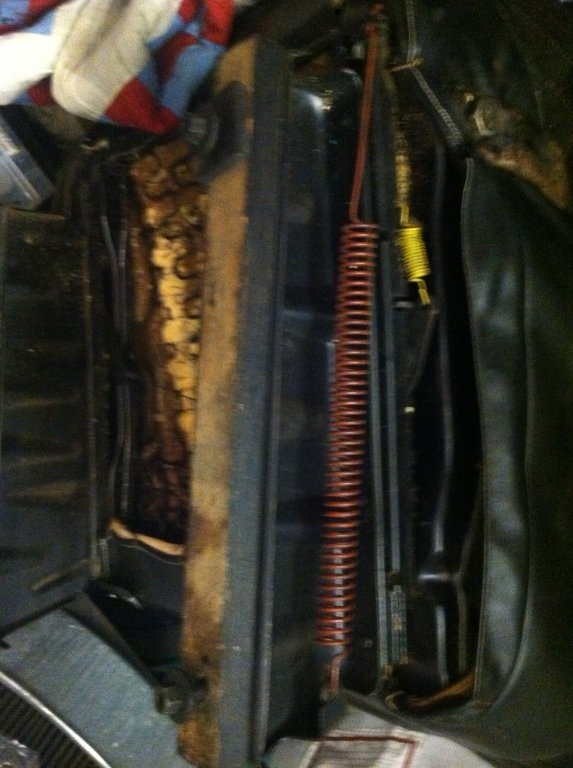

FELLOW 67 GTX OWNERS JUST PULLED MY DRIVERS SIDE BUCKET OUT AND FOUND WOOD SPACERS BETWEEN SEAT TRACKS, THERE ALSO ON THE PASSENGER SEAT ???? BELIEVE THEY MUST BE FACTORY BECAUSE THE MOUNTING STUDS THAT ARE WELDED TO THE TRACK ARE LONG ENOUGH TO ACCOMMODATE THE SPACERS ?QUESTION? HAS ANYONE ELSE HAVE THEM UNDER THEIR BUCKETS ?WHATS THE STORY WITH THEM. CRAPPY PIC, SORRY

Rrruuuhhhhh???? Last month at the swap meet I bought a pair of 67 gtx seats & a set of 67 charger seats...while both sets were pretty ratty neither has any wood..
I'M SCRATCHING MY HEAD TO, THERE PAINTED AND SANDED AND LOOK REAL OLD , AND THE WELDED TRACK STUDS ARE OEM MAYBE THEY WHERE USED ON CARS WITH CONSOLES AS OPPOSED TO A BENCH SEAT ? I CANT SEE WHY SOMEONE WOULD RAISE THE SEAT UP 1"AND ON BOTH SIDES. FLOOR SUBFRAME IS 100% MINT.GOING TO TAKE A BETTER PIC
Must be a prior owners modification to raise the seating position. No wood on mine.
I'm not as knowledgable as most of the guys here, but it does sound plausible that someone needed the extra height....Cars back then we're comfortable and roomy even for someone 6'4"....I'm guessing it was someone of a smaller build installed them to compensate..
Not sure about 66/67 (even though I have two, the seats are out), but 71-74 had round spacers.
I always take those out as I have a looong spine. One of the reasons I liked Mopars from the start!
The studs that go through the floor are extra long anyway.
My 64 Sport Fury had two piece bucket seat brackets that allowed raising, lowering or raking the seat cushion to a preferred position. They apparently discontinued this in 66 and someone was probably "T"d off about needing a bit of a raise and no adjustment - so they took matters into their own hands.
same...I had a split bench and now buckets. Kept the spacers on the bench cause it was to low. I re sprung the buckets and no need for the spacers
the best answer i ever got was the spacers were there to keep the track off the carpet that way if it got damp it wouldnt have the track sitting in it to start rusting its the best explanation i have
it just seems funny that someone would go threw all that to raise them 1" thanks for everyone's input.

1967 GTX did not come stock with seat spacers. Mid-1967 Dodge released this TSB regarding seat spacers and adjustment. Found it on hamtramck historical site, some might find it interesting...
That's interesting but did you notice the last paragraph mentions removing spacers installed during production to "lower" the seating position? That indicates some sort of spacer was there in new 67s with bucket seats.
