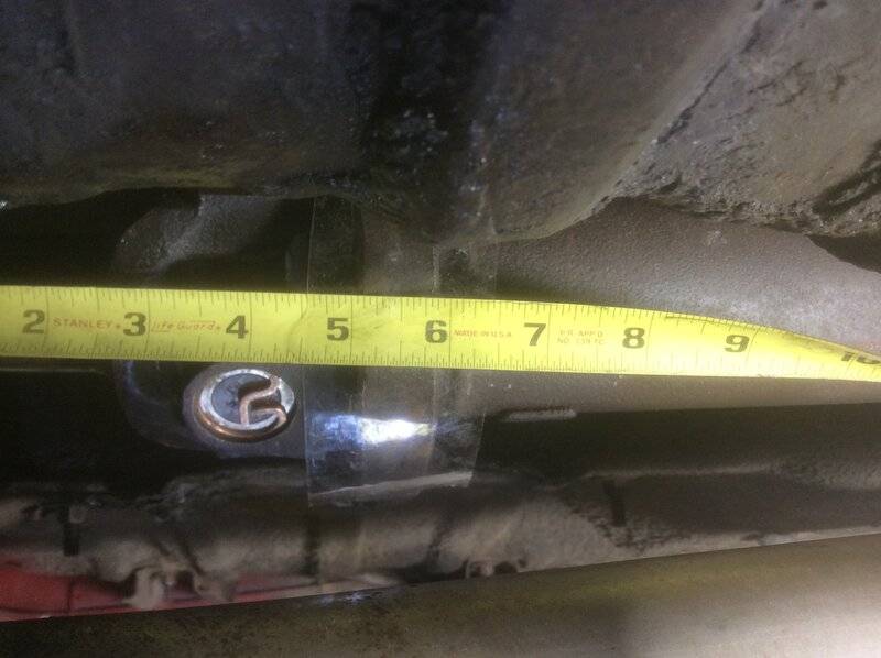

Picture of front of d shaft.

More than likely a new one will be made I was hoping the one in there was correct to work off of without measuring lol
Ok you are right 66 I keep forgetting that I do have one around and what a great source of info it really is I never thought that would be there about driveshafts but there it was looking me in the face lol low and behold I measured my shaft and indeed it is correct as far as damper they were there with certain gear ratios 3.55 and beyond just learned something today
