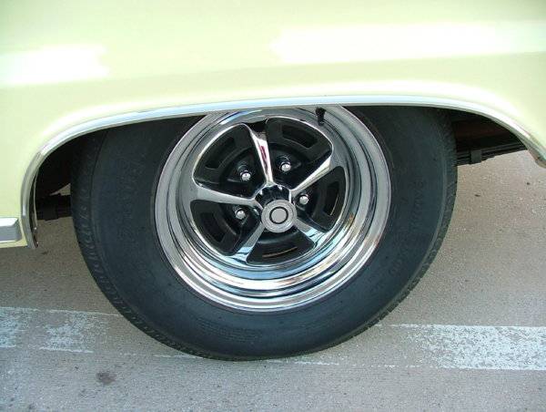

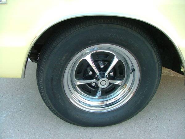

Here is mine with 215/75-15s which are around 27 inch dia.

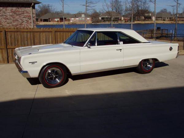

My car has 215-70-14 radials on the 14 by 6 magnums. If I were replacing them I would look at the new radial Firestone Wide Oval redlines that look like the originals but with radial construction.
