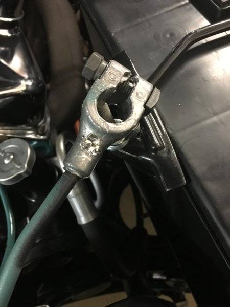

- Neg Battery Cable - more junk. I have a habit of disconnecting the ground when the car sits. This morning I grab the cable to put it on and the wire pulls out. To fix it I drilled a 1/4" hole in the bottom and got the soldering iron out. Heated it up and melted a bunch of solder in the hole.

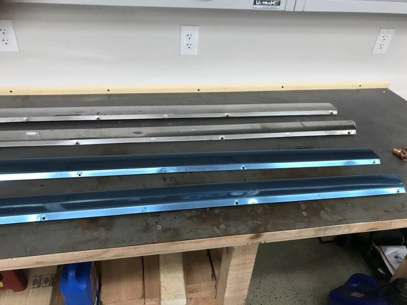

I had to make new outside rockers. Now i have to figure out where to locate the holes for the chrome trim.

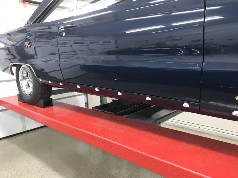

My new rockers arrived today and I had a chance to install one side. I’m going to do this in parts or multiple posts since there’s a few topics.

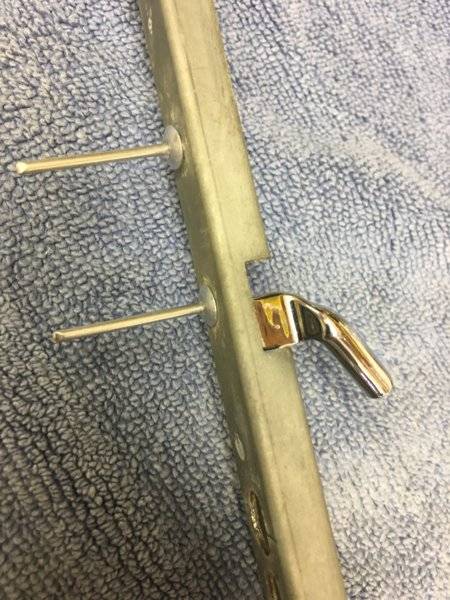

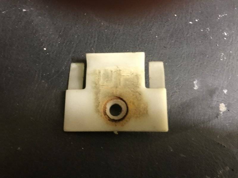

First - Clips. My original clips didn’t all survive the last 50 years. Searching online it looked everyone was out of the correct clips and the back orders were long. While I was at Carlisle in the Mega Parts tent I asked for the clips expecting to get a ‘no’ but they said yes! These clips are not exactly the same but they serve the purpose. The repops are a 32nd off for the pin and screw hole making them not install perfectly into the factory holes but it’s close enough. Also they are missing the sliders or little tabs on the side. Again, not a huge deal functionally. Mega
Parts had them listed for the 67 R/T application. They are stiffer than original also.
Repop vs original.

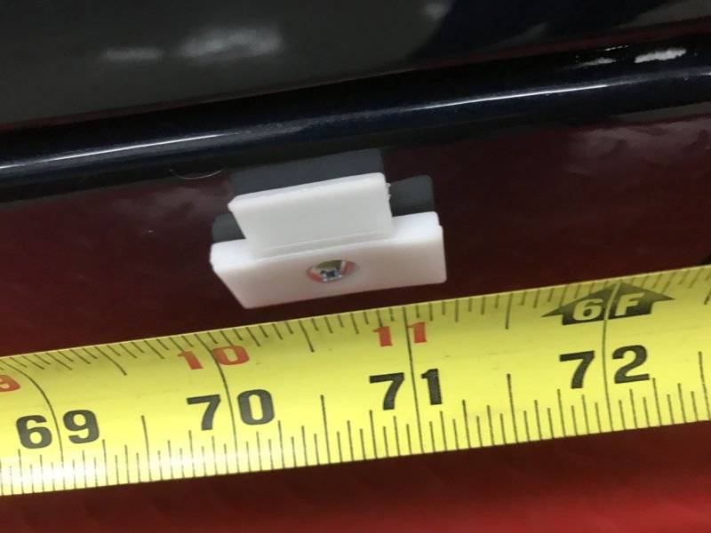

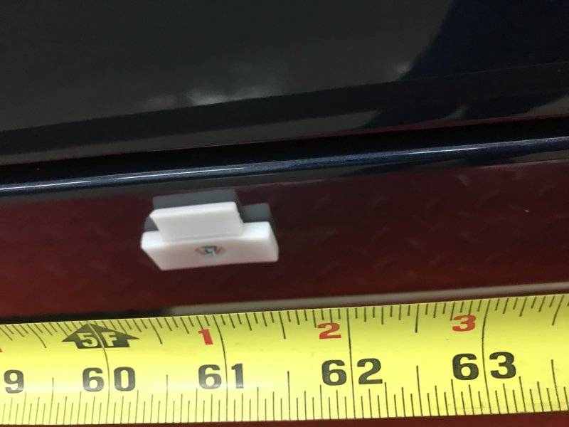

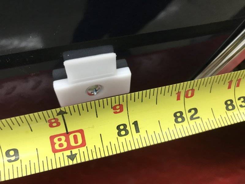

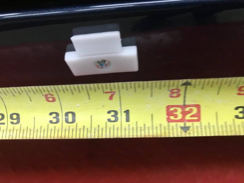

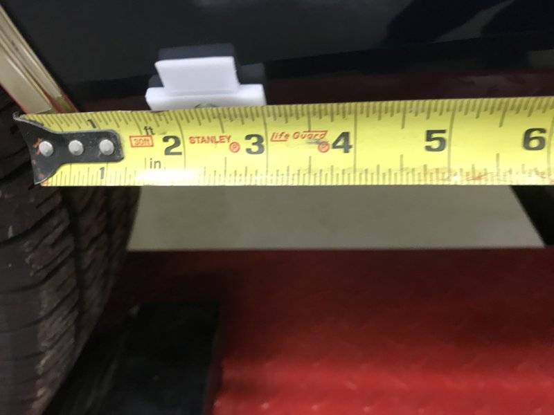

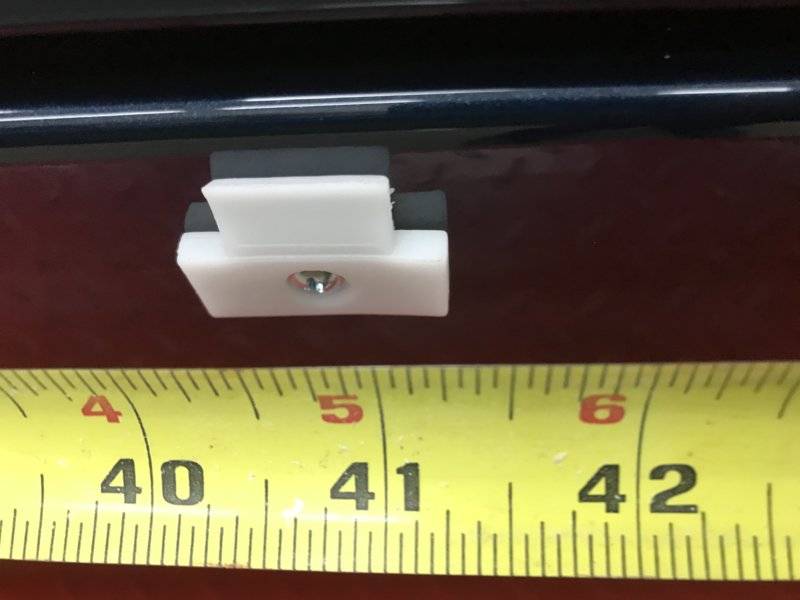

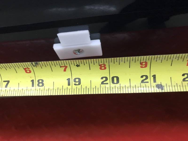

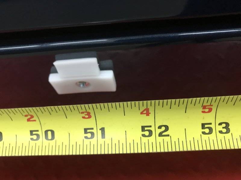

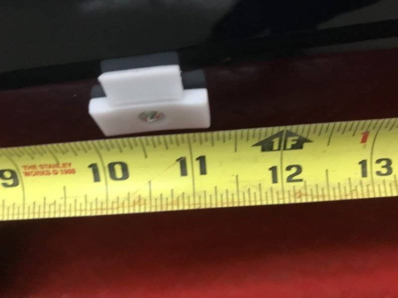

Next spacing. This is a reference post. Measuremnets are from the rear wheel well, you can see where I clipped the tape measure. I pulled the length of the rocker not moving for the tape for the total length.

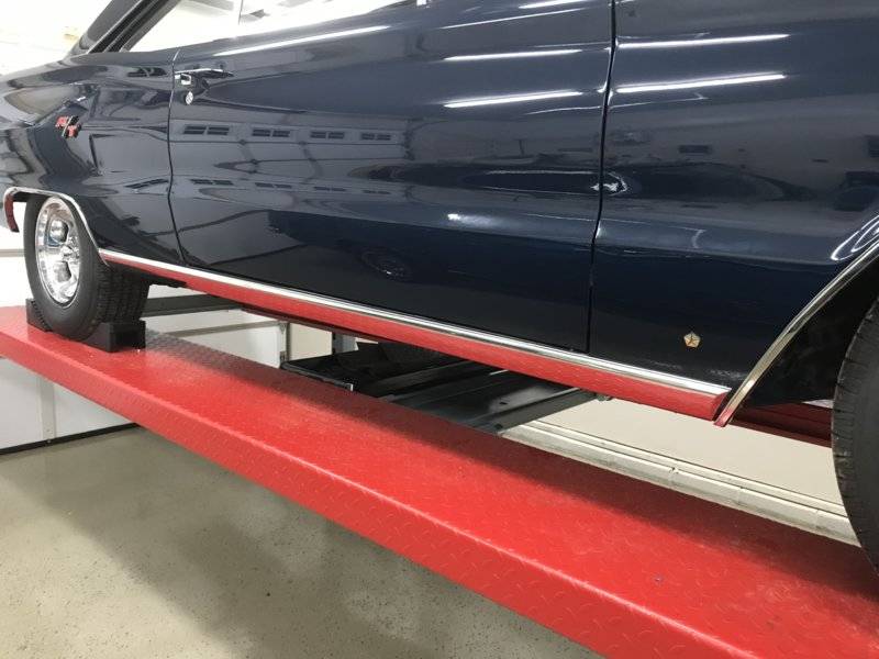

Last up - the rocker moldings. My originals exist but I couldn’t get straight enough to be happy. My trim guy wanted a boat load of hours and he said they would be perfect. These aren’t bad but they are long wide pieces to get straight. I found OER repops them. I’m not a fan or OER but they’re the only ones who make them so I had no choice. I bought from Summit and got free shipping, I think these were over $300 for the pair. Upon unpacking they look like the originals. One thing I’ve always noticed with OE vs repop trim are the sharp edges. For some reason the repop stuff is always sharp and leads to scratching, these are no exception. I will say the OE ones had some sharp spots too. These came with a few very minor imperfections, not enough I was going to send back. Overall they’re good, rate 8/10.

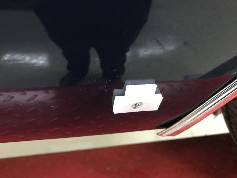

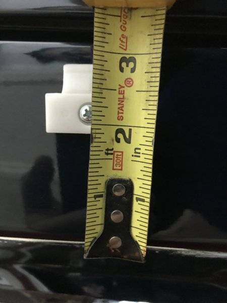

I need the vertical measurement center hole to lip
Looks like all clips are 2 1/4” from the rocker bottom.

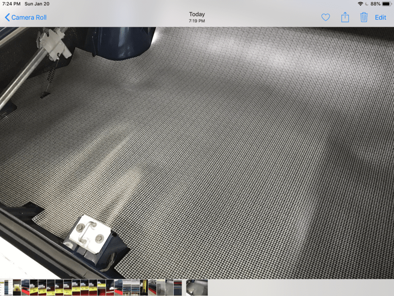

Last detail for the trunk is the mat. This car had a mat in it which I assume was it’s born with mat. The pattern was hounds tooth. The one picture is the new pattern and old original mat piece that I saved. This mat was the only one available with this pattern I could find. It was from a reseller on eBay but comes from ACC Carpets. I was pleasantly surprised when it showed up rolled and not folded. I let it lay out for a couple days before I put it in. Looks pretty good. Back of the mat is smooth and shiny, the original has a pattern, I guess you could call it that, on the back.
Can’t upload this picture, here’s a picture of the picture. Installed mat.
