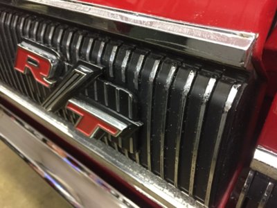

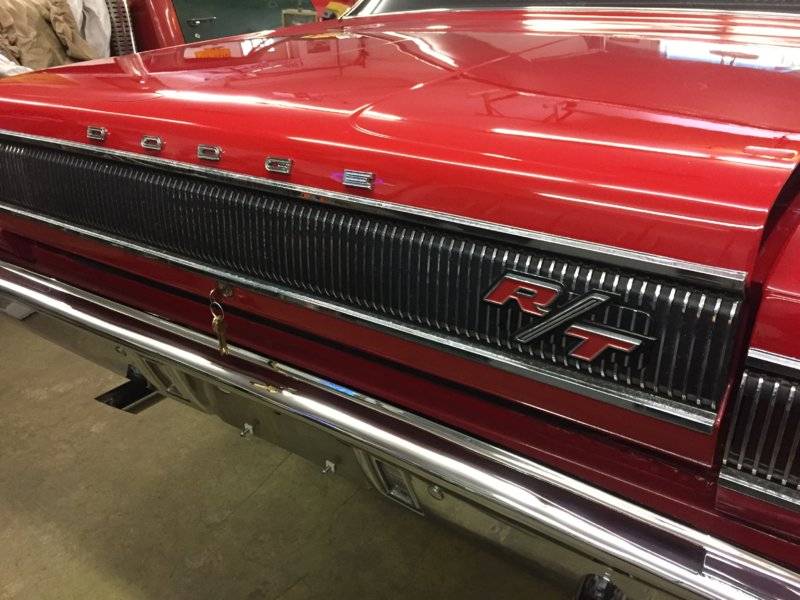

Very nice! I'm a little afraid to ask, but what kind of change to get your finish panel and taillight covers done?
Yes, be very afraid...
All were done at LiBrandis but IIRC, center was $700 and each tail bezel was $350.
When I dropped everything off it was a bunch of numbers flying around and we did haggle a bit but those are the numbers I remember.
I did haul everything out to Paul's and his pricing method was per piece. Price for just the center was over $2000 there. My total cost comparison was over double from shop to shop. This like bumpers were the same but these pot metal parts were a big difference.
Also those prices were to restore a tail panel that was 'pretty good'. Both platers commented that it was in nice shape. The worse they are the more expensive it gets.

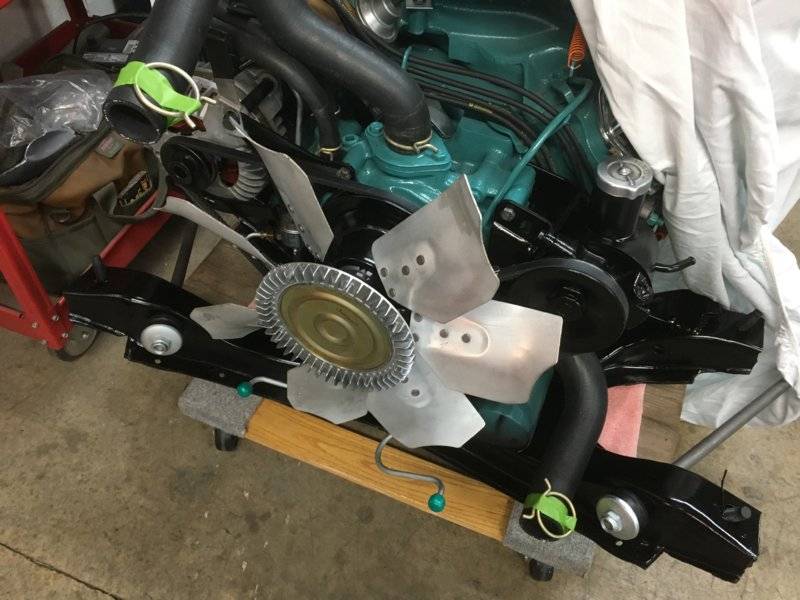

I had a couple minutes in the garage today. Over the last couple of weeks I restored the fan. This one is a steel center area painted black with natural aluminum fan blades. This is also a fan clutch setup. I had a hard time deciding what to do about the fan clutch. 1 - repaint and detail the original, 2 - find a service replacement that 'looks' close, 3 - pay $200+ for the almost correct repop. Well, I found number two after a lot of searching. This is a Carquest part from Advance a Auto for <$30 after discounts and free shipping. It looks the part, obviously not enough fins but it's aluminum in color and gold cad plated up front. For a fraction of the cost of a repop we're back in business. Belts are fresh from Rock Auto. I did the Quanta repop belts on the GTX and they were junk. They spun off at higher RPMs and I was constantly fighting with them. Late model, reliable, replacements are the route for me. Detailing on the engine is down to a PVC hose and a coil.

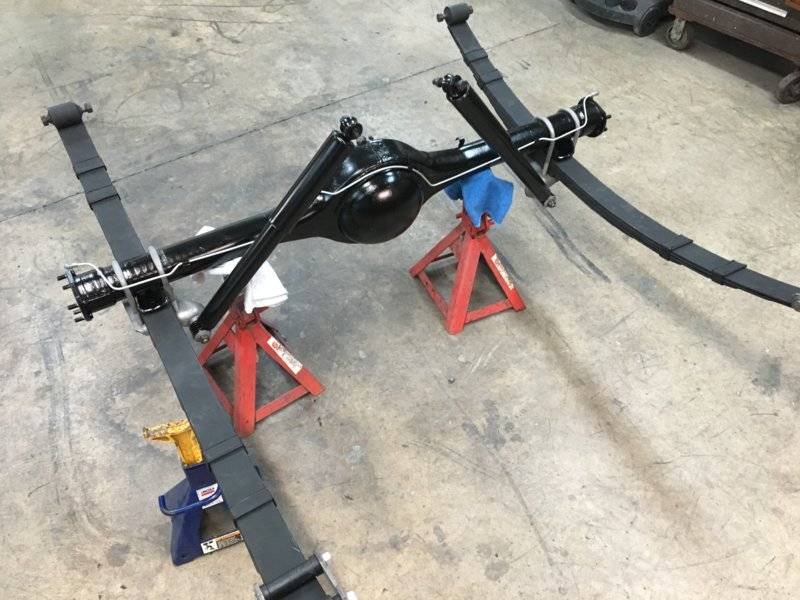

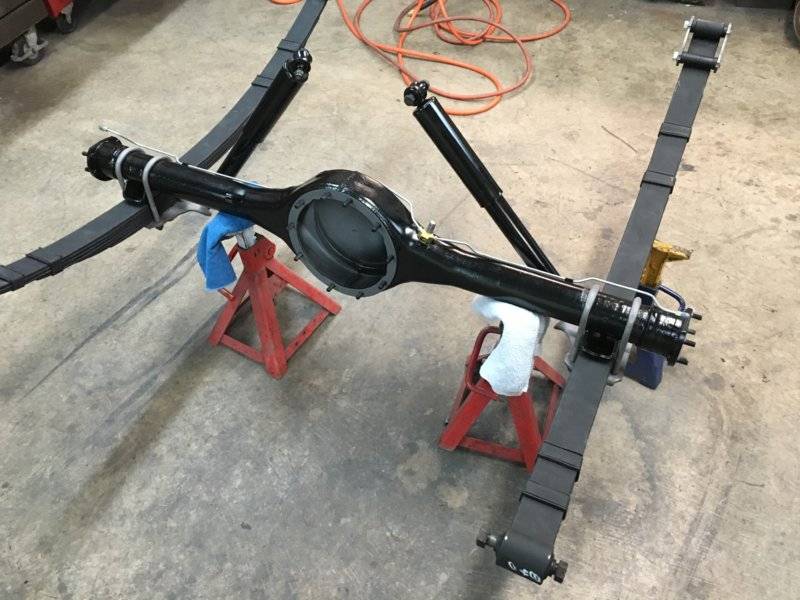

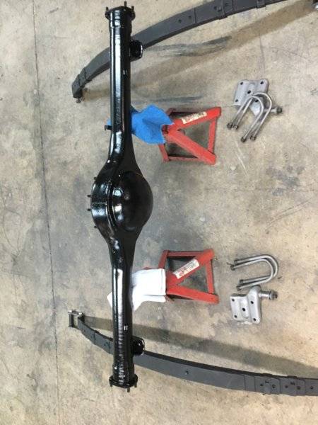

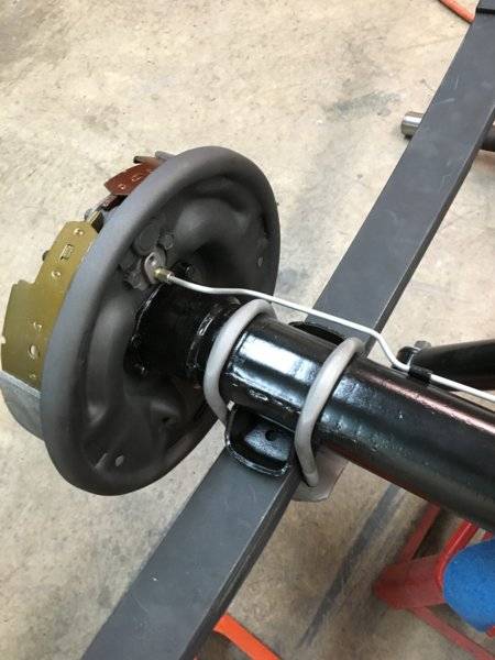

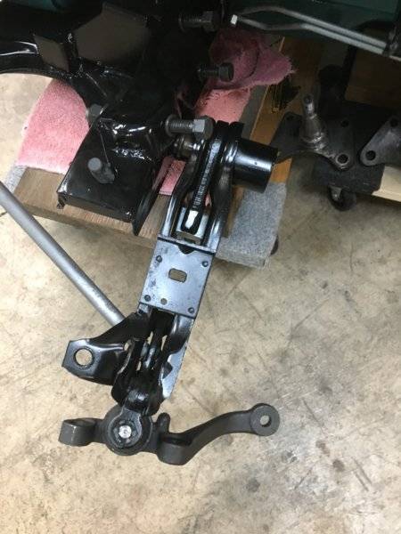

Started working on the other end of the suspension. Both shock plates and U bolts are original. Brake lines are from Inline Tube. I'm working on cleaning up the rest of the suspension and brake parts. Very dirty work. Degreasing, cleaning, blasting.... EvapoRust has been a big help too. I have some things to share on the front suspension hopefully this weekend.

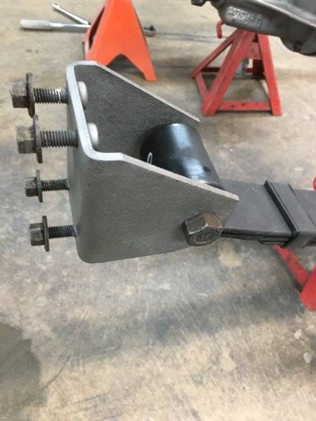

Springs are from Espo Springs and Things, these are stock 'appearance' and ride height. 6/7 leafs. Rear shackles are stock and cleaned up. Shocks are Konis that were scuffed and repainted to look like originals.

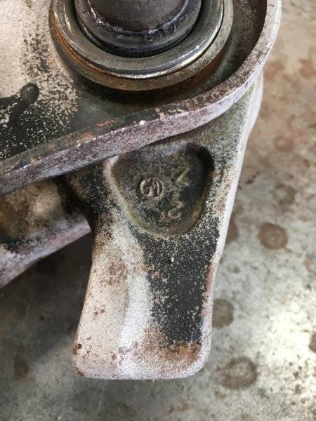

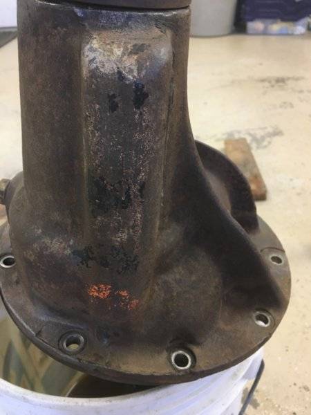

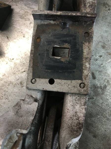

Here are some original paint marks on the rear chunk. Looks like white was applied the. Three black dots with one orange dot. 3.23 SureGrip.

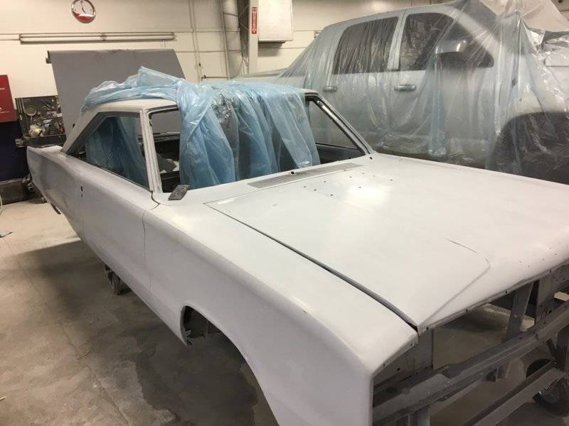

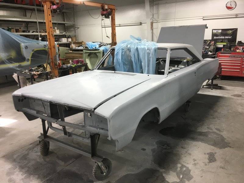

We're getting close to color. Car is sanded in 600 and ready for sealer.

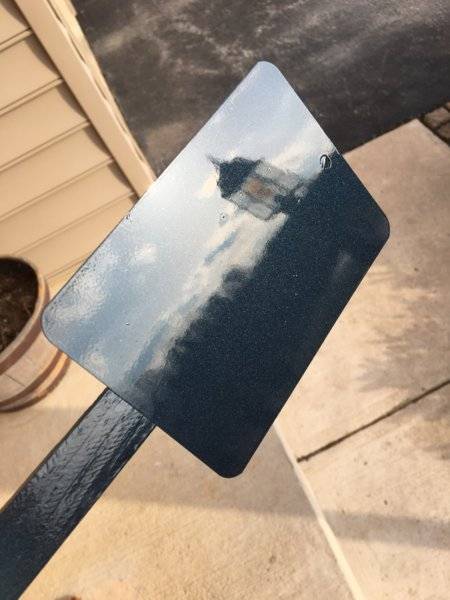

Spray outs of EE1 are done and we matched up some original paint on the inside jam of the car.

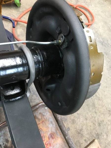

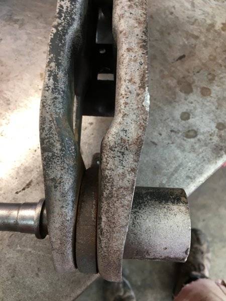

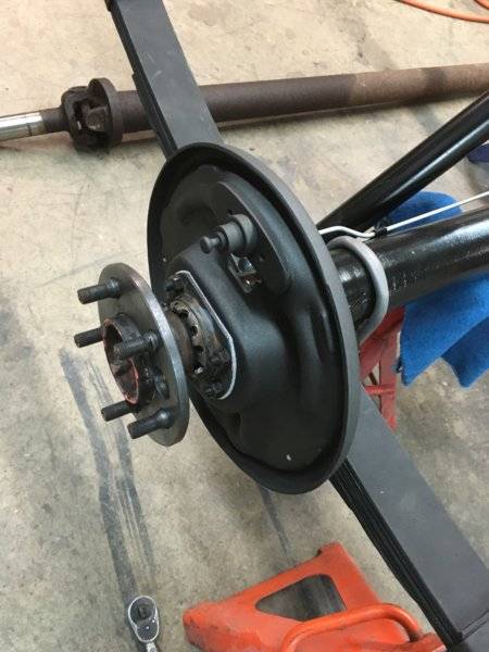

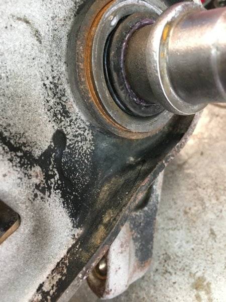

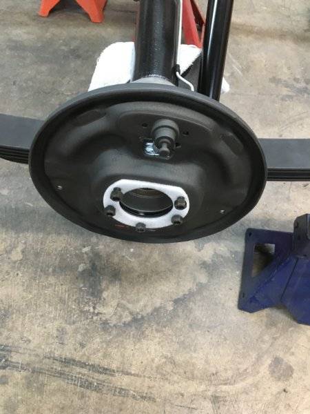

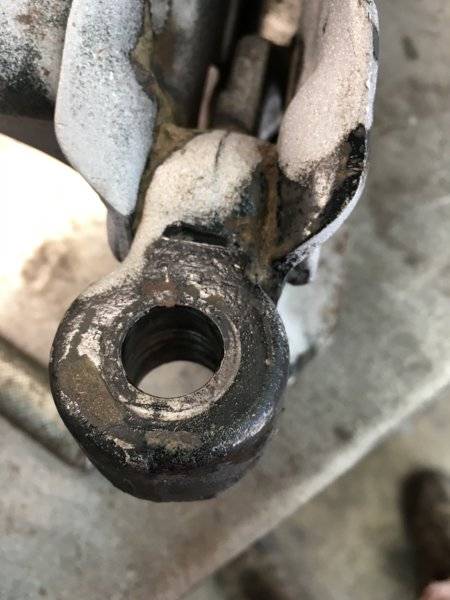

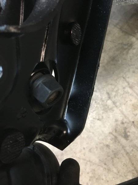

Had time this weekend to work on bead blasting and refinishing. Brake back plates seemed to have some sort of phosphate. I chose to use Eastwood's zinc paint instead of trying to get these clean enough to plate. The lower control arms on this car appeared to be painted black. I found enough evidence on both lower arms that I feel they were painted. Neither arm had date codes either. The last car I worked on was a 68 GTX and that did not have dates codes either. The rear end is starting to come together as well as the front suspension.

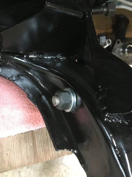

Next weekend is Carlisle, not sure what I'll get done. I do need to phosphate some hardware. Looking at the pictures I'm not happy with some of the rear hardware that was only Evaporusted. I'll be redoing that. The SureGrip tag is original, I had to epoxy it to a was since the center was all rotted out. The original 3.23 tag is there too. Pinion snubber is original and pitted but it's the original one so I'll use it.

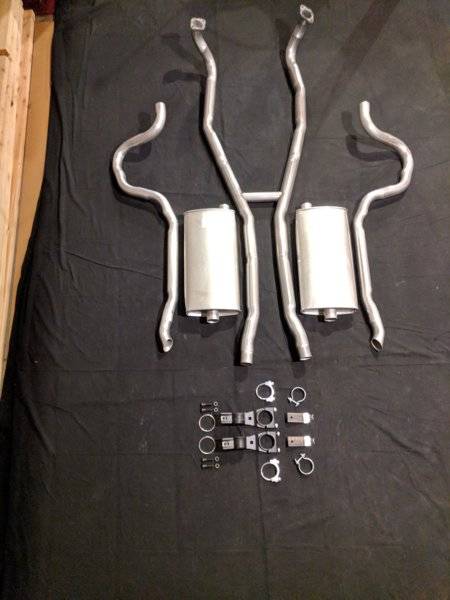

Got a day off work yesterday and spent it at Carlisle. Vendors were a little on the light side but the crowd was back with a vengeance. Place was packed. I picked up my exhaust from Gardner and other than that just a couple odds and ends. No real Mopar vendors there and only found a couple guys selling parts.

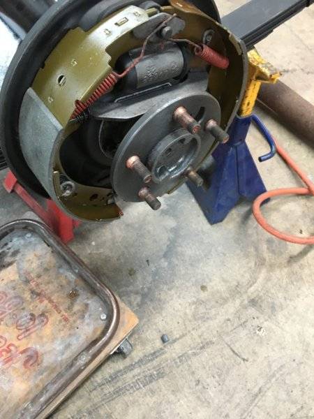

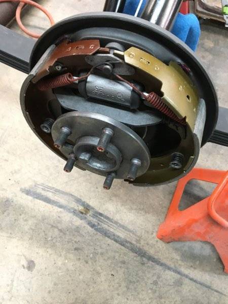

Today I was able to get my wheels cylinders rebuilt and put the brakes together. I cleaned and EvapoRust'd everything. I did not spend any time replating or painting any brake hardware. I figured since I will driving the car it wasn't worth it. Only items missing are the drums, those are now bead blasted and painted. I'll take them to Yoe Service and have Joe turn them and see how round they are. E-brake cables were not salvageable, I ordered new ones at Carlisle from InLine Tube. They should be here next week. Still need new bleeder screws too.

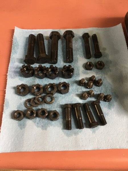

I also gathered more bolts and bead blasted them, then did the phosphate coatings like I had earlier in the thread.
