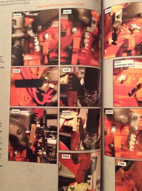

hey guys can anyone that has a 67 coronet w 440 engine take a few pics to show the correct location for the 5 plug wire separators. The phone I took the pics with took a crap and its not in the service manual
thanks
Can you "expand" this pic?

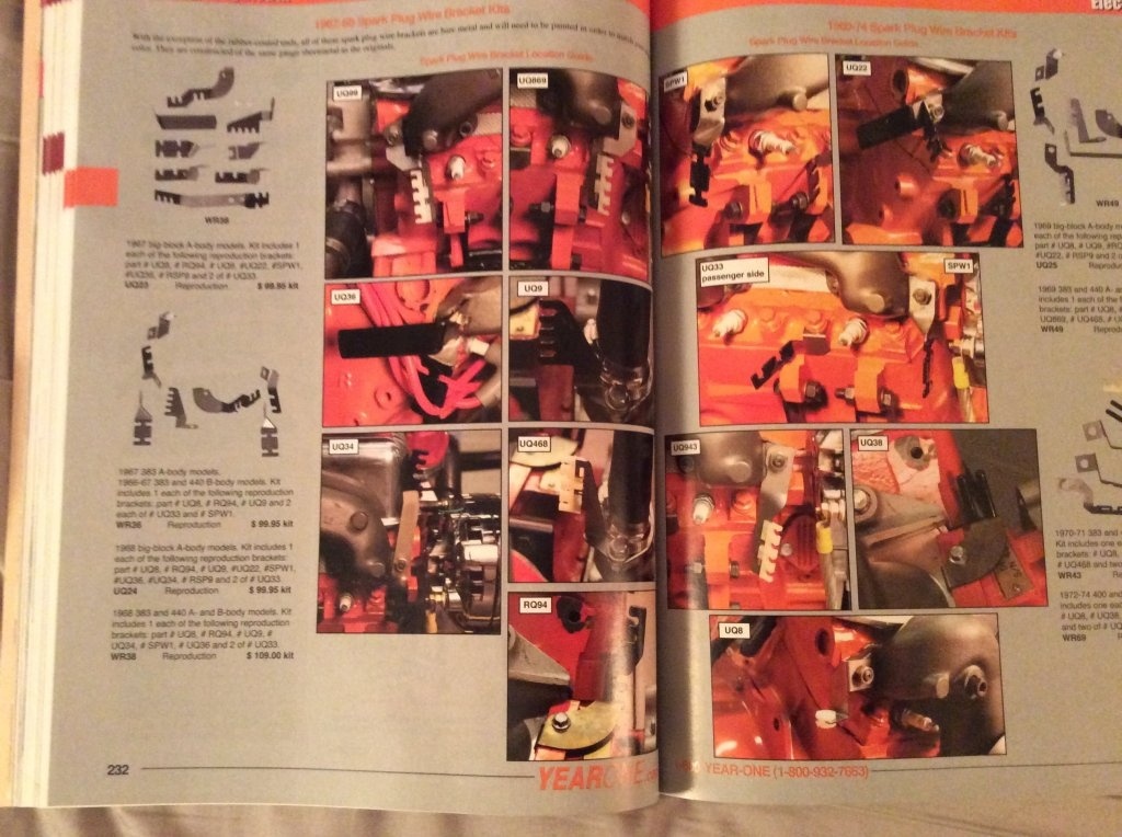

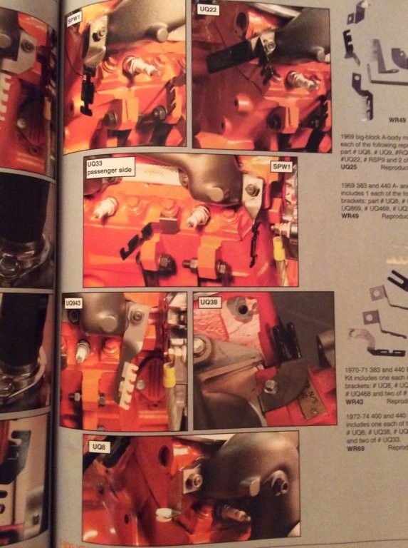

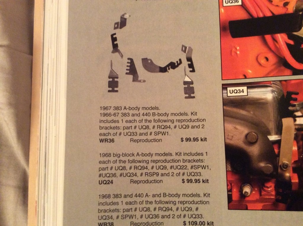

This might help if you can zoom photo's. It is from page 232-233 of older year one catolog R1111.
thanks guys that what I needed something so simple was driving me nuts. and I couldnt find a diagram any where
