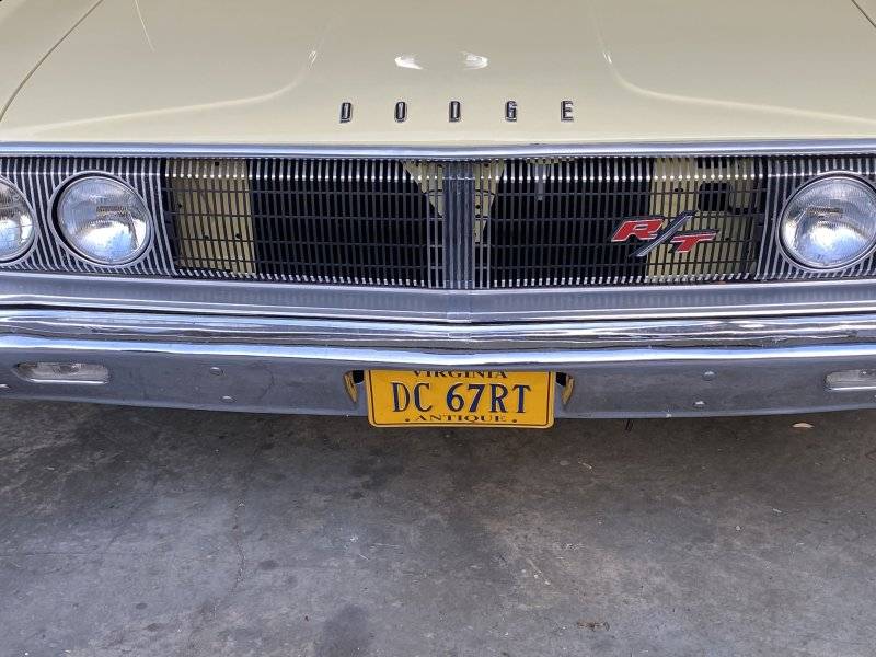

My father restored a 67 RT, that I just acquired from him, but I believe he added the wrong grill. It did not have grill when he bought it. After reading through some posts I think this is for a 500. Does anyone know if possible, and where to find the correct one for RT?

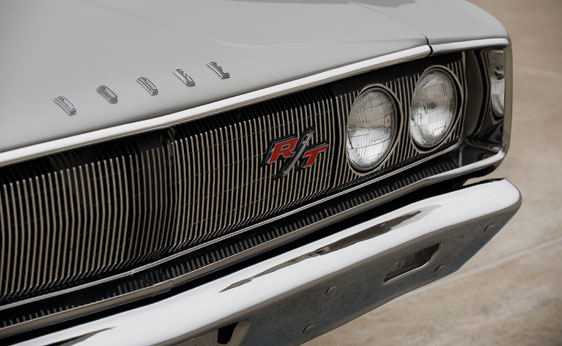

It's not right. Looks like someone painted the center portion black. I agree the white/yellow behind the grill needs to be blacked out. Luckily, that part of the grill that's been painted it pretty easy to find and not expensive like the center piece or grill surrounds. Should look like this..
Some people paint that part of the grill black. It's not technically correct but i kind of like the look.

The blacked out grill is from a Coronet 500. They also had a horizontal bar across them that joined from the headlight bezels to the "500" grill centre piece. An R/T grill is just a garden variety Coronet grill with the special blank centre piece and the "R/T" sign. The grill itself should be fairly easy to find. You could always clean up your grill with your favourite paint stripper. The blank centre piece, not so easy to find. Your rad support needs to be blacked out. This means the bottom of it, too, that can be seen under the front bumper. When looking at your car from the front, you should not be able to see any body colour.

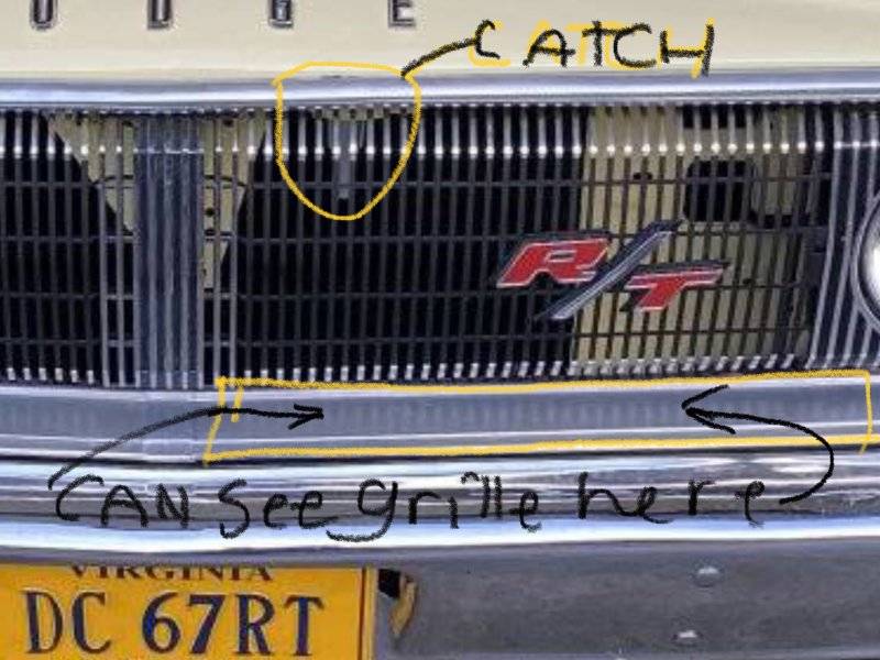

Your grille is painted black so it’s from a 500. Get some paint remover and get rid of the black paint. The metal is the same anodized aluminum under the black.
it really needs blacked out behind the grill. No body color should be seen through the grille or it will never look right. Also the secondary hood catch is a silver, when new they were a very dark brown plating, almost black. So they were not see through the grille.
lastly the surrounds are to be painted a flat silver, like a 70’s pickup truck bumper, and yours are showing a reflection of grille in them, which is wrong finish.
Welcome, your Rt looks nice, can we see more of it?
