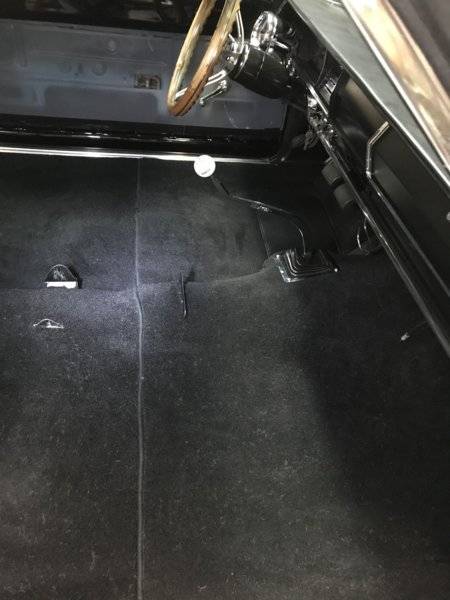

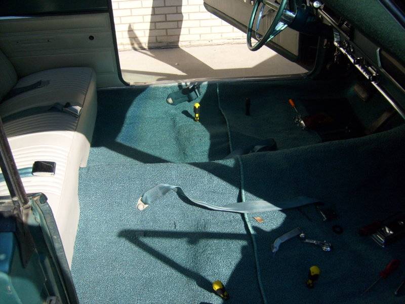

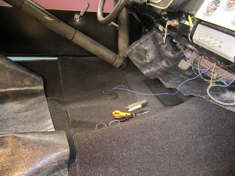

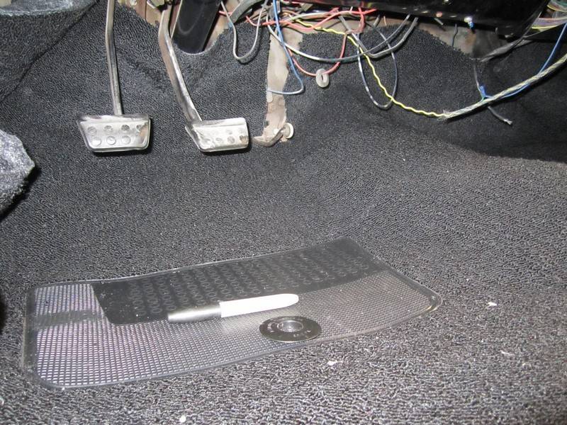

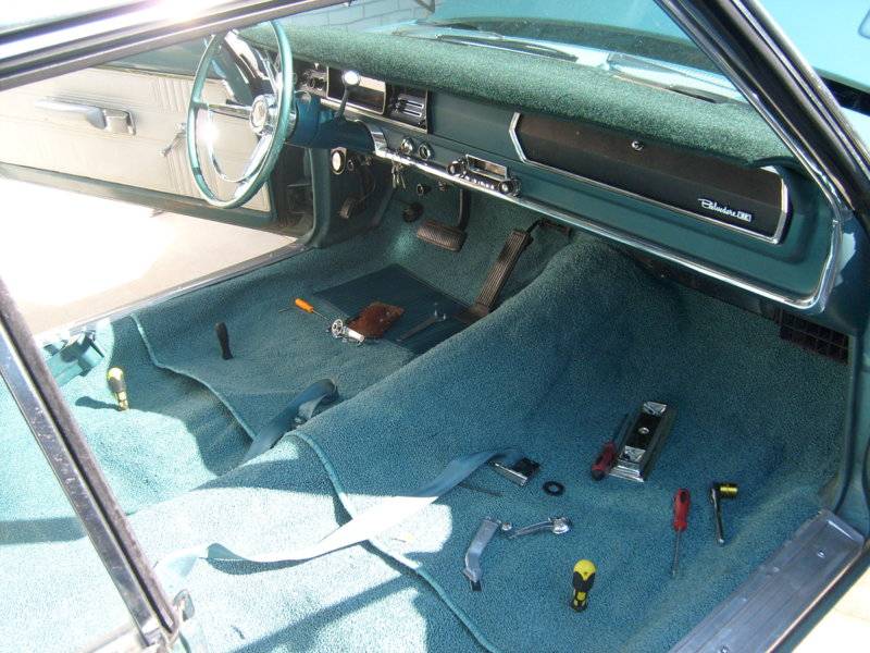

I cut out and saved the rubber foot mat area and used as a template as it was still the factory carpet. I used same template on my 66 belvedere as well as my 67. I also poke screwdrivers in seat track holes to keep in place as I am trimming. This is after I make sure I happy with placement. Just my two cents.

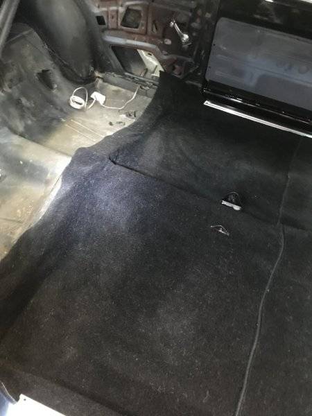

Under the door sills carefully trim the carpet so it overhangs the sill slightly so the sill plates have something to lock onto.
Slightly is the operative word. Too much overhang and it will wick up water that comes down the front door jamb (hinge side) and gets under the sill plate .
What up a screw driver/ ice pick with a torch or heat gun to poke holes for mounting holes to seat frame, console,shifter ect. It will melt the carpet instead of fraying it.

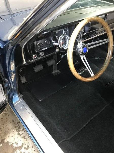

I just had a carpet replaced by factory because heal pad was in wrong place. I don't have new yet but it should fit better I hope. If it is not correct call about it and tell them why. I sent pictures along with my complaint. Vhf
Your pics were very helpful,but could you give me another view closer of the underside view of the dash both sides of the trans hump for verification,thanks

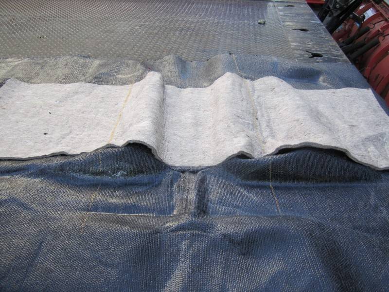

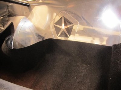

5.19.12 007.jpg 5.19.12 039.jpg 5.19.12 041.jpg 5.19.12 042.jpg 5.19.12 043.jpg 5.19.12 047.jpg 5.19.12 048.jpg 6.12.12 014.jpg 5.20.19 036.jpg
