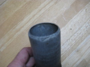

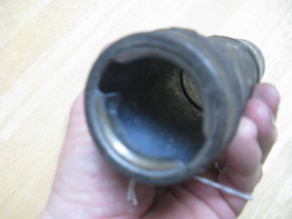

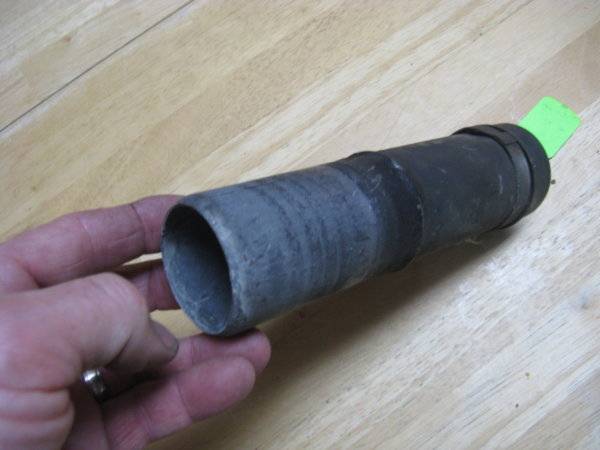

I have a nice used 68-70 B-body except Charger filler neck $35 plus shipping if interested...

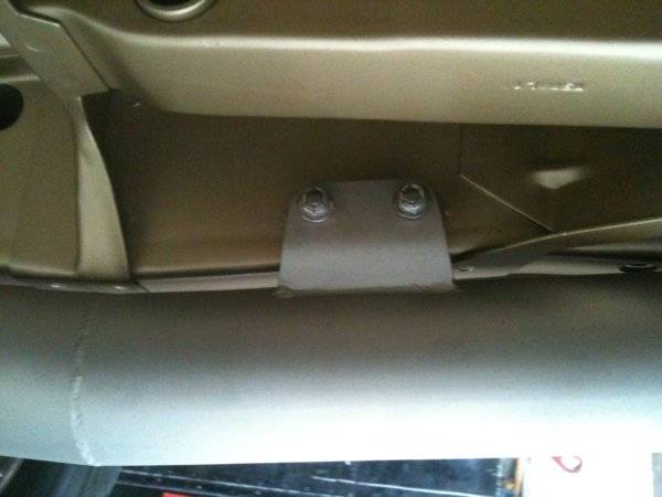

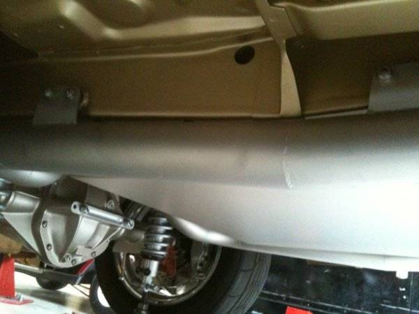

These are of a mini tubbed '67. Unfortunately I only have these photos.
Stanton,
When you minitub, you move the tubs into the frame rails and the springs then move directly under the frame rails. In a 66-67, the spare tire well basically runs from frame rail to frame rail as well as the gas tank, so when you minitub you run out of real estate to put the exhaust out the back. In the 68-70's, the spare tire was moved into the trunk, a flat trunk floor was used and the tank was narrower and longer. There was sufficient room to run the exhaust between the tank and frame rail as that was the standard routing for the 68-70.
I know I have some other surgery to do to the trunk floor, but I like the idea of more of a factory type look...even if it really doesn't match the year.
The one you have shown above is a coil over car.....it takes care of the issue where the exhaust and the leaf springs need to occupy the same territory
