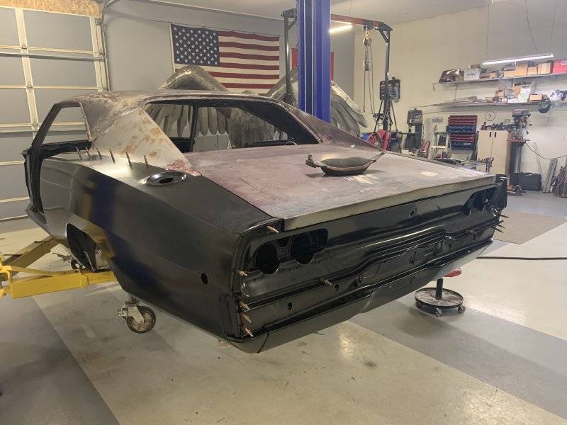

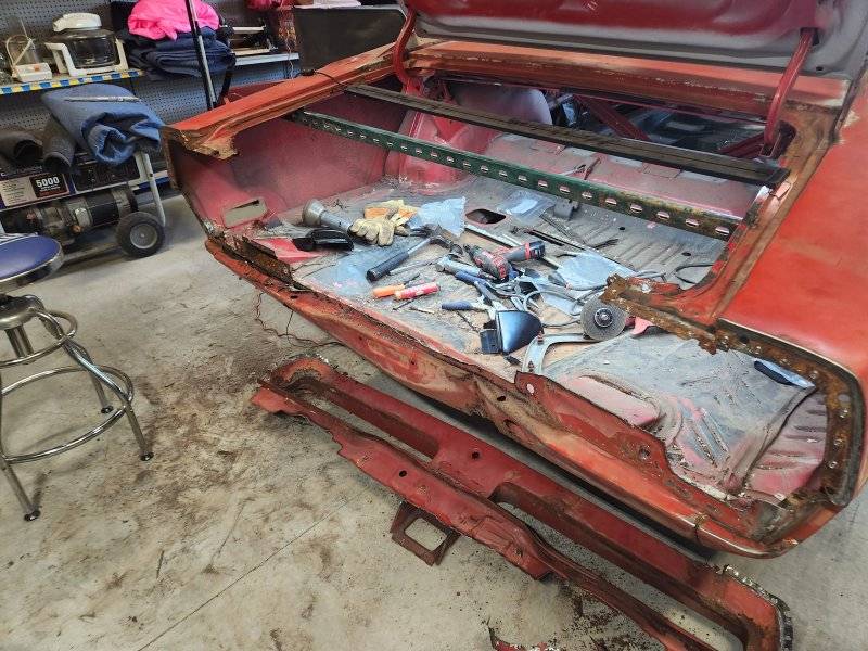

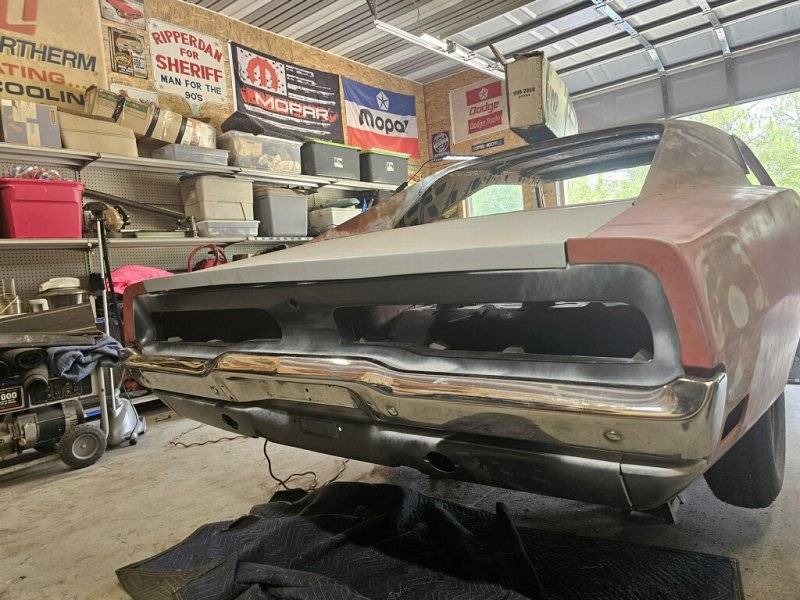

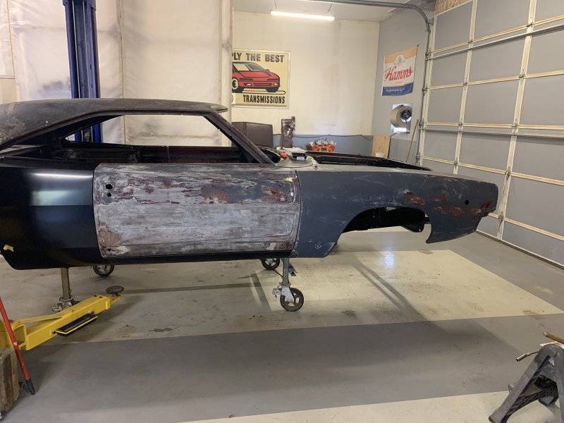

I am replacing the tail panel and valance too, so thinking now skins only wont work at the aft end where they meet.
Does the full quarter, tail panel, and valance make the entire outside corner? Is there another part in there? I can not tell mine is pretty bad shape
on one side and the other side is missing.
EDIT: I found the AMD valance end caps
when doing your quarters make sure you do your outer corner caps before the lower valance. Almost impossible to weld to quarter

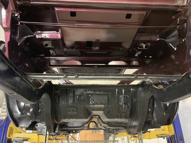

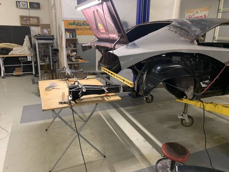

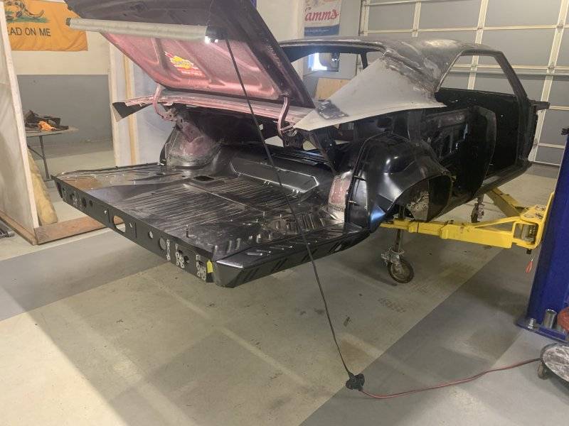

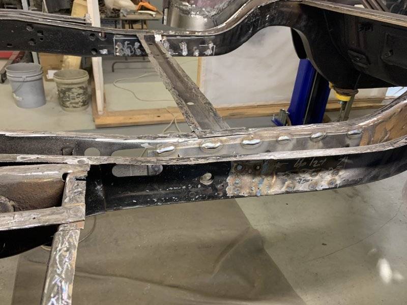

Making good progress, frame rail ends blasted, primed and tacked on, stiffened it up nice attaching the trunk floor with a bunch of clecos and some screws drilled up through the bottom to mark all the flanges.

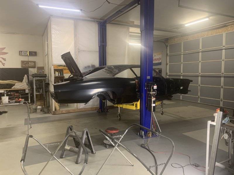

Pretty happy with the first test fitup of a panel, the overall length is right on, lines up everywhere fairly good so far

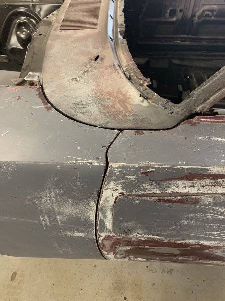

Well I am gonna need to hang the doors before I get too happy assed carried away. They are going to need some work first.

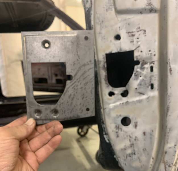

My first trial fitup with a new set of hinges went better than I expected, this car was never wrecked apparently. Everything is lining up real good.
Next step drill a few hundred holes and weld er up

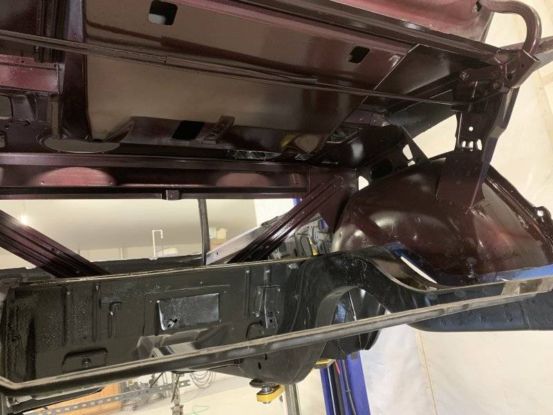

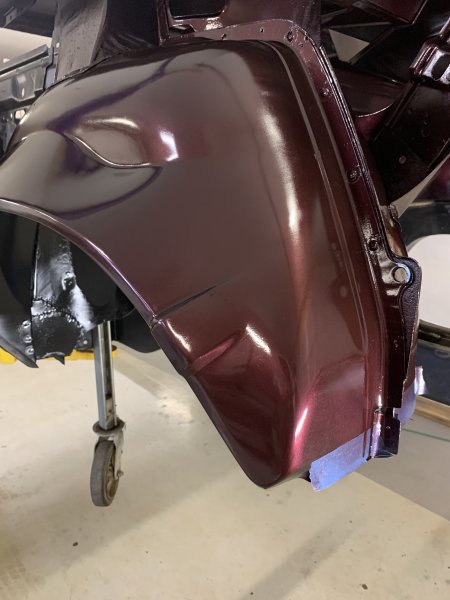

Good time to prep/paint up in here before the floor is welded in
Haha no thats not a reflection, I missed a big spot, right above my head where I was standing. I will get it on the next pass!
Beautiful color, I love it when people go with outside-the-box paint colors instead of the ever-so-common original choices. Can't wait to see the body painted that color.
