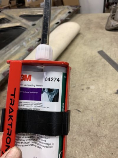

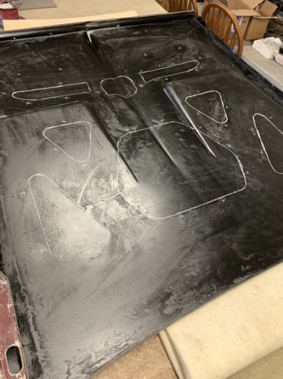

Getting everything banged out and patched, took the hood apart and found a big mouse nest in there. It only took me 45 minutes to drill it apart which was less time than I spent deciding if I should do it or not. Glad I did now all the urethane cushioning is dried up and gone, needs to be replaced.

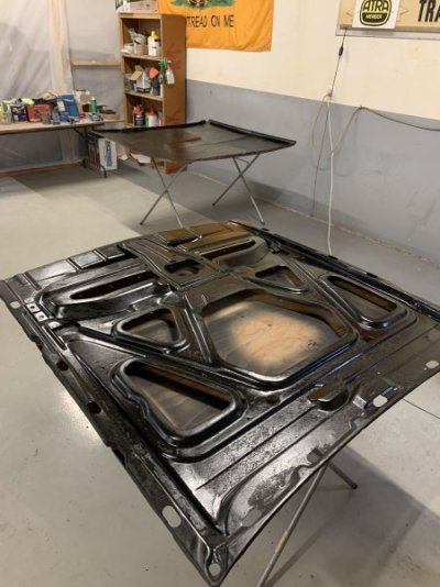

Put the hood back together after I cleaned it up and epoxy primed, replaced the urethane foam dampening gobs and welded it back together.

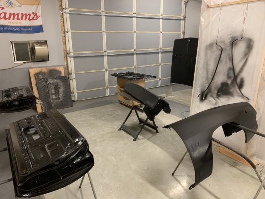

With the metal work patched up and hammered out the best I can get it, I sealed it all up with epoxy yesterday. Had just enough left to do this, I used 4 gallons so far on the shell and suspension parts.
