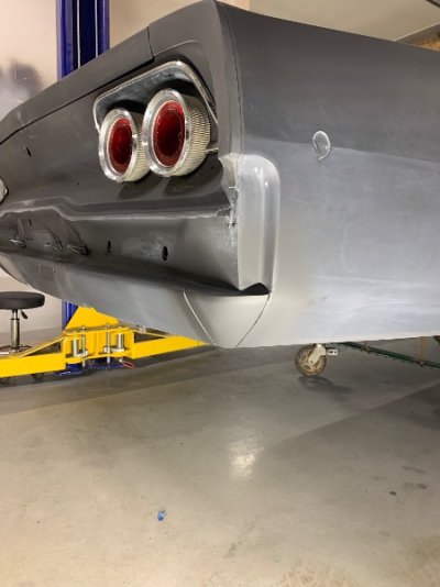

So this is the last of the body panels needing work, with the exception of anything needed after it is all together. All the dampener gobs between the halves was rock hard so after years of boxes of crap being thrown on it there is a little protruding dent where they were. Like reverse hail damage. Along with the rest of the normal dents from throwing stuff on it. I am going to hose it down good with a couple heavy primer/surfacer coats before I add any filler.
My bottom door gaps were fairly wide and uneven so I welded extensions on the doors and filled with epoxy. Now they are 3/16 and even. Taking my time finishing up the body work, dont want to rush things at this stage.

Yeah exactly, now that it is all together I can look at it and grin while I work on other stuff I have been putting off
How is your gap between the trunk lid and the dutchman panel? Is your dutchman is original? I have an AMD dutchman with an original trunk lid and the gap looks too wide at about 1/2".
I would slide that lid forward to a happy spot, and make the correction at the quarter extension........looks like the lid can easily give up an 1/8" sliding forward
Thanks, what would be a proper gap? I lost some of my pictures of before the teardown and can't find any for reference.
I like 3/8 (11/32?) hood to cowl and trunk to dutchman..........it has to have room to open...... other factors such as fender or quarter length also affect fit
Sorry I didnt have time to answer you yesterday, the gap on mine is on the tight side but it clears, as Dubb said 3/8 is fine there. You can also build up the edges a little with a wood form that has clear packing tape on it so it wont stick.
The shell is basically done now, final sanding and a paint job away from the first peel out, but that will have to wait for warmer weather. I have plenty of work to do restoring the rest of it.
