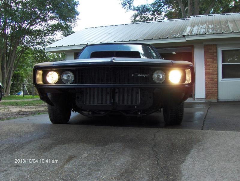

installed to original interior,still need to get carpet,headliner,package tray & seat covers,but now all my screws are where they are supposed to be, so when i do replace that stuff i wont have to dig through my BUCKET OF BOLTS to find the correct screws yesnod the rear window is just sitting there i still gotta do the body work around it.
It's no wonder I love these cars, no other car can compare to the lines of a Charger. Sweat pics
Wow! I love the pictures from the front! MEAN looking. Love that scoop to!
I may have to think about putting that on my hood!
I am jealous!
