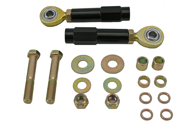

race craft bump steer kit for rack & pinion,now it has very little bump steer & turning radius is lock to lock

I LMFAO, thanks for the tip on the Racecraft bump steer kit model #33206 for the Rack & Pinion...
  • Racecraft Bumpsteer kit model # 333206 79-93 3.5 OEM Mustang style kit for Unisteer rack & Pinio.jpg
