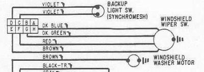

68 Coronet, was 318 w/904, now 833.
Can I just clip the two VIOLET wires on the steering column switch that were for the 904's backup lights and run to 2 prong switch on 833?
I've Googled this topic and came up with diagram below, but I would have to pull the bulkhead connect out on the engine bay side in order to access inside. Can't get at without pulling the heater assembly.
