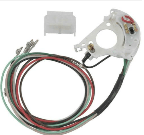

would this be that switch? This is what I saw, the gold plunger is the horn switch, its got a short spring behind it.... And I believe that's the dark green wire feeding the rear driver side blinker.... Anyway maybe this will fix the "no brake light issue".

The photo of the turn signal you provided is the good one with a roller for the horn.
The pin type aren't the greatest and need frequent lube or they start to squeak when turning the wheel.

I noticed that's what is current in the steering column. In looking at the wiring diagram plus chats on here, I didn't think to test anything inside the column. It all appeared in order. I will try to take it all apart as the new turn signal piece should be here next week. I'm thinking when the previous owner replaced the white plastic turn signal piece, something must've came lose or broke. One of the previous owners removed the quick disconnect at the bottom of the steering column, butt connecting all 7/8 wires. Now I can't even remove the steering column without cutting the wires. So I have new connections coming to make this process easier should it need to be done in the future and a little cleaner looking too.

Well thanks to all for your input. It was the turn signal switch inside the steering column/horn area. If you don't know but there are several plastic pieces with a paper gasket and several small strands of copper lines. The copper lines make contact with several of the wires feeding this switch. And when you push up or down with the signal arm (left/right signals) small pieces make contact with the copper wires, making a connection and lighting a bulb for right or left turns. When mine was selected for left turns, the copper connections were so worn out, it was providing no contact. In wiggling the contacts, I have a left rear turn signal and the brake lights lite up.
Now I am waiting on a new turn signal switch. Thanks to all who assisted and offered advice. Be safe, Henry
New switch is in and everything works as it should. Thanks again!
