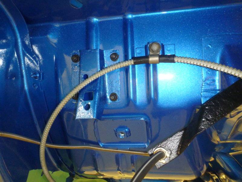

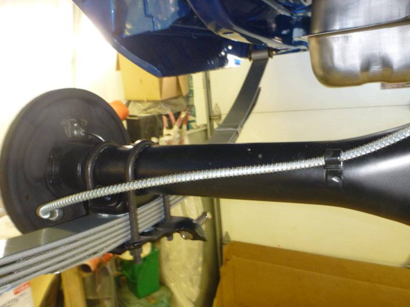

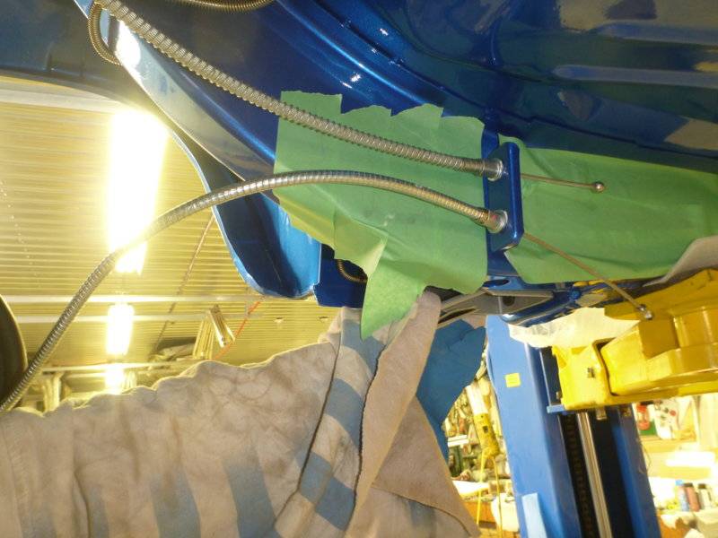

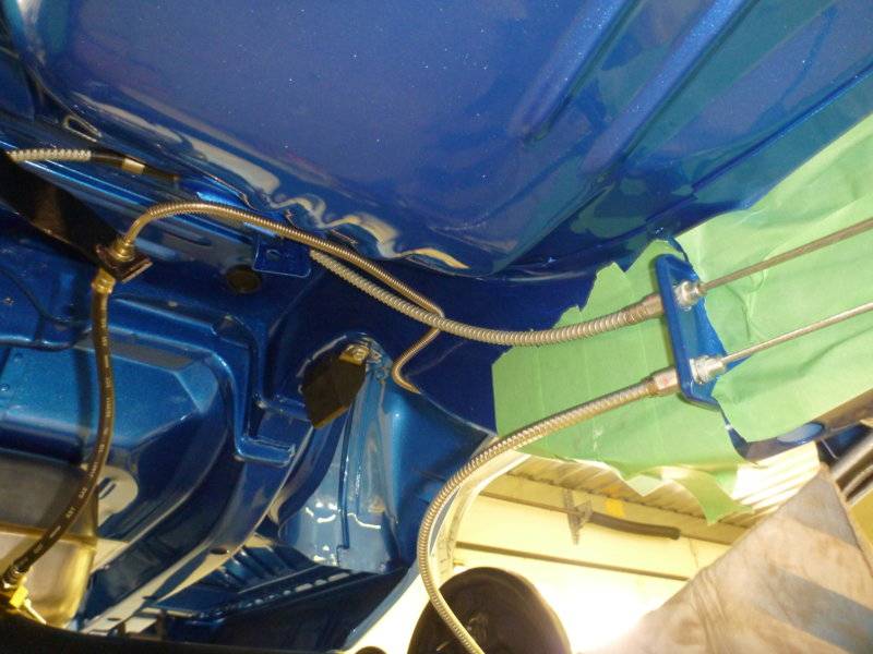

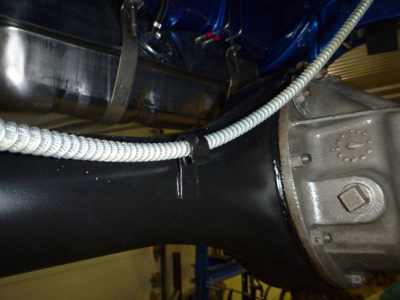

E brake cables were off of my car and missing when i got it so i am looking for a routing diagram for them. I found pics on here for 71 and later cable routing but they look different than mine. Anyone got pictures? thanks
I saw those pictures on page 13 of your post. I have the cable through the firewall and everything you show there to the splitter. From there i am lost. Any pictures of routing after the splitter?
Use the restoration tool on page one it will be under brakes or suspension....the other two are from the left and right drums......the length should be easy to figure out based on location...
Here you go. A Factory Service Manual (FSM) purchase or download would be a good idea.

ok perfect pictures. thank you. I see i am missing that bracket that holds both cables to the frame. ebay?

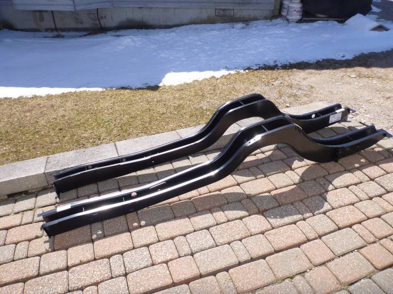

Might have to get it from a salvaged parts guy, it's welded to the frame assembly when they make the rails... so not sure about anyone selling it new on it's own.
Maybe @crank or @Moparsal would have what you need.
