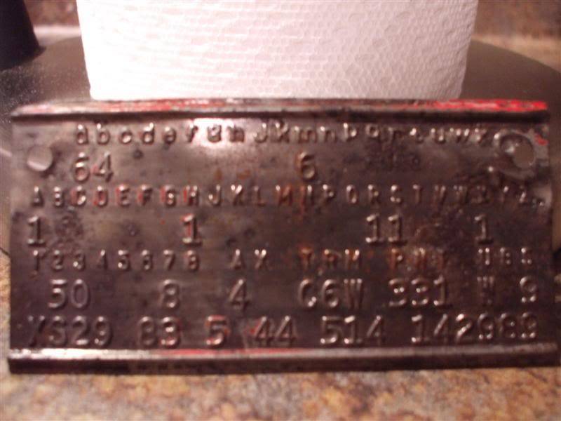

Hi everyone, good to be here! My son and I recently bought a 68 Coronet RT. The fender tag and VIN tag look to be original, and everything on it adds up for an RT..... except the 22 inch rad it has. Its got a 22 inch rad and rad support. My research says these cars left the factory with a 440 and a 26 inch rad, so I'm wondering what's up with mine. I have found pictures of 440 RT cars for sale with the same smaller rad. Should I be concerned about owning a possible 383 car and fake fender tag, or did some RTs leave the factory with 22 inch rads? Comments please? Thanks!

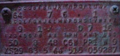

I do know all air conditioning cars left the factory with the 26" radiator max cooling option. Look at your fender tag second line from the top. under the capital letter A, there will be a 1 under it if the car was optioned with the 26" radiator. Not all 440's or big blocks in general had the 26" option. I've seen plenty of Charger R/T's with the 440 and no 26" radiator and a few Coronets myself. Here's a coronet from 68 without it. Second pic is a Charger R/T without it as well.
Here is an example of a Charger with the 26" coded on the tag. Under the Capital A there is a 1.

Awesome! It was a 3:23 car, and another poster mentioned the 1 under the A on the Fender tag specing that HD cooling option. :)

Looks like you have a qq1 blue R/T with blue bucket seat interior. 8 3/4 rear with 3.23 gears. Stripe delete car?
Look around for a build sheet. Check under the rear seat between the springs and seat foam. If not there, maybe take off the bucket seat backs and look there. That will give you more info on your options.
