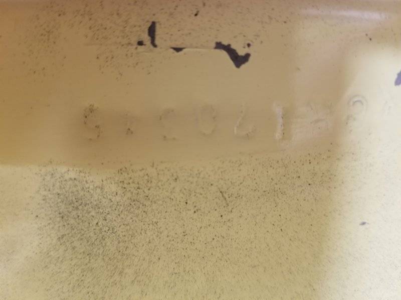

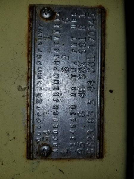

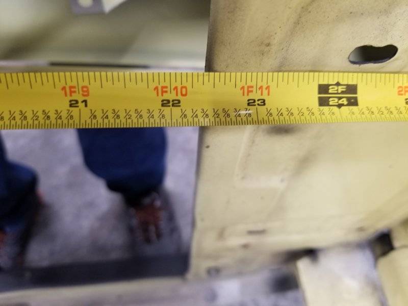

my gtx has A1 option shows 26 inch radiator. However the opening is for 22 inch all factory spotwelds are on core support. The stamped number on core matches fender tag.
LOL, I have the opposite problem, my Coronet has a 26" opening & the A location is blank.... And the VON on the FT matches the cowl & trunk lip.... Gotta wonder how many others don't match... BTW my car built nearly three months before yours so it's not like the new guy screwed up both the same day...
auto, non A/C? ......... now I have to look at mine lol
That's how his tag reads.... But since it shows a 26" radiator who knows what else it does or doesn't have....... J/K
I just dont see a 22" opening for a 26" radiator. The opening on my 68 RT matches the 26" radiator. Why would Plymouth do any different?
RS23L8G187xxx
One must consider all possibilities including a badly remade fender tag.
Go back and read post #1 and tell me what don't look right.
Why don't you just tell us.... It looks fine to me.... Though I would agree with Doug about it possibly being a repo tag
no paint on the fender tag, not even a spec in the nooks and crannies of the stampings......its in really good shape too.......
again...... auto, no air?
