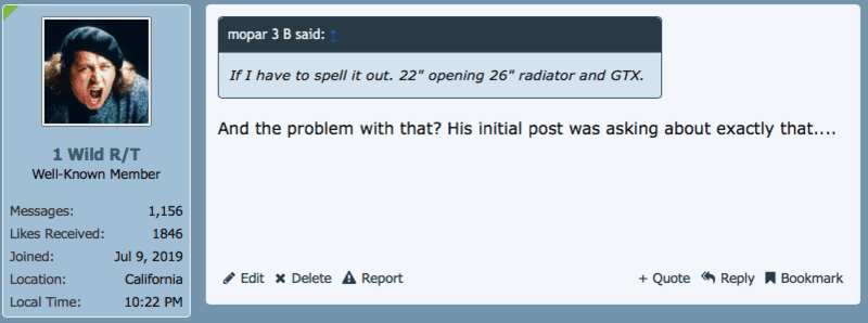

    And the problem with that? His initial post was asking about exactly that....

            You ask allot of questions but you don't seem to answer many....

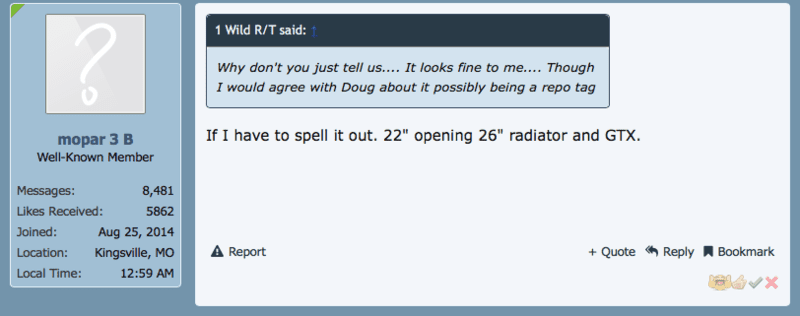

              Well it seems to me with a post like this.... Screen Shot 2019-11-29 at 11.00.28 PM.png
              It sure seems like you think you know something so lets hear it....
              I've never claimed to know it all, but I've done this a long time & know a little... And I'm willing to share, trying to help & inform others....

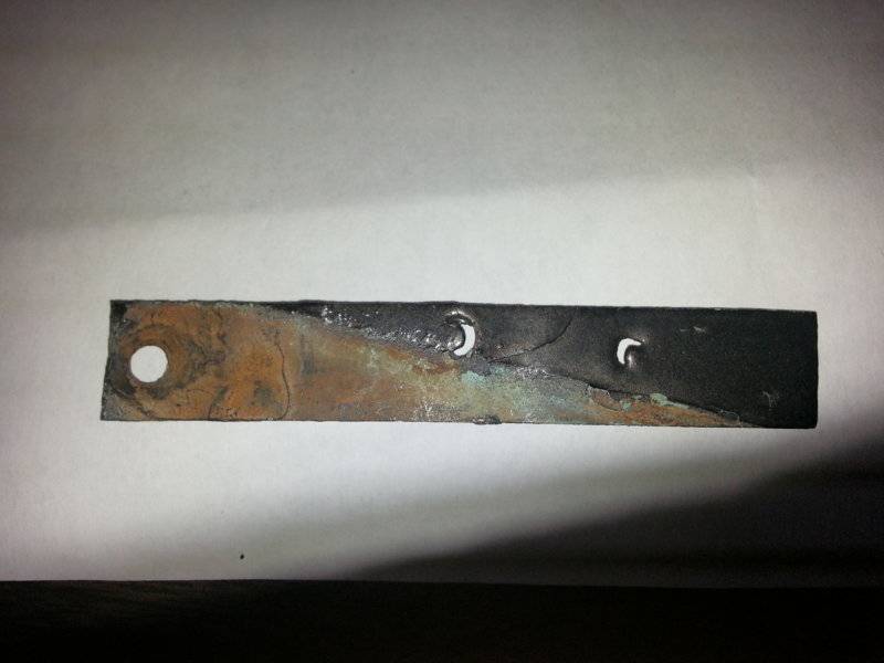

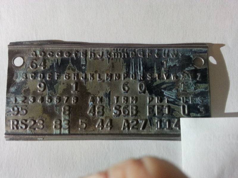

              My 68 LA plant GTX has no inspection stamp but it had a small metal strip with 2 stamps punched in it. Someday it'll get that EE1 paint back on her. Someone shot her black in the 80's. Ugg.
