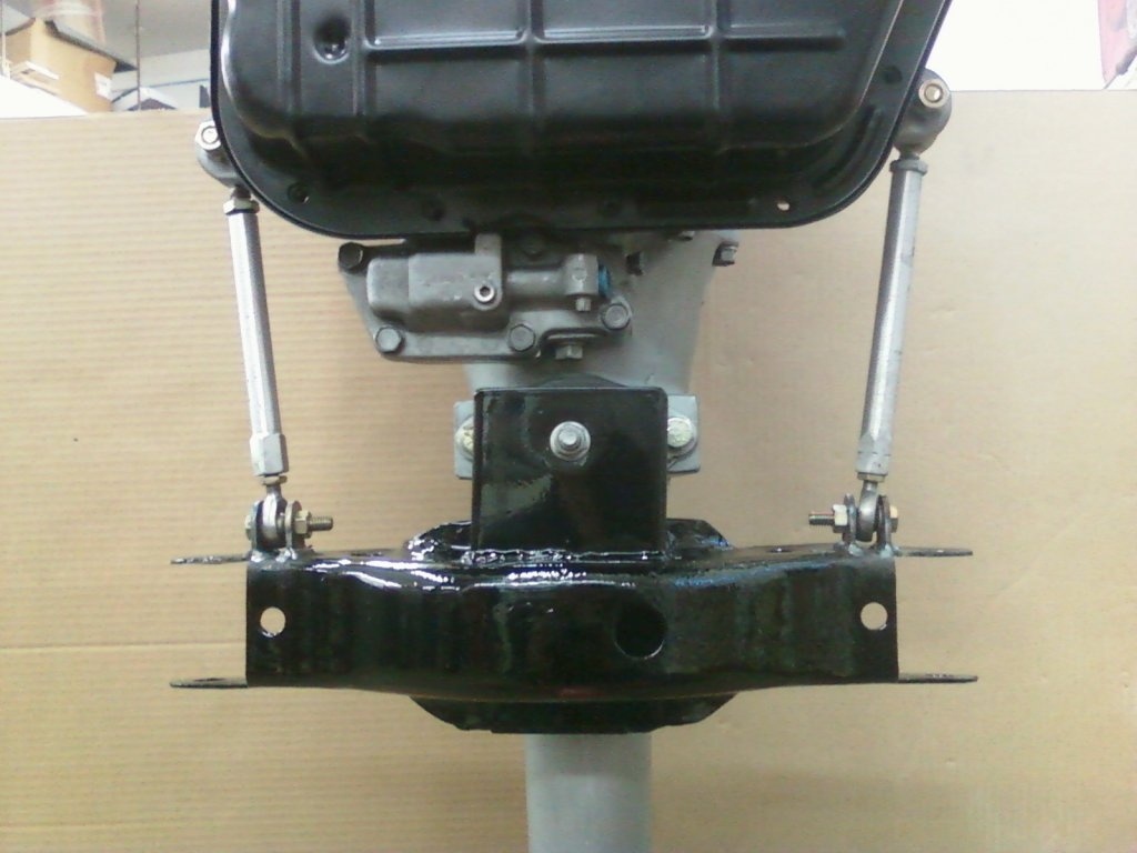

If you are running a push button. A S10 mount on welded piece of angle cut 2x3 square tube works. Cheap and quick. Readily avaliable as well.

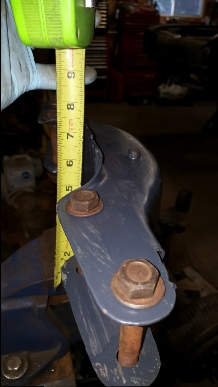

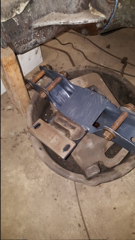

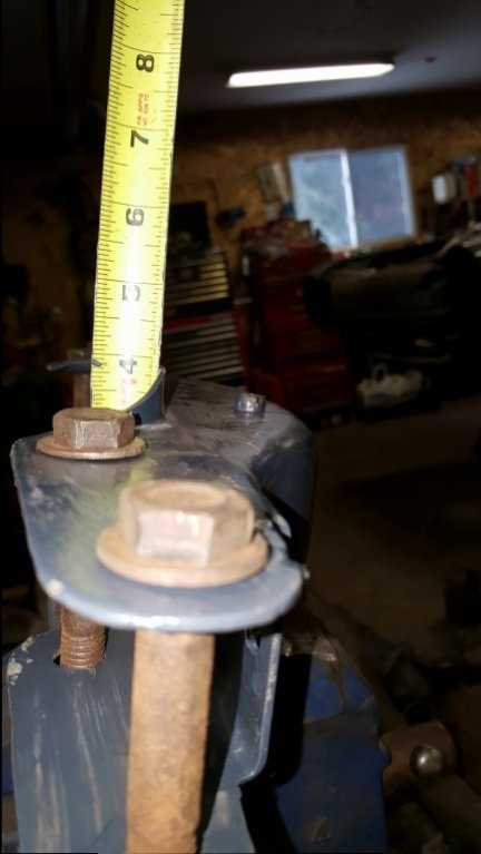

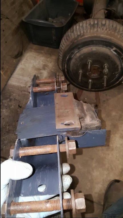

Thanks for the suggestions. 180 spin of the mount won't work cleanly.
It moves the mount back 3" instead of 1.75" as needed. Not far off but some mods are needed.
1.75" measurement was one of the other reasons I stayed with my stock k-frame, since as you know the later ones move everything back. And why I only needed 1/2".

Having a hard time visualizing this setup. Does the S10 mount bolt up to the pushbutton 727 without mods?

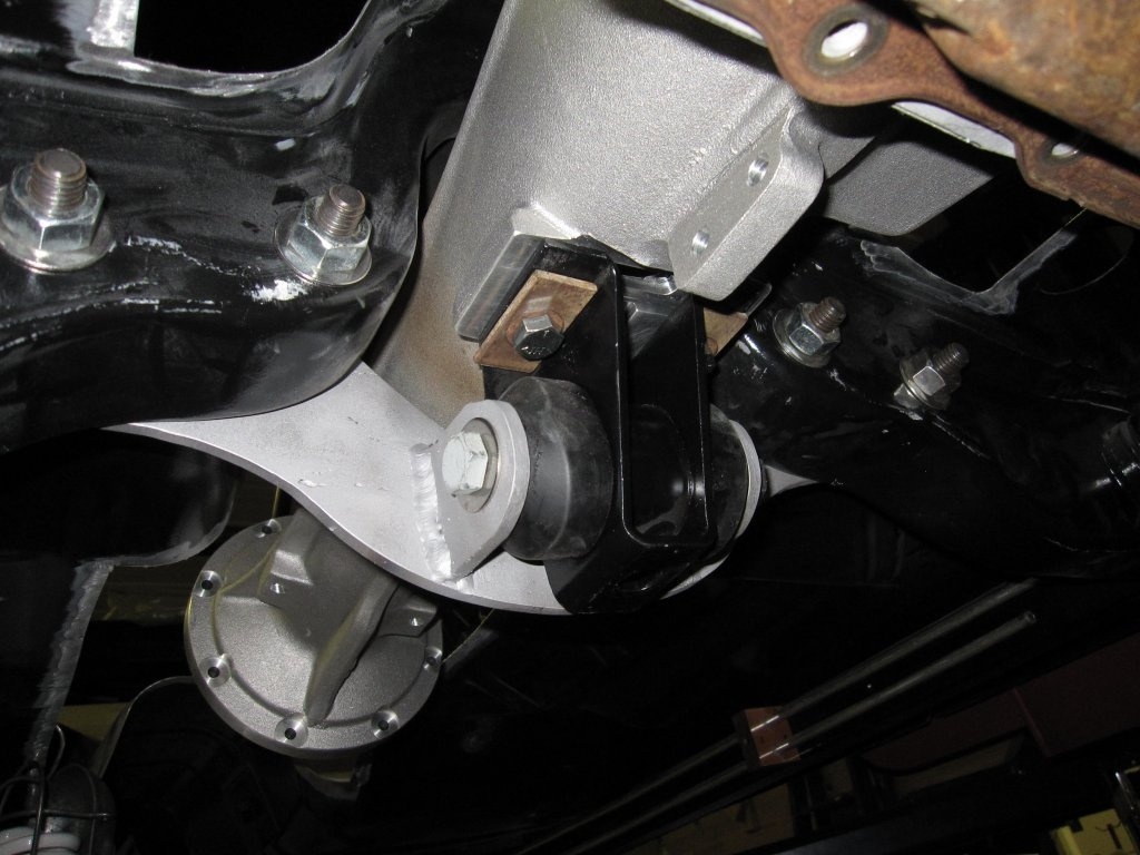

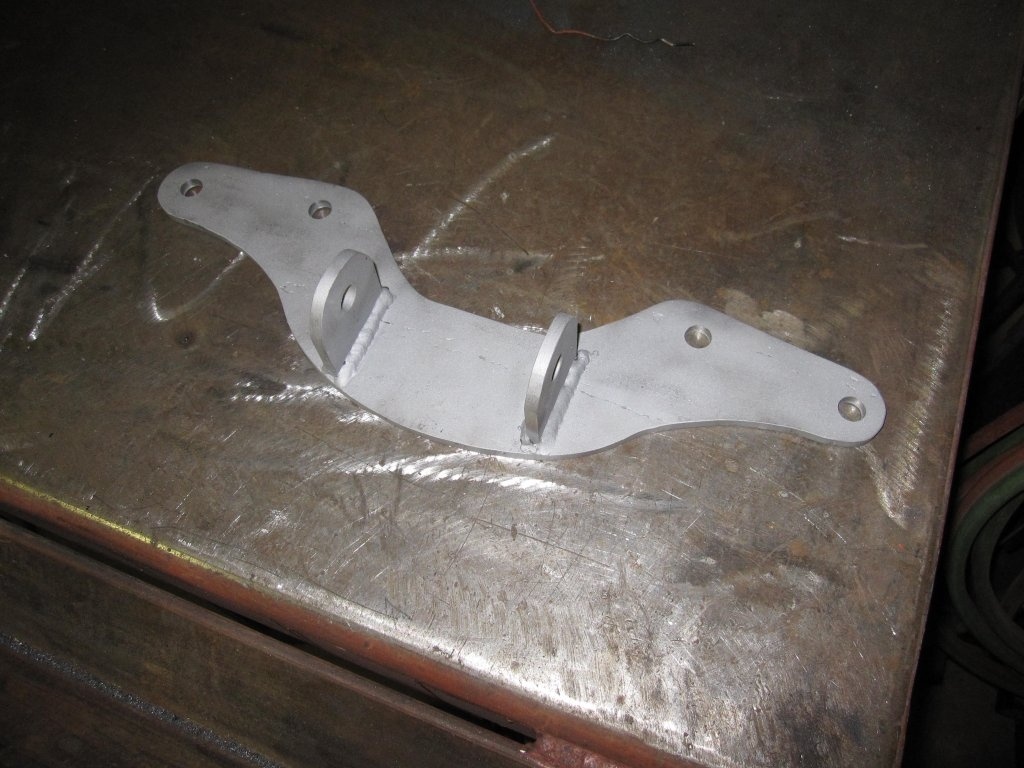

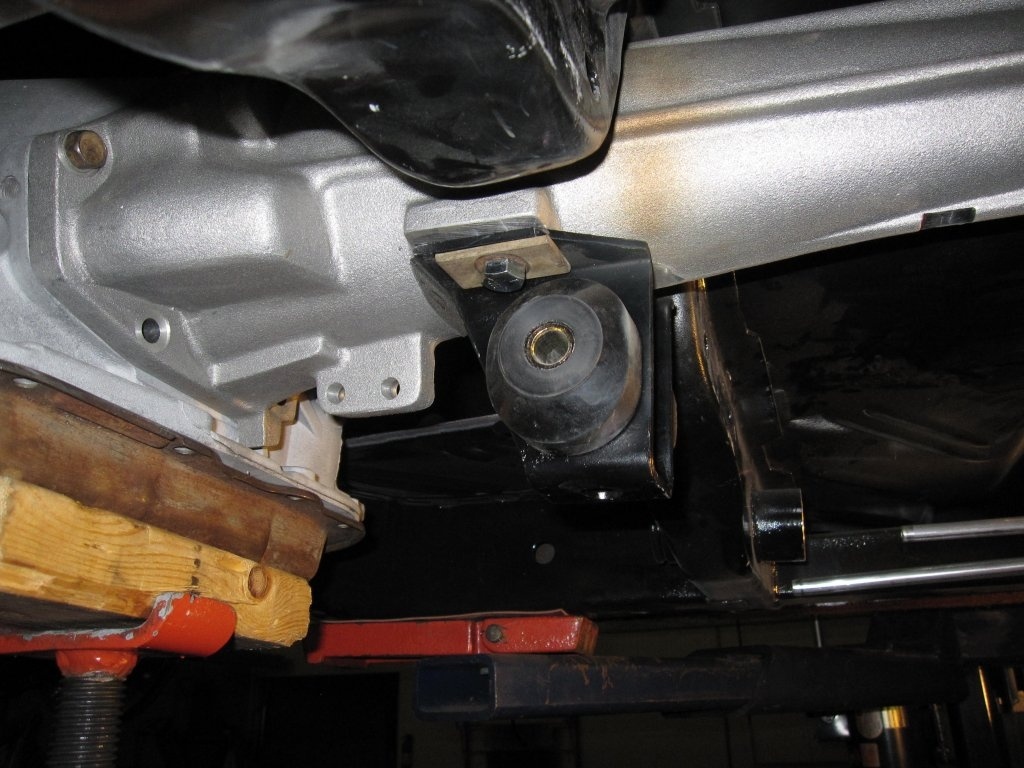

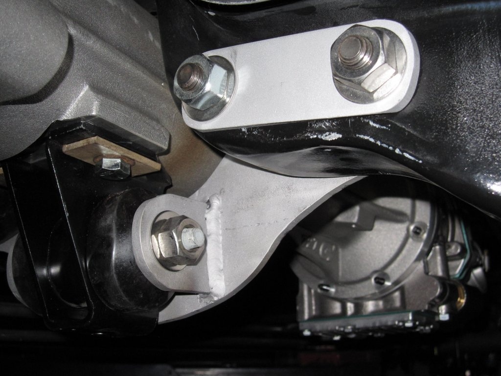

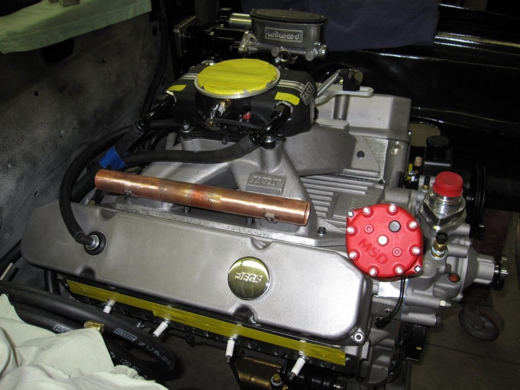

I installed a Alterkation front suspension and welded the engine brackets to the K member (long story) so I was able to max out the reward setback. Had to cut the tunnel out and further back (GV OD clearance). I fabbed a new cross member and used the later OEM spool type mount. I already showed this to Doug but, I don't think anyone else has seen my setup.
Mike
Mike
View attachment 391425 View attachment 391426 View attachment 391427 View attachment 391428 View attachment 391429
Looks like a slick setup Mike, thanks for the pics.
Check your measurements again ! It Worked Perfect for me and very Easy 180 Degree turn and welded on a small peace then Re Drilled !!
