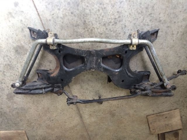

I saw a 68 k-frame with a sway bar for sale locally and was thinking about the swap.

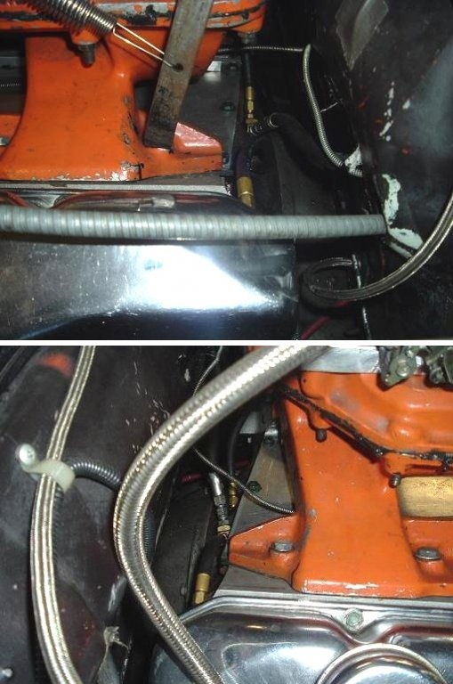

I've got two old pictures from when I first bought my car. If/when I can get back to the shop I'll try to take some better ones.
As it sets today I can tell you the TTI headers fit with no dinging. I can get to each plug. I had to "modify" the pinch seam on the transmission tunnel to allow for my transmission blanket. I probably didn't have to but I ended up drilling holes in the floor pan/firewall tunnel area for easy access to the top transmission bolts from inside the car. Since I bought it that way I can't speak for sure but I'm pretty sure you have to do something with the transmission mount. Someone here will know.

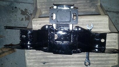

I am running a later model 727. Here's mine but I have no idea exactly which mount it is. I do know it's been modified.

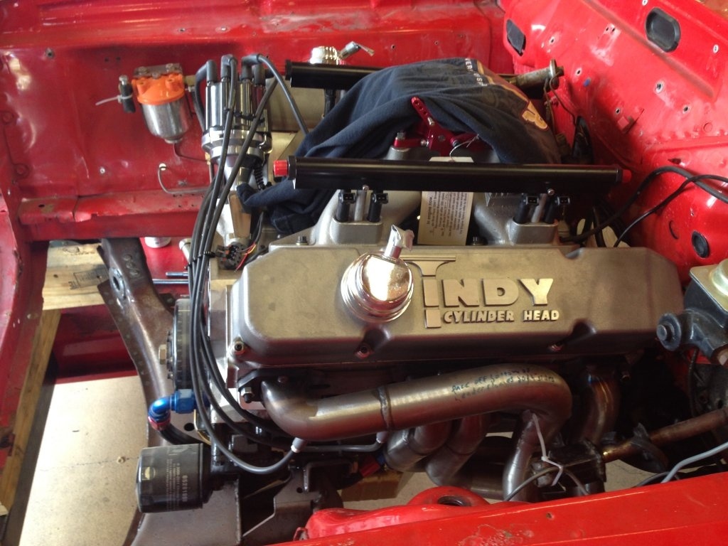

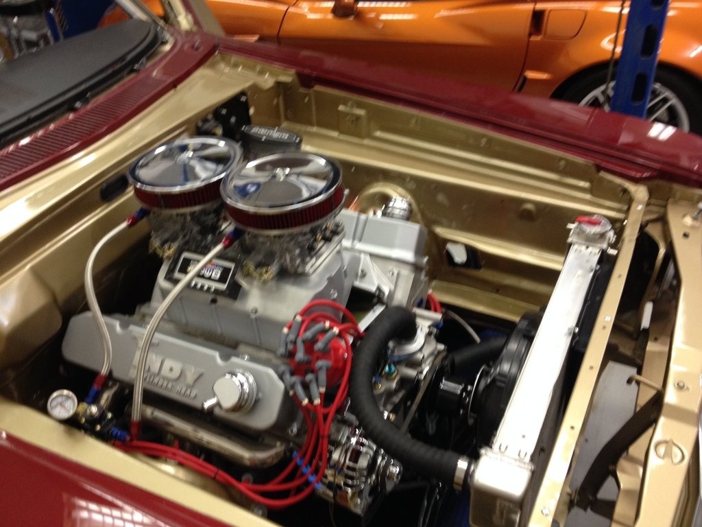

I'm using a 70 unit in mine. Clearance is a little close in some areas like above the trans servos that may require some floor thumping. My issues for clearance were mostly due to me using a Gear Vendors unit. You may need to re-route any hvac stuff on the firewall depending on what you have going on. My car is an a/c one so the expansion valve and plumbing are in the way. I'm re-routing said plumbing through the rh bulkhead between the inner and outer fender. I'm upgrading to Restomod's system since the old one is huge and needs repairs.

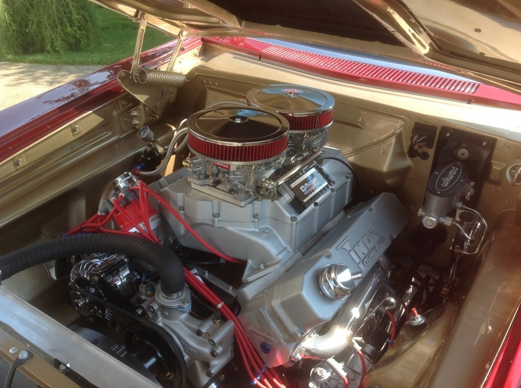

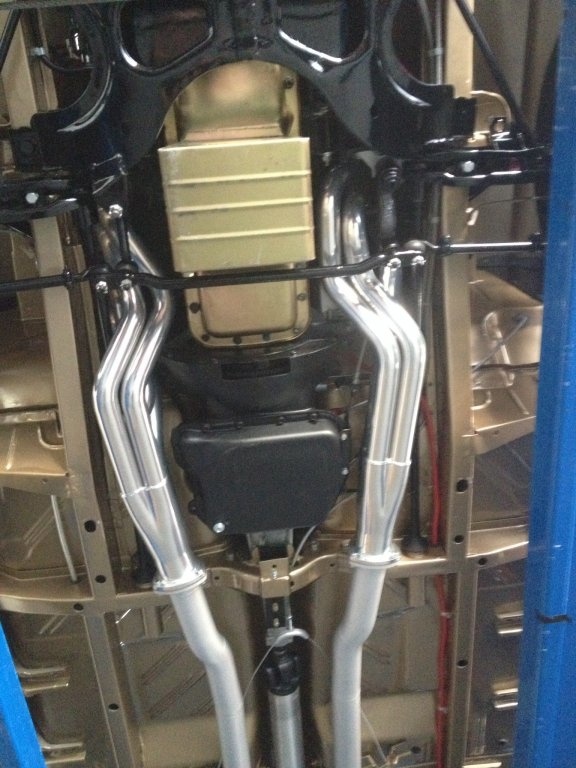

Here's a few shots of my 64 with a '69 K Frame. The right side valve cover starts to get close to the firewall but still adequate clearance to remove / install. There is lots of room in the steering box area. You'll have to modify the cross member but that's simple. With the newer K Frame there's no more issue of oil pan to K Frame clearance on the right front corner.
That's awesome, thanks Malex! Are the steering linkage and headers, etc., for a 69?
Yes Sir. You would use headers for the 68 in your case. My headers are the TTI. 440-25's. The newer K frames also have an improved idler arm from the 64 I am told.

You will need different mounts for the 66- k's. The 66- units use a double shear mount on the idler arm, unlike the single bayonet bolt on the -65's. I'm using the 70 unit as it has the sway bar passing through the k as opposed to in front of it. On my car, the header clearance was not an issue even with the Indy motor and having to use Schumacher mounts as the block uses Hemi style mount bosses. Tons of clearance to the body, suspension, steering etc. The only thing the pipes got close to are the block main cap cross bolts and a couple of other engine related items. I got them uncoated just for that reason.
