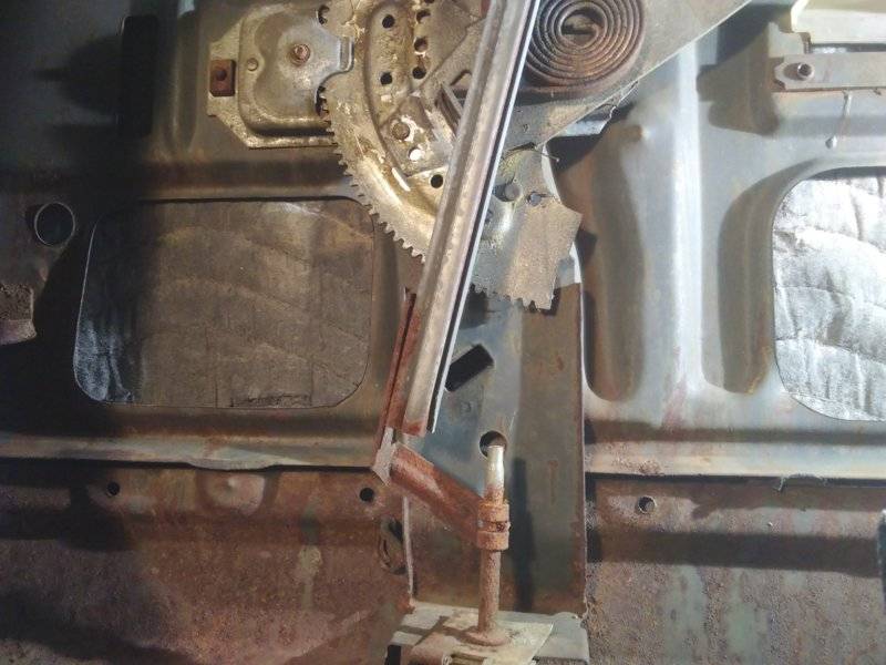

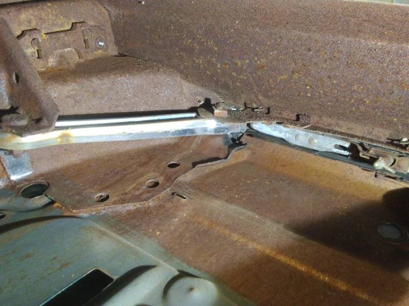

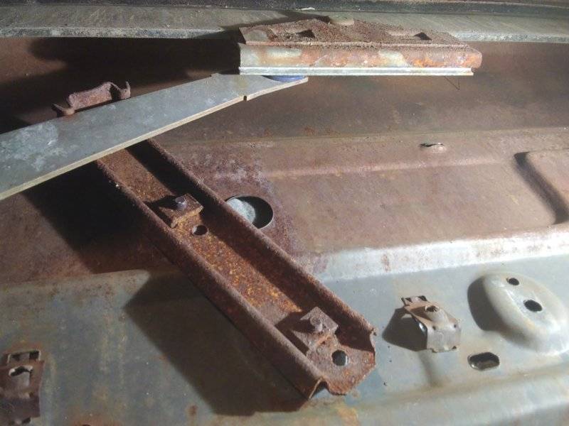

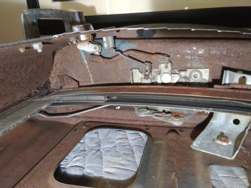

I've got a 68 coronet 2 dr i've been working on. My original drivers side door was badly cancered. And i wanted to save all the guts to put in another shell. Since this shell was trash, i cut a hole in the face, to expose the guts. This will allow me to get a better image of how everything goes inplace as i reinstall them, rather than trying to peek from the inside holes. Thought i'd post these pics to help anyone in need of reference.

This is excellent. I wish I would have had these pictures a year ago. I did go look at a buddy's door but its hard to view some of that stuff.
